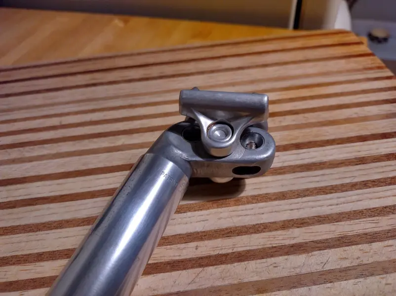

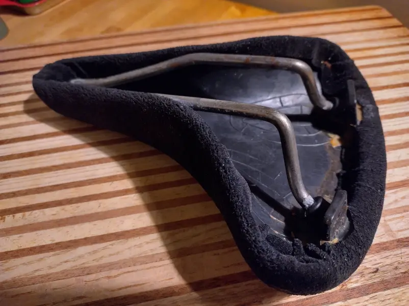

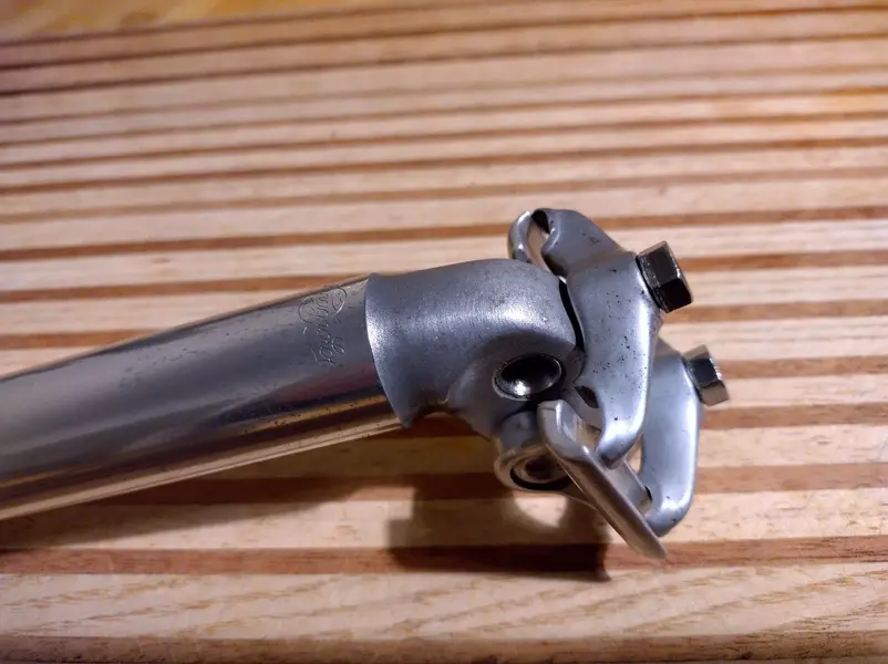

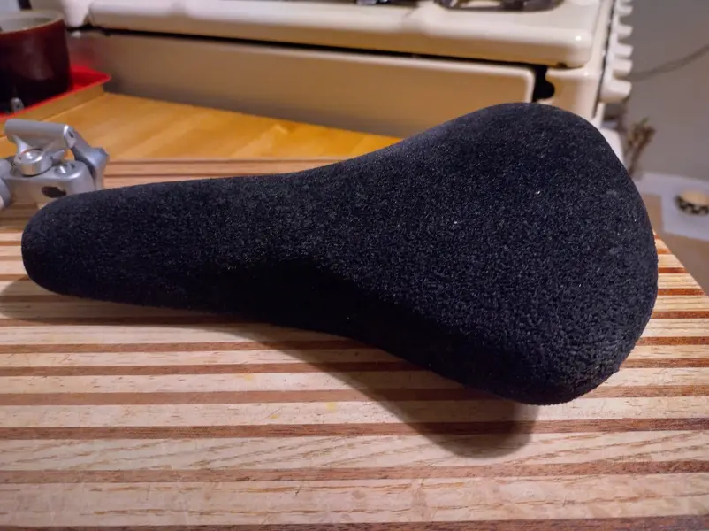

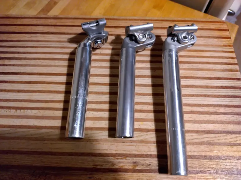

The stock faux suede Raleigh saddle scrubbed up well with warm soapy water, with its 180mm wide flexible base it was chosen for extra comfort 💺 The Campagnolo Record seat post polished up using various grades wet & dry paper finishing with a Solvo buff to a bright satin factory finish. The seat post has been cut down to 140mm (same size as Campagnolo Pista seat posts) to prevent it being inserted too far and damaging the seat tube as it makes the transition from round to Ovoid. The alloy side plates, narrow top clamps and lighened barrel nuts are the same as 1st generation Super Record...👌

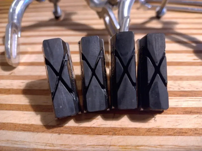

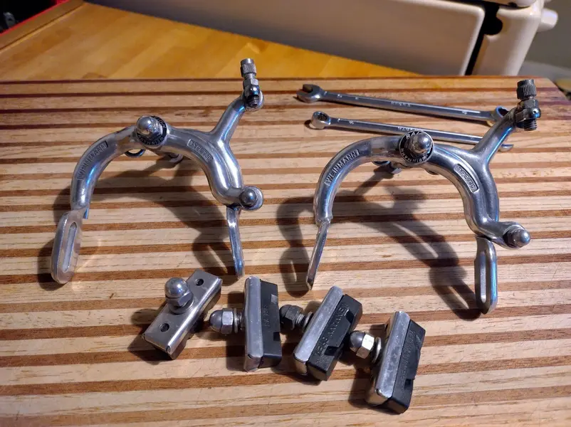

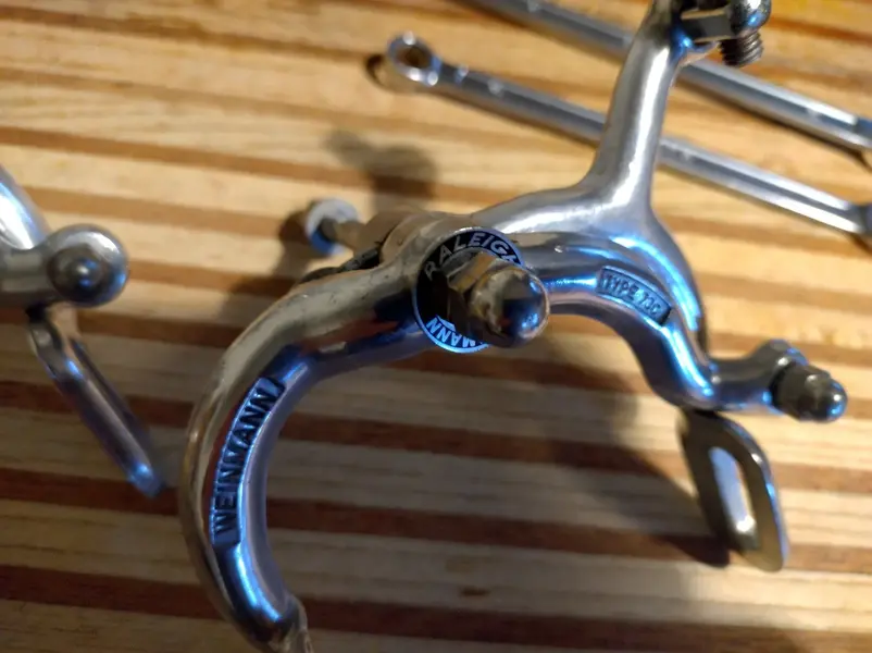

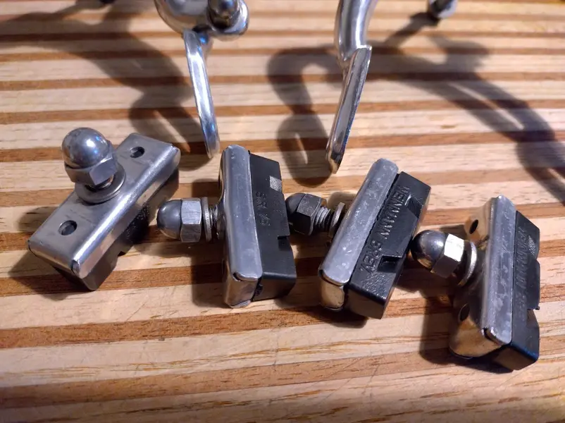

Stopping power on the Dynaflite is provided by the awesome Weinmann Type 730's specially designed to make you ride faster... because you can't f**king stop.😂 Anyway they're super light at 250g the pair so no wonder the 500 versions were the time trial brake of choice back in the seventies. Gave everything a soak n scrub in boiling water with detergent powder then a buff with Solvo. The caliper and brake pad dome nuts are all alloy, the brake pads looking like they've only kissed the rims a couple of times.. 😘
