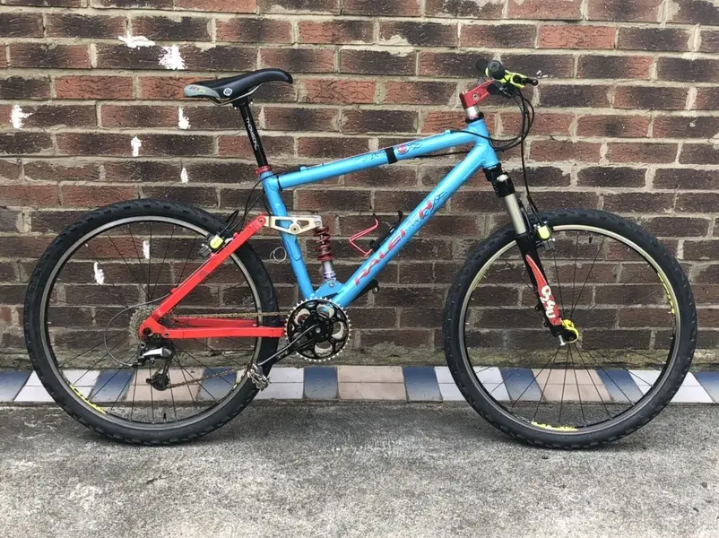

A Raleigh RSP 400 with full suspension
Bought the bike as was being sold as a pub bike - totally mismatched and thought it deserved some TLC
Been riding this for a while even though it isn’t finished
Really enjoying it
Need to change the headset for a red Chris King
Need some XLite spacers for the steerer
Needs a new front mech - looking for an M950
Gil has the decals ready to print
Everything else just feels and rides great!
Raleigh RSP 400 Proline MTrax
Rear shock - Rockshox Deluxe
Forks - Magura Rond o24u
Brakes - Magura Raceline
Shifters - XTR M950
Rear Mech - XTR M950
Front Mech - XTR M950 (to be fitted)
Crankset - Roox Specialites TA
Handlebars - XLite XC Riser
Stem - XLite Fly
Headset - FSA Orbit Extreme (to change to Chris King In anodised red)
Wheels - Mavic Crossride
Seatpost - Thomson
Saddle - WTB SST98

A question - what options are there for replacing the rear shock ?
Did Magura make a rear shock in 1998-2000?
Duxuk
All you need to know about the shock is the length and travel. Air shocks are easy to set up for any bike and rider combination. If historical accuracy matters then it’s not so easy. My 1997 Marin Riftzone had a coil shock where you can’t change the spring rate without finding an appropriate spring.

Thanks for that - I’ll have a look to see what’s out there
Historical accuracy isn’t too important but I do like to keep the components (in general) within +\- 4 years or so - this bike is 1999 I believe.

Bet you could get a little RP23 to go on there and make it pedal better.
That sounds like an idea
What’s the earliest model they made?

Just measure eye to eye on the shock and get the right size, they made loads of sizes so I bet there's one to fit. The fame doesnt look to have any funny geometry requirements so I bet it'd go straight on.
