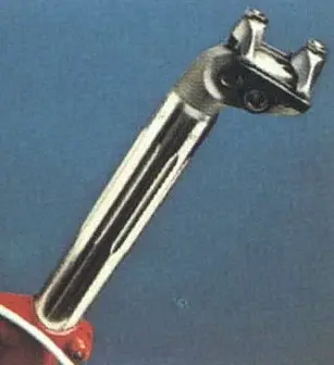

A prototype is very likely, I just never heard about this particular item. The seatpost on the poster appears to have the better known black seat cradle clamp bars that never made it to the production phase either.

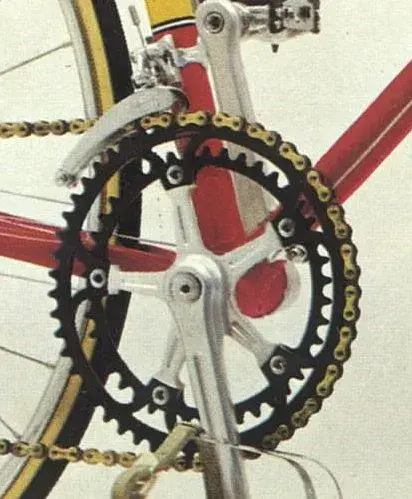

I read that Campagnolo first thought about more black parts for the Super Record than just the rear derailleur. Black seatpost cradles, black chainrings and a black titanium headset. A 1974 Raleigh brochure shows the black rings, a black headset that has a clearly different shape than the Nuovo Record and final Super Record and black seatpost cradles (but oddly not the cradle clamp bars as shown in the poster)
BTW the front derailleur on the Raleigh is an ordinary Nuovo Record.
