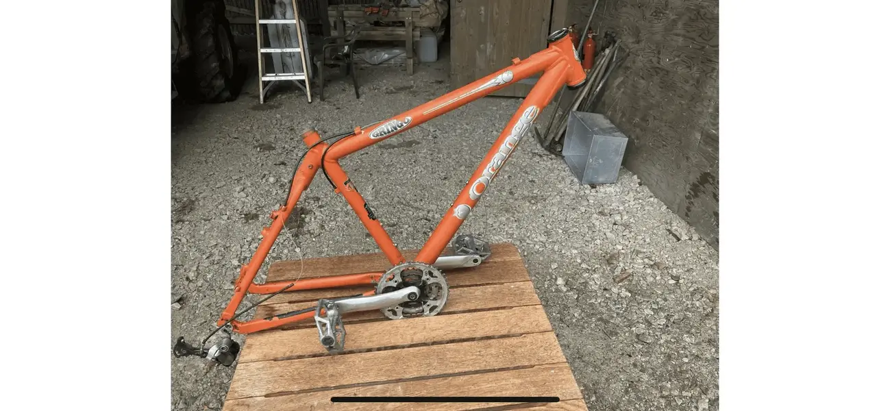

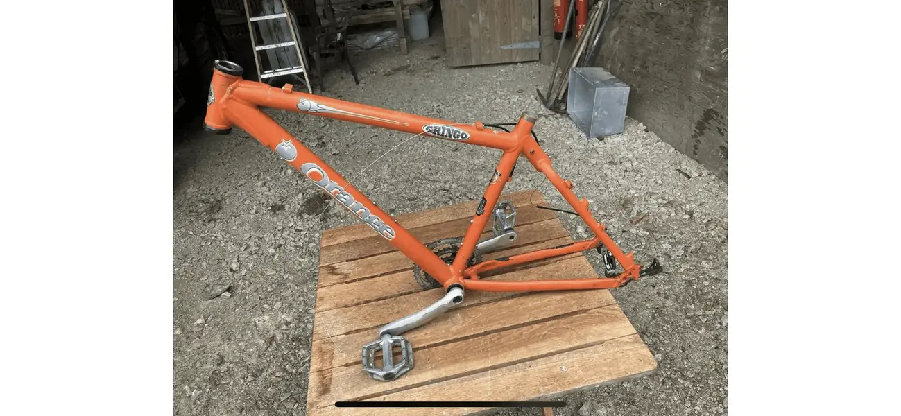

In the interests of trying to keep fit this winter I decided that I should build a winter proof bike. It needed to be alloy, disc ready and very cheap. I have some Hope wheels in 27.5 and some 27.5 100mm travel forks so a 27.5 frame was probably best. I found an Orange Gringo on eBay, locally, cheap and advertised as 27.5. So £40 later I have this,
One of the decals has a number 12 on it, not sure what that signifies but it has V brake mounts so I suspect it isn’t the year 2012. I’m thinking it’s probably late ‘90 s early ‘00 s and for 26” wheels.
Can anyone shed any light on this?
What year, 26” wheels, and what travel fork would be best?
I’m beginning to think that what I’ve done is instead of a quick build for winter, I’ve just got another project. Seems Orange will refresh your frame to as new for £200…….🧐
It is a 26" wheel frame - but I have had 700c disc wheels on mine, albeit with road treads on them.
It's a 2000 model I think - and probably came with an 80mm Manitou.
The "12" sticker refers to the "Gringo’s sturdy gussetedSeries 12 butted 7005 aluminium frame"
Thanks for that Carge, that’s very helpful. I haven’t had chance to have a look at it properly yet but from what I have seen it definitely looks sturdy.
You don’t know the seat post diameter do you?
27.2

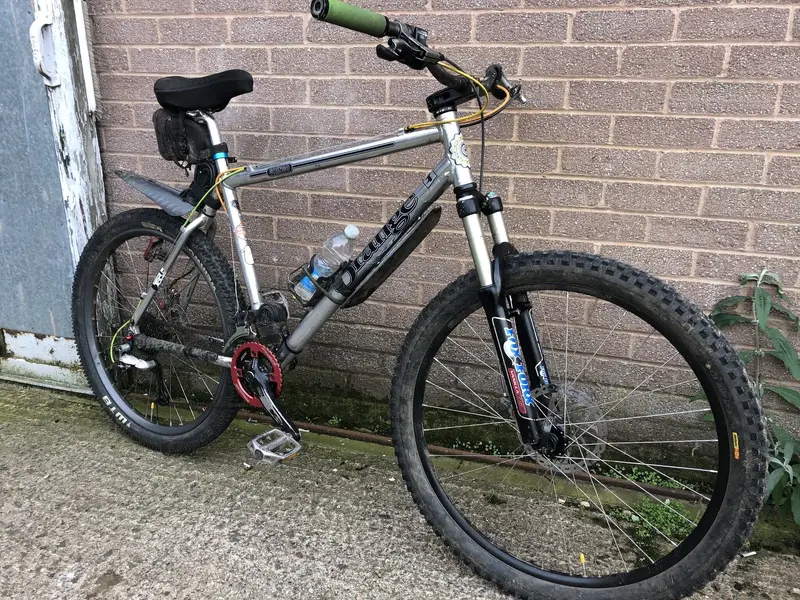

I've still got mine - very versatile. I ran mine as a commuter and towpath bike - as my commute took in the Kennet to avoid as much tarmac as poss :) I ran Michelin Wildgripper Sprints for ages - the file pattern ones.
And a rigid Pace RC31 fork.
That got swapped out when I stuck the 700c wheels on it - and now I think it has some plain Tange forks.
Run it with discs and v-brakes.
