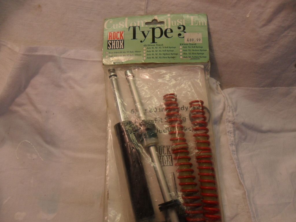

1. Complete NOS NIP Judy '97 Type 3 Spring and cartridge kit, 63mm (SL/ XC). I don't know the spring stiffness, other than it is the "red" one. I also don't know iftype 3 will retrofit into the earlier 95/96 Tpe 2 judy's. My feeling is, it will but if someone has any additional knowledge, that would be great!
Original RRP £90, for sale at £45. Sold to kikideparis for £45

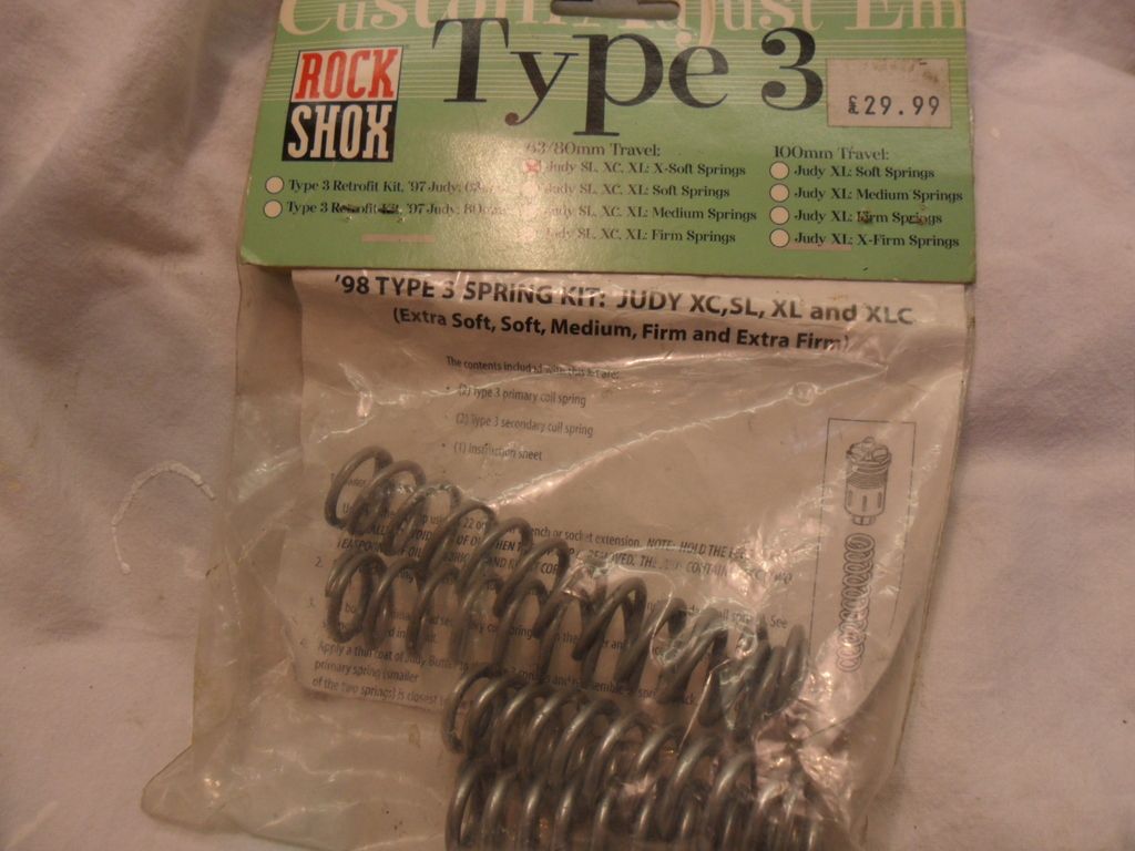

3. NOS NIP Mountain Speed Springs. Green, X-soft 135lb spring. Fits judy, Quadra R, 3" manitou EFC, RST Mozo Pro 2.5 / 3.5 according to the box.
RRP £40, Sell at £20. Sold to theone for £20

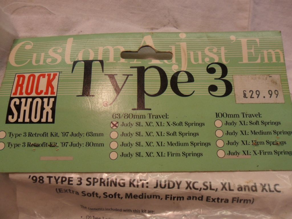

4. NIP NOS Judy type 3 soft spring kit (Judy XL, XC, SL), 63 and 80mm travel.
RRP. £30, sell at £15 STILL FOR SALE
5. 2 x beigh Rockshox DH elastomers (Hard) and one green soft speed spring. Used. £5 / lot Sold to worldranger for £5

Ok dimensions for everyone's benefit.
#3
Dimensions assumed as per #5. These springs are in the box (and although it looks like they've been opened before, they're sealed again and I'm not opening them.
#4
Spring A Dia 19.8, length 93
Spring B Dia 19, Length 68
#5 Speed Spring
Length 170. Dia 21.5, tapering to 20.3 at one end to go in an early judy topcap. I'm ASSUMING #3 measures the same. Looks like it from a ruler outside the box.
#6 Spyder springs, Dia 20.5, Length 51.5
Wings spring Dia 20, Length 125
