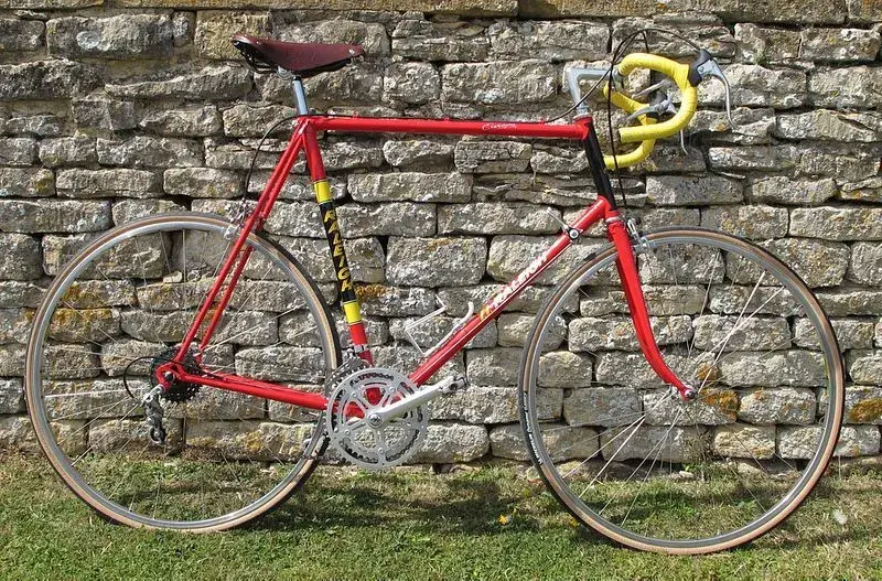

I don't know if your £1500 anniversary comment was tongue in cheek, but to be clear, these are 2 very different beasts. One is as good as steel gets, one is a gas pipe budget bike, albeit both are painted to team colours
