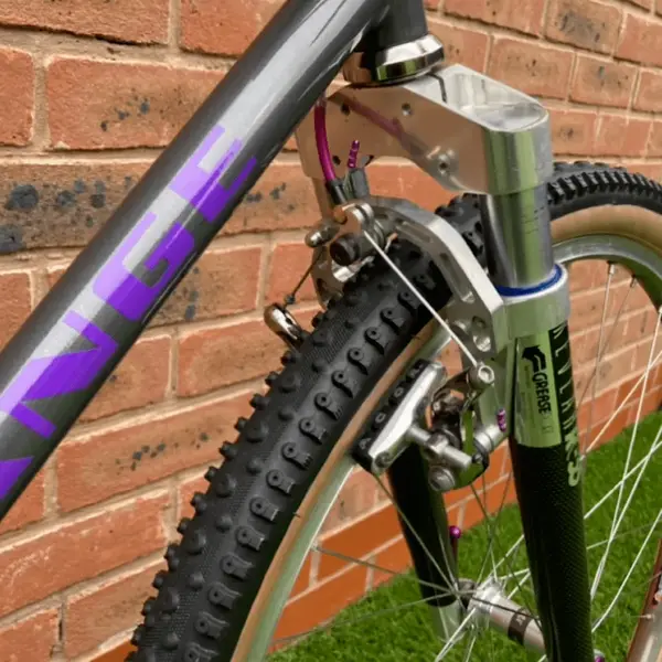

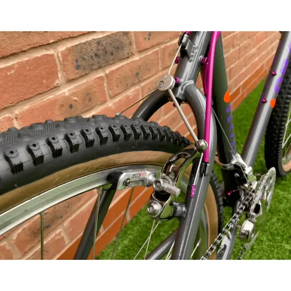

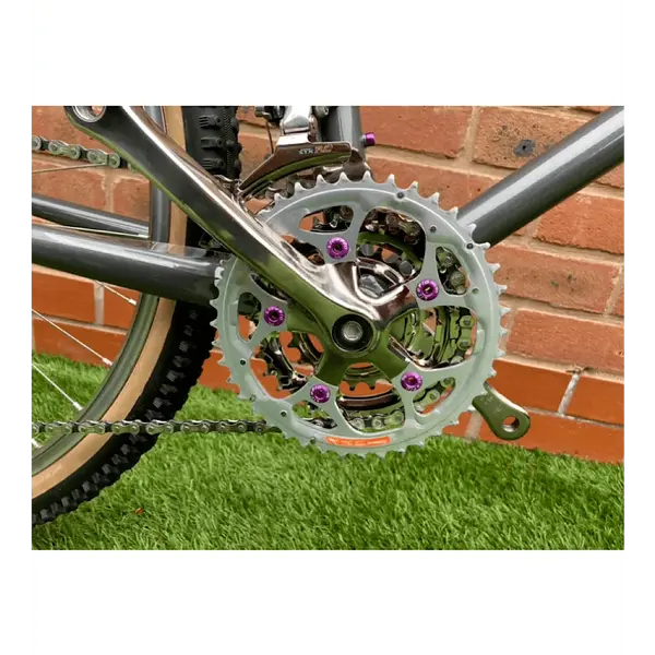

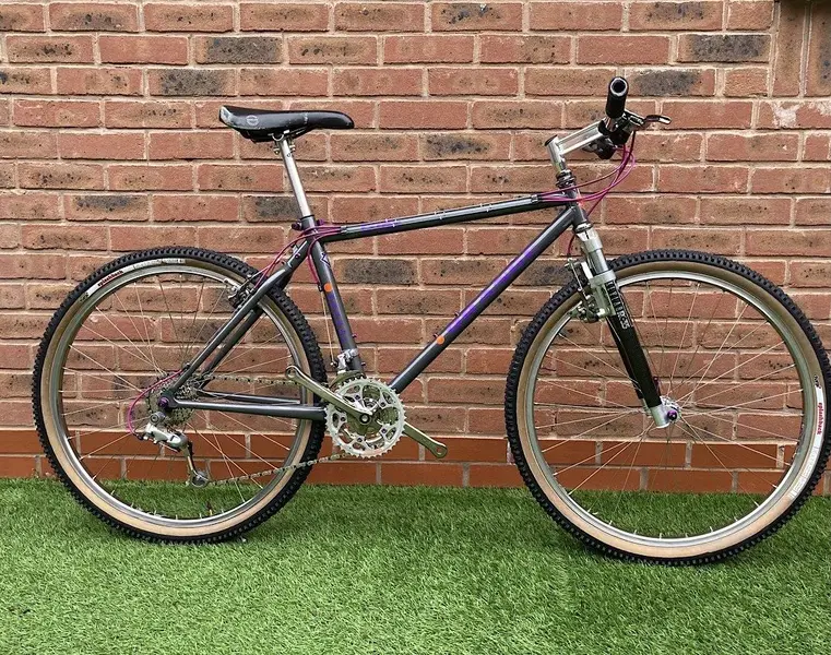

Here is the ‘95 C16r I’ve just finished building for my daughter. I still get excited when I finish a build......
She took it on a test ride and while it rode well she has said she’d like the handle bars a bit higher so I’ve got an Azonic riser bar I’ll fit (although I need some purple Jagwire outer cable if anyone has a bit spare?). I also need to play with the elastomers in the forks as I set them a bit too soft for her weight and she said the saddle is uncomfortable so I’ll have to find a lady friendly one that doesn’t look like a sofa. Other than that, really pleased how it came out.
Frame: 1995 Orange C16r 17” DNFIVE decals
Fork: Pace RC35 AB
Headset: Shimano MC30 STX 1”
Stem: Club Roost I-Beam (although may change back to original Stalk)
Handlebar: Orange Hot Rod (will be changing to Azonic riser)
Grips: ODI purple silicone
Barends: N/A
Brakes: Shimano MC33 STX Cantis
Brake Pads: ACOR Cartridge
Brake Cables: Jagwire
Cantilever cable hangers: Shimano/Pace
Brake Levers: Shimano MC33 STX RC
Shifters: Shimano MC33 STX RC 7 Speed
Front Derailleur: Shimano MC33 STX RC
Rear Derailleur: Shimano MC33 STX RC 7 Speed
Derailleur Cables: Jagwire
Cassette: Shimano HG41 7 Speed
Chain: Shimano IG51
Cranks: Shimano MC33 STX RC
Crank Bolts: Shimano
Chainrings: Shimano MC33 STX RC
Chainring bolts: Litepro
Bottom Bracket: Shimano UN26
Pedals: DMR V6
Hub Skewers: RSP
Rims: FIR
Hubs: Shimano MC33 STX RC
Nipples: Alloy
Spokes: DT
Tyres: Charge Splashback 26 x 1.8
Tubes: Halfords Presta
Saddle: Orange (due to be changed for a lady specific saddle)
Seatpost: USE
Seatpost Binder: Purple eBay special
Weight: good question, I need to get it on the scales.
