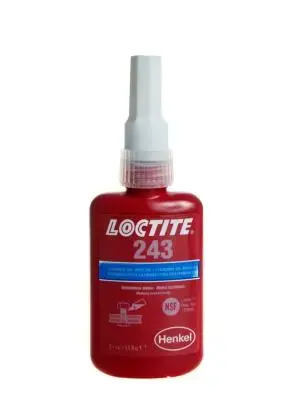

I had an interesting mechanical failure today. Seems the bolts on my rear brake rotor had been gradually working loose and had fallen out one by one. I was cycling up a steep hill and suddenly heard a clatter and grinding noise as the last bolt dropped out and the rotor detached completely from the hub. How I hadn’t noticed earlier is beyond me, the only symptom was the brake was starting to squeal a bit.
I had to cycle back with just a front brake as I only had 1 bolt and didn't have a T25 bit. Never happened to me before and a surprise as the bolts all had blue Loctite and I'd used a torque wrench.
More regular mechanical checks required I think 😳 and maybe an excuse to upgrade the crappy 160mm Avid rotors :)
