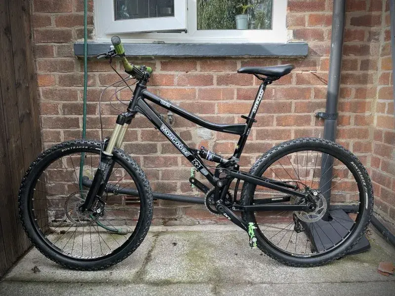

Meet Mildred my 2008 Mongoose Teocali Super. Mildred's been on the back burner for a while... as I concentrated on other projects, mainly my mate's Lava Dome.
With having to work outdoors, dark nights drawing in and less free time on my hands, Mildreds probably going to be my last project of the year.
I'd had my eye on Mildred for a over month where she'd resided in my gumtree "favourites" manky, and in need of some TLC.
Often people don't remove their ads from gumtree after their listing is sold so I was somewhat surprised she was still up for grabs after I enquired.... is it still for sale?
As you can see from the pictures and minimal wording in the ad, there were issues... "front brake and gears need attention" obviously, there was another matter of it being filthy and sporting a smatter of mismatched components. Despite this, I could see potential in the bike. An almost complete XT groupset, Rock Shox Sektor RL forks with bar-mounted lockout, Fox RP23 rear shock, FLN stem, and Ragley Bars.
Viewing was arranged ... a short test ride revealed the front brake was binding and the gears had a mind of their own. A deal was struck taking these issues and the general state of the bike into account.
Simon the owner, a middle-aged chap, had totally lost interest and basically just wanted rid which went some way to explain why he hadn't even cleaned it before putting it up for sale.
There isn't much online info about the 2008 Teocali, certainly no mention of issues that apparently afflicted the earlier frames but as this was to be my first alloy framed bike I was mindful of potential issues of cracks in the frame, etc. I needn't have worried as the frame is fine ... if it turned out to be "goosed" (see what I did there?) I could have recouped what I paid splitting it for parts.
All images are taken from the ad...
With Mildred back at headquarters, assessment could continue. It was obvious beneath the grime, Mildred had lead quite an easy life ... The lifestyle she had been acustomed too, she'll continue to receive in my hands. Yes, there was the odd bump and graze but no serious battle scars. The first priority was to sort the binding front brake which turned out to be nothing more serious than a badly fitted pad retaining clip ... As usual, the guys on Retro bike offered up a solution... a quick fix and we have a front brake...but the gears are still dodgy... time for a 1x10 maybe?

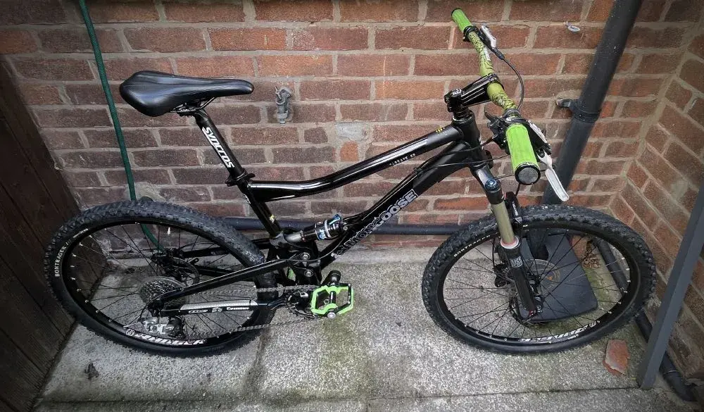

so after stripping and trying to set up the gears, they still wouldnt play ball. I had a cunning plan... a one-by-nine conversion.
just prior to removing the front mech and replacing the chain set and seat...
New cranks and pedals ... weigh about the same as the three ring XT cranks/chain rings. The new pedals are lighter than the pedals which came on the bike... sealed bearings too. feel good under foot... and add a bit of colour (and match the handlebars kind of)
All done ...

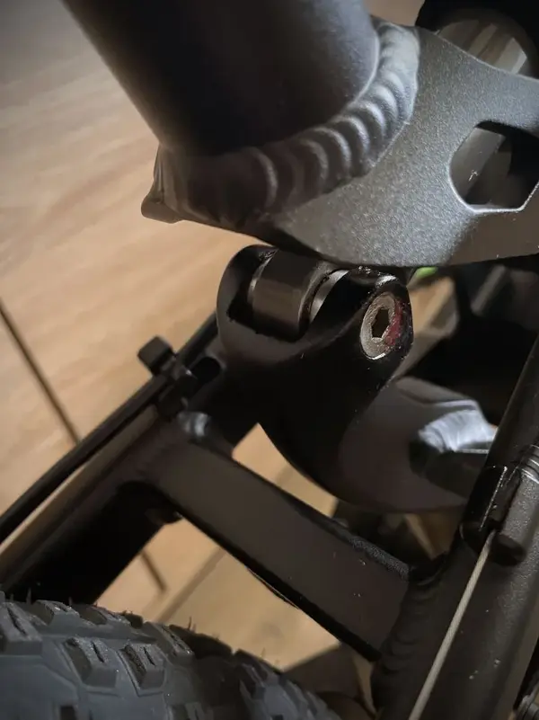

So last time I took Mildred out the rear shock decided to let go of its air. I limped back to base and left her for the winter.
Recently I picked up a shock pump and inflated the fox rp23 it seems to be retaining air. Ive not had a chance to ride yet but ill take the pump out with me next time... just in case. I've also replaced the lower fox mounting bush and securing bolt this appears to have cured the small amount of play from that area.

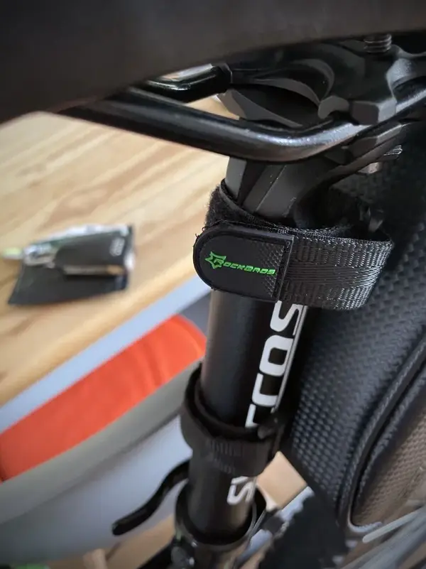

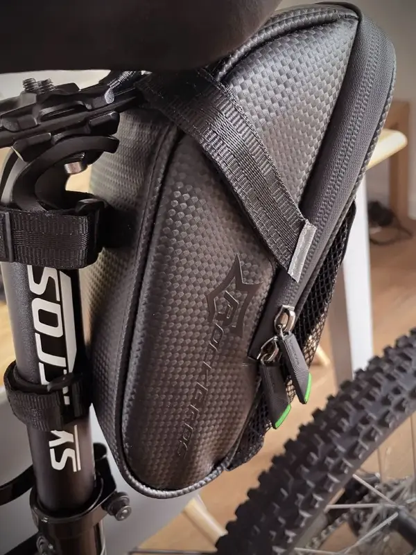

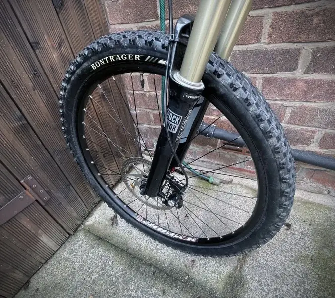

Also, you might notice the replacement wheels, tyres, and saddle bag.
