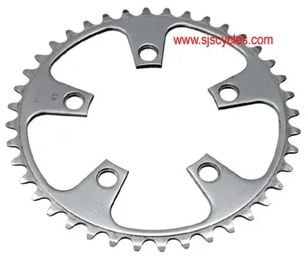

Tidying up an old hard drive, I found this picture I must have saved from the St John Street Cycles website.
So I shouldn't have been surprised to discover that Mavic had made 94mm pcd chainrings: I'd seen one already.

EDIT: Just reread your post and realised that the 38T at the top isn't yours, d'oh! I've amended my post accordingly!

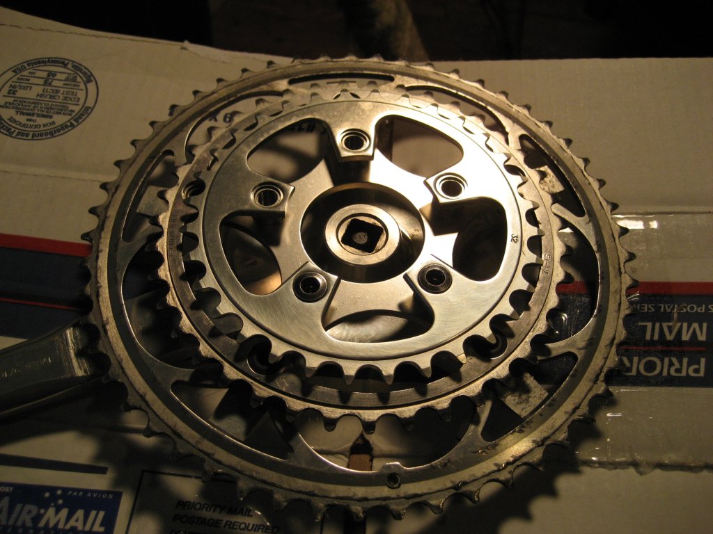

were these used on a 631 road chainset with the 'triple-izer' middle ring that converts from dual to triple:
I borrowed the picture, but I've got a couple of those rings somewhere too.
Yep, except that the Mavic triple-izer wasn't incorporated into the middle ring. It was a separate spider that replaces the spacers between the two outer rings.
http://velobase.com/ViewSingleComponent ... aa38991e6a
I still don't know why Mavic made their granny rings in such outlandish sizes. Tandem timing rings for use without a crossover drive?
Is also pretty much what I was going to put forward as a qualified guess.
