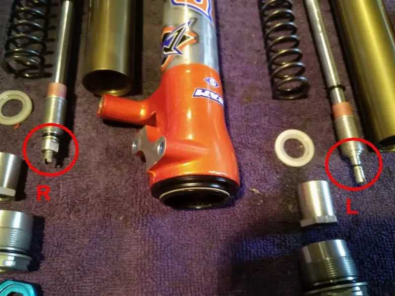

Unfortunately the left cartridge is broken in the top, I think someone rotates the knob with too much power :( :( :shock:

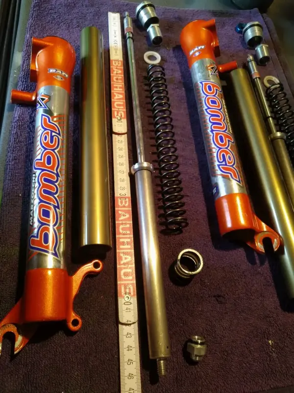

Cartridge length overall is about 46cm.

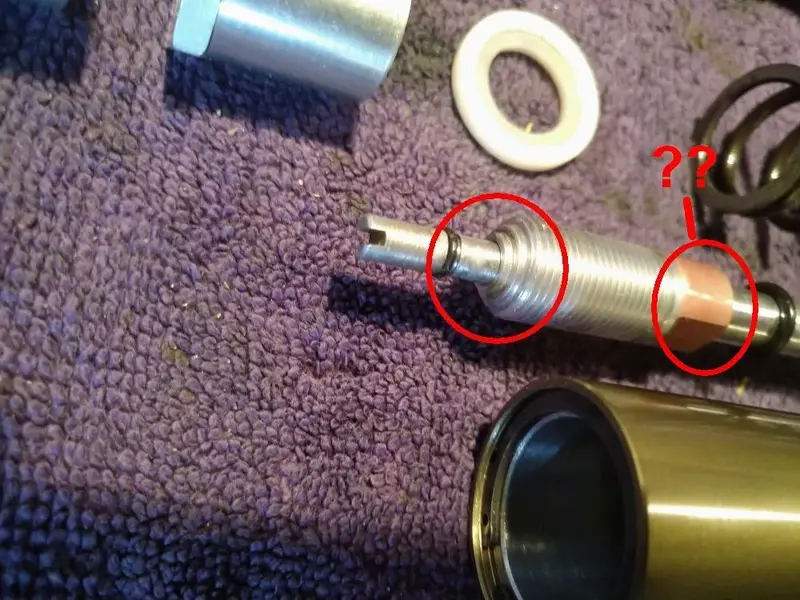

Have a look at the pictures, I'm wondering about the red part of the cartridge (marked with '??'). Is there a thread behind or is this a pressed location?

Look at the picture with the red eloxal nut - I was wondering about.
During inspecting I came to the conclusion that this muss be a nut, that this parts are not pressed and that this is a lock nut to fix the top unit screw.
But it was enormously tighten! I was sure, that it has been clued, so I heated it carefully. Also it is very difficult to fix this parts to sue some force on it.
So I used a bigger fixed vice with aluminium blocks and a little mobile vice to clamp and rotate the main tube against the head unit. Carefully moving it left, right, left, right and heating I was able to unscrew the red nut first a few threads, than I was able also to unscrew the head unit from the tube.

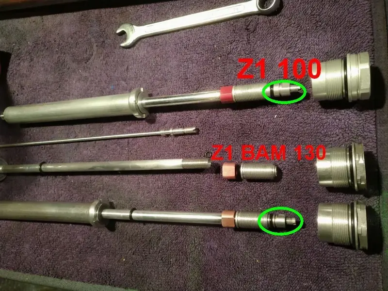

For the files: cartridge full lenghts:
Z1 100mm - 41cm
Z1 BAM 130mm - 46cm
So my solution for the BAM is to find another head unit. Lucky my I have another Z1 with 100mm travel byside. There are little differences:
- the Bam top screw is somehow optimized and does not have the height of the 'standard' Z1
- the little unit with the o-ring on top is height - please compare the units on the picture, you will see.
