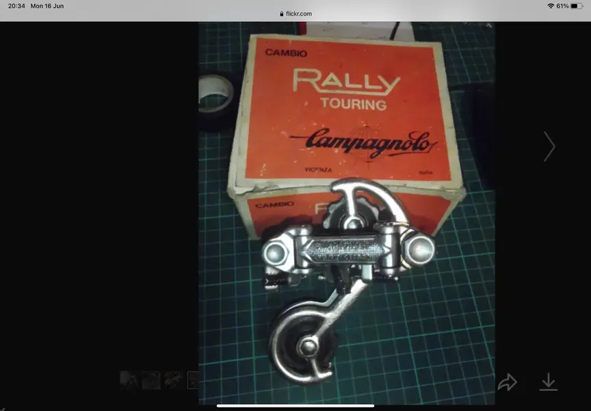

One small thing that’s often a bit misrepresented - the second version Rally’s are essentially long cage Gran Sports; they have the cruder G.S. parts rather than the more refined N.R. castings.
…and to confuse things further, in 1984 Campag ran out of the “RALLY” front plates for a while so released some with with N.R. ones!
