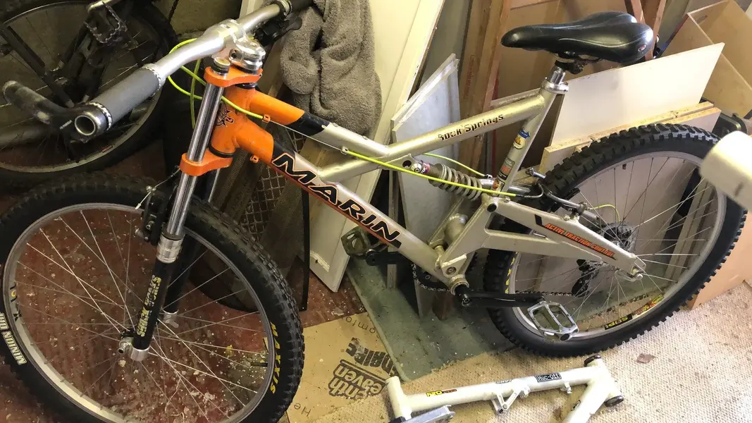

1) I have a 2000 Marin Rock Springs and the odd “Shock Works” front fork has locked. You can’t really get spares and it’s quite heavy, so It needs replacement.
I want/need to stick with 26” and vee brakes as I’ve spent money on new bits. I think it’s 120mm travel and orange would fit the colourway. The length needs to be roughly 66cm in total
What fork options do I have? I could just stick on something new and cheap? Maybe even manage something cheap by Rockshox, but 120mm travel and brake bosses seems to be the problem.
The alternative original OE was Manitou SX LT (long travel), which I cant source and most would need rebuilding or look tired for £50-£60.
Any suggestions what I should get and anyone got anything they’ve seen for sale?
Budget is around £50-£100

Pic to keep you interested:
Shimano techdocs have decnet exploded views so there should be no problems with the hub. Cones go in first, then spacers, then the lockrings with serrated sides facing outwards.
Something like this for the front end?
Thanks. I’m going for the ebay ones already… they seem more “complete” in any case.
Think you’re right about the boxxers the bike was £100 before my modest additions
