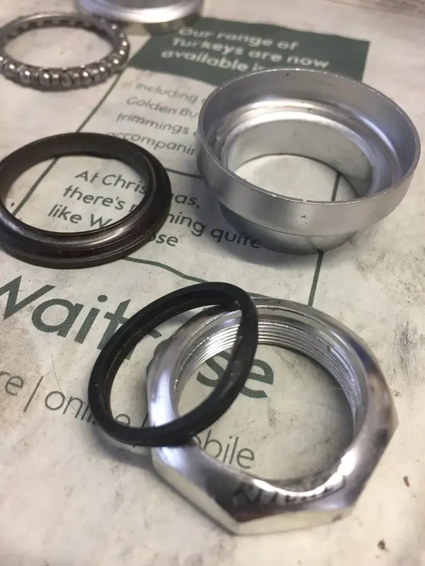

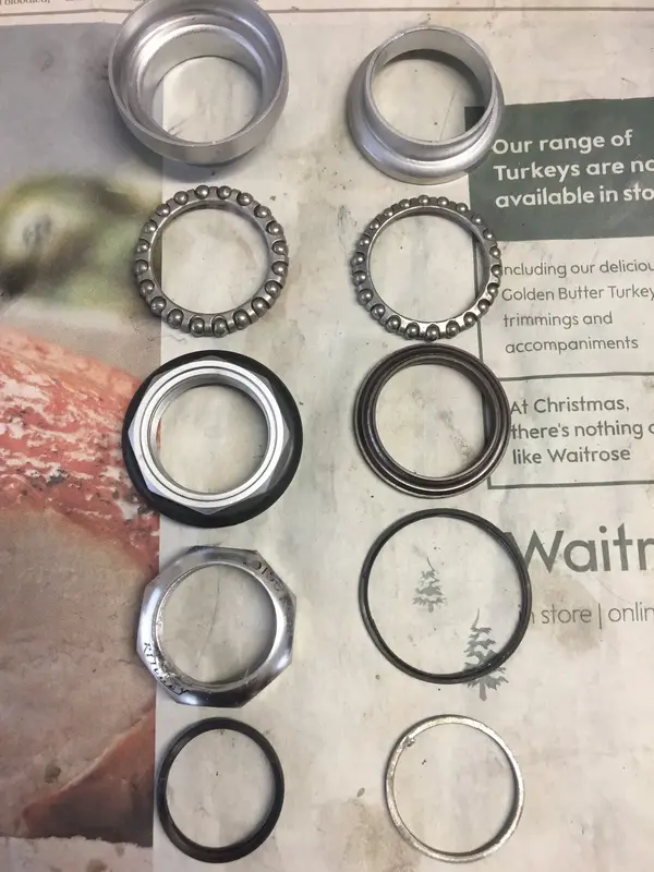

Don't know if it's any good to you but I removed a Ritchey logic headset from a '94 Indian Fire Trail.The top nut is damaged but useable,looks like someone hammered the stem onto it,dented it on the top and squished the top seal slightly.Otherwise is in great condition.Very slight pitting to the crown race but still smooth enough.Fully cleaned with new lower bearings.You could just use your old top nut if it's still good?

Fantastic! £5 posted.It's actually in really good shape aside from the damage.The ball bearings are useable but a few spots on them from water ingress,for the sake of a bag of bb's I'd stick new ones in and you'll be good for years.
