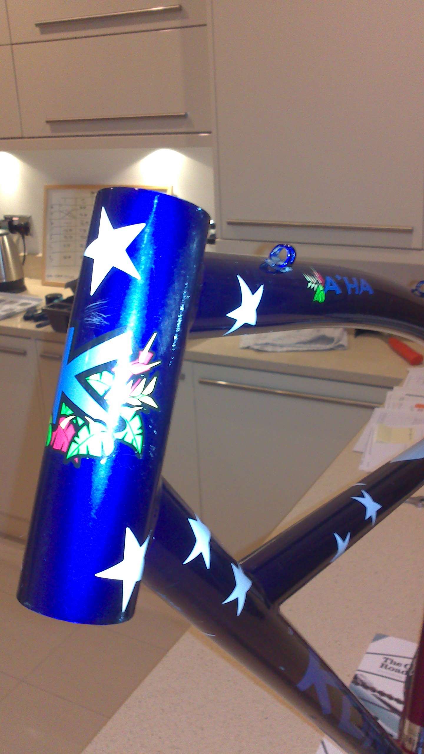

Very cool bike! I can confirm that the stars and bars on my '96 Hot are indeed painted. It looks like white was shot on the front part of the frame and then the stars and bars were masked. After that the blue/red fade was applied and then the masking was removed to reveal the stars and bars.

ah, OK now I see, you wanted to know, if the stars are painted or decals - I thought you where asking about the writings on the frame, like "KONA" and "Ku" - my mistake :oops:
can confirm, that also on my KU the bars are painted and not decals - sorry for confusion.

Yeah, actually, the stars & bars are painted on mine, too.
Mostly.
There are a few "extras" stuck on top of the clear coat, which look like they came from an Airfix kit :facepalm:

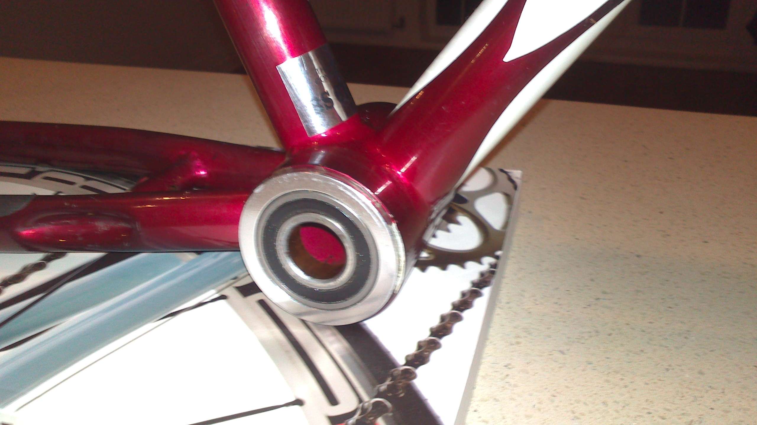

It has a US BMX BB shell. DMR do adapters so you can fit a square taper or outboard BB.

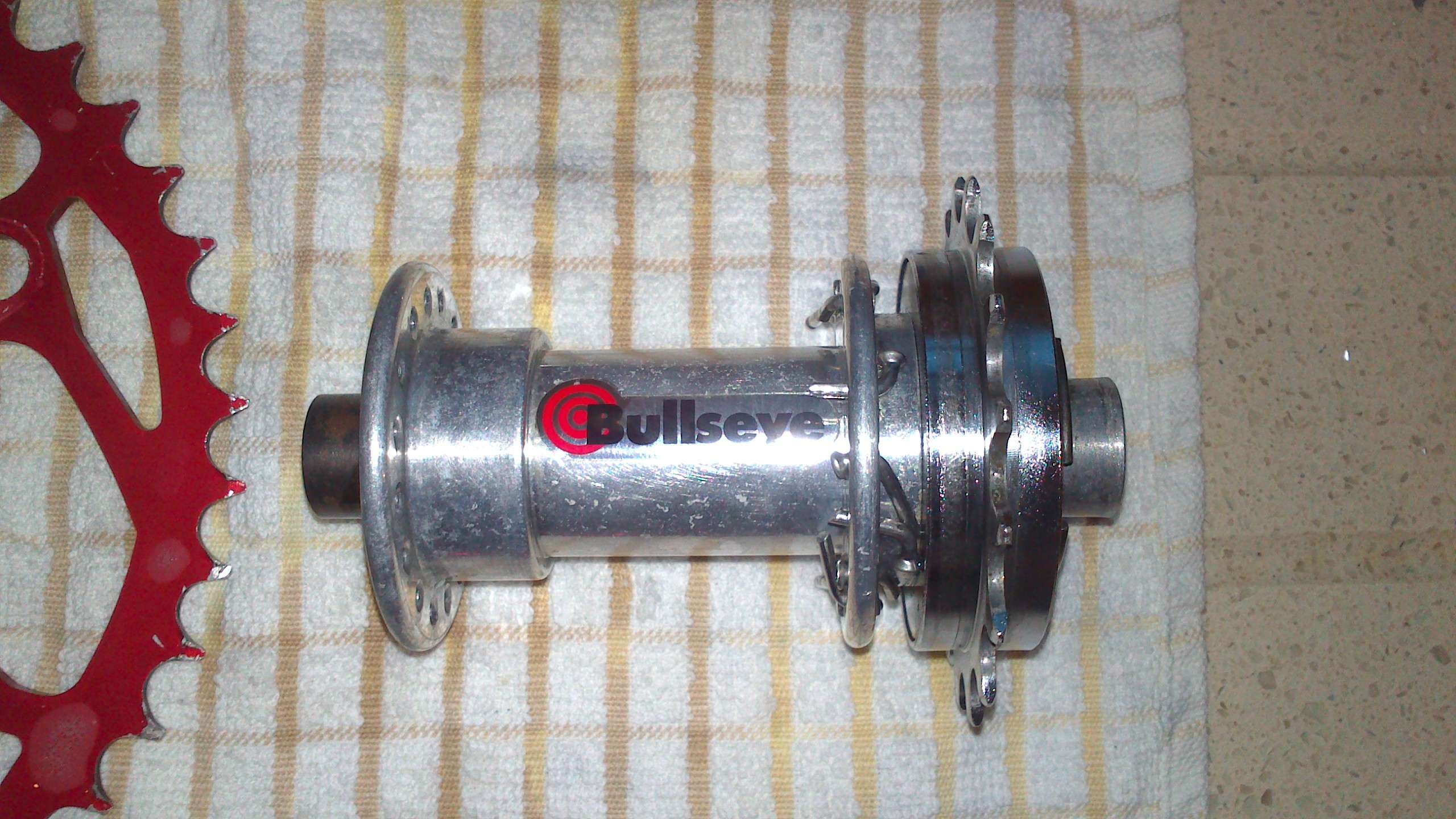

Rear ends on non-disk Humus were 110mm, 112mm, and 120mm. All are variations on old-school track or BMX spacing. My A'ha is 112mm with a perfect "track standard" 42mm chainline. This limits your rear hub choices to BMX, track or older dirt jump bikes (DJ bikes now all seem to use 135mm disk hubs). So the options are somewhat limited unless you go upmarket to Phil Wood, Campagnolo Pista, Profile BMX (drool) etc. Or put a screw-on freewheel on a narrow old road hub. Maybe Surly or On-One do one? Alternatively, go to Alans BMX: He has some old-school BMX hubs that will do the job and look the business.

Yes, stars and bars are presumably decals, but are under the clear coat.

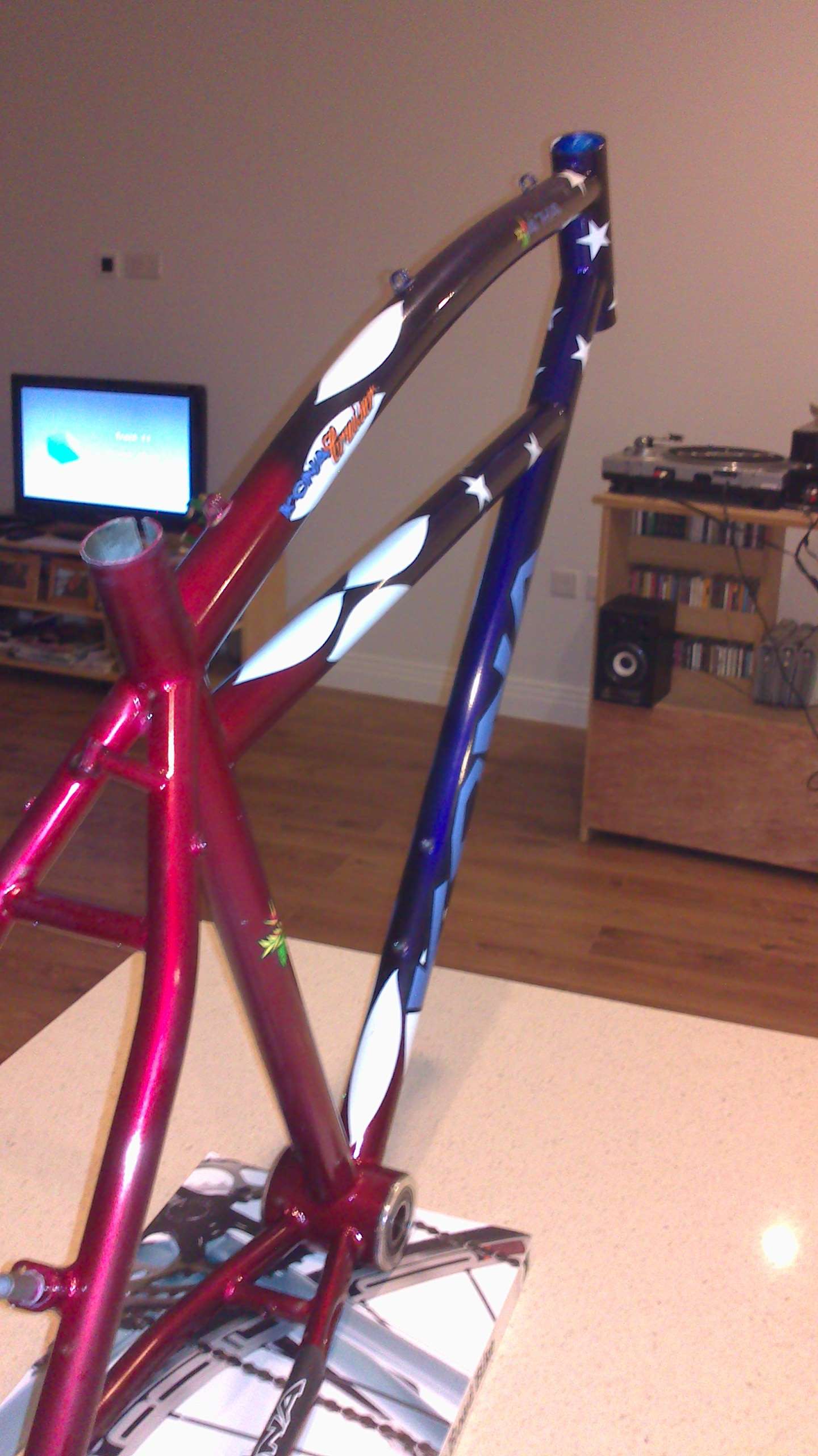

I had fun giving her a good clean this weekend, I think she came up proper good (my camera phone is shite - it looks much better than this). I also managed to win a donor bike on the 'bay; a 97 Hahanna. Whilst that was bottom of the range it means I can take the P2's and canti hanger (ticky to find), stem and rims (they used the same). I have a spare front hub from the 97 range, so with that and the bullseye hub (is it really?), plus the rims, they'll make a sturdy set of wheels especially with the blue (front) and red (rear) nipples they'll be treated with. Curve canti's will look the part and I'll use white cabling.
That just leave the saddle and bars...still not sure what to do there.
Imagine my surprise when I had a good look in the parts bag that came with it and this popped out...
Is it really a Bullseye hub or just a cheapy one with a cheeky sticker?
These got the usual strip down, clean and autosol treatment - lovely results:

It doesn't show well but the red is a really deep burgandy metallic - very very nice whilst the blue is a traditional navy but not metallic (bit of a shame if I'm being really picky).
