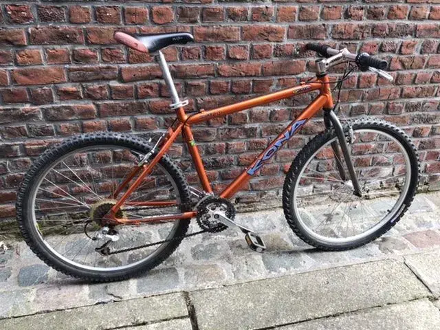

Hi. I’m new to the forum and have a small collection of Kona’s from 90s. They are not top models but I’m hoping to build up. Looking to Kona fans out there for advice. I have an almost original 96 Koa in great great condition and a frame (minus components) of a 96 Lava dome. Am I correct that they basically had the same components? LDs seem to be more popular being steel. The question I have is should I build the LD up with better reconditioned components and leave the Koa as is or transfer the components over to the LD and make it “original”? Open to suggestions…thanks. BC8E9FE4-E23C-4F25-B132-5414FEB1D361.jpeg
Hello and welcome to Retrobike.
The Koa pictured in your post is a 1997 model. It is an earlier example with the Canti Bridge on the Drive Side Seat Stay - the later version does not have this feature, as V-Brakes were by that point making an impact.
1996 Koa that you mention has the same Geometry and 7005 Aluminium Tubing as the 1997, and is a lovely Matt Red called Red Rum.
I'm now wondering what year your Lava Dome is? The colour of the 1996 that you mention is called Orange Lava, and is a similar colour to the 1997 Koa, while the 1997 Lava Dome is called Forest Green.
Take a look at the link in the 1997 catalogue below, and you'll see the components used - I'd leave your Koa as it is, and build up the Lava Dome.

Hi Pip. Thank you for the correction and advice. So then as you mentioned and from your specs link my Koa is 97 and my Lava Dome is 96 - very similar in colour. I am glad to keep the Koa as is being complete and a one owner bike - picked it up from a guy selling it as a kids bike and it was fitted with mudguards and reflectors😁 I was thinking of converting the Lava Dome to Deore XT with XT thumbies - not worth hunting for XTRs for a Lava Dome. I rescued them off a damaged Cannondale heading for the dumpster.

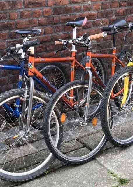

My daily ride is a 98 Fire Mountain 335E469C-AC8E-44F0-9390-BA8DFCFE958C.jpeg which I upgraded to 8 speed (wheel swop-out) and put on a Deore LX rear derailleur and Deore thumbies upfront. Not the most desirable but great for getting around and considering setting it up to do a few bike packing tours. I have the 97 Fire Mountain as well but it is also a one owner close to original condition.

Thanks ENC. I will take the advice. Just need to source some period look pedals for the Koa. As mentioned I picked it up being sold as a kids bike for the school commute.
