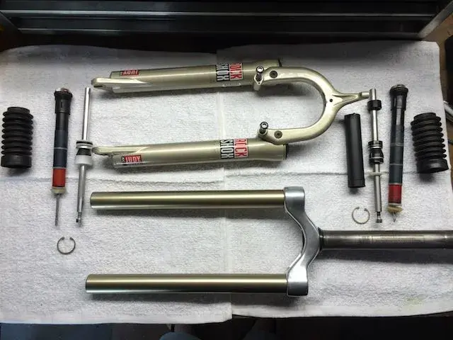

Hey All- I'm starting this thread just to double check what I've got is worth saving or possible to rebuild with the current parts. I decided to get back into a hardtail and found a SUPER clean '95 Klein Pulse. Of course, the first thing that went was the fork ('95/96 XC). So here are a few shots after disassembly and cleaning. Oh….and I've already researched the steps/parts/etc from GT-Steve's write up (great work!!! Thank you!).

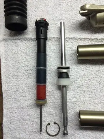

The dummy side had the worst side with crumbled elastomers and jammed up parts. I was able to clean everything out and inspect the internals and all looks well. The cartridge side is of the most concern. When I loosened the bottom hex bolt grease started to slowly pour out (it was clean). Unfortunately, when I pulled the damper cartridge I discovered it's the plastic version. The top (closest to the elastomers) was filled with crumbled bits and oil. I've read through other's responses about the "asthmatic" sounds vs "falls apart" and mine kind of leans more towards the asthmatic sound. It has some suction but nothing incredibly strong (should it?).
My question/concern are:
Will I be able to use the current parts with the plastic cartridge or do I need to toss it and try to find a metal one?

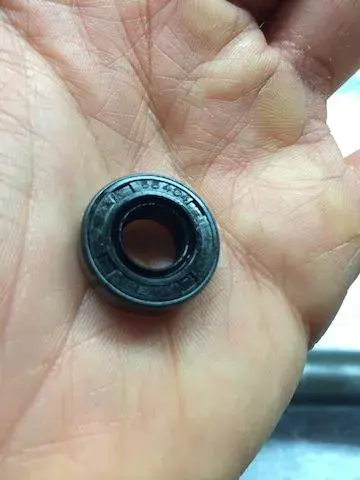

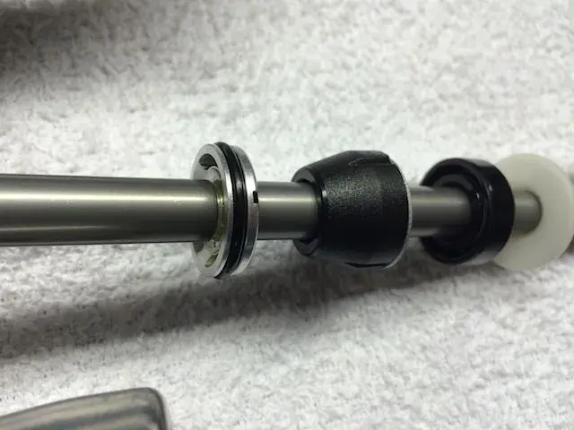

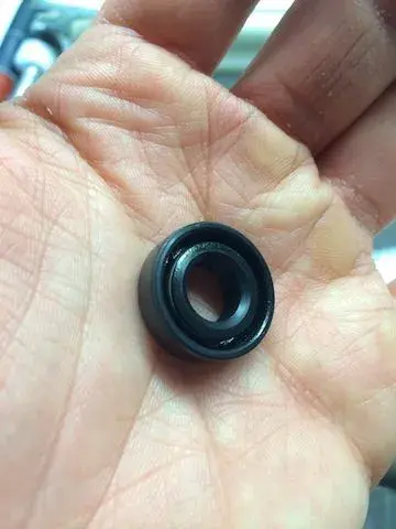

Is the seal the (picture of the seal in hands) the problem the cartridge is leaking or is it the O-ring?
Does anyone know where I can find the seals/o-rings if this is the problem?

Get the spring kit.
You could use the MCU kit with the spring kit to help cut down on the bounce you can end up with using just springs.
The dampers are junk,they were junk when new to be honest.
You can get air kits for them but they are getting hard to locate now.
On the up side they are worth saving, and from the pictures the stanchions and outer legs look real clean.

The damper when it's on one piece damps the springs so no need for elastomer bodges, these are not like other elastomer forks with no damping.
The problem with that plastic cartridge is the seal is friction fit. The plastic heats up and cannot dissipate heat into the leg quickly as gar as I know
This cause the seal to loosen and move and so let oil out. If you can get a later one of same shaft length do so (or a dummy and damper set of different length).
They do tend to pull apart when you pull the legs apart so it may not have been a problem.
Rebuild give it a go and search while riding. Change it later if needed.
