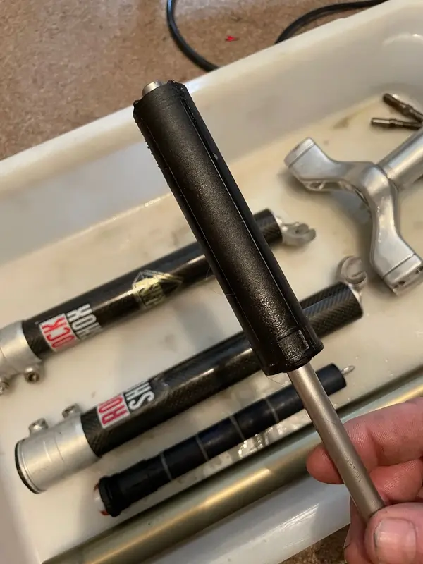

Today the postman ring at the door and give me the precious package. I open it and try to compress the fork, look hard but not surprised with 25 years old elastomers. So, I take my tools and begin to disassemble the fork... Lowers OK, elastomers crumbled as expected. I remove the circlip ring and drawn the cartridge and tadaaa (drum rolls, I've never seen a Risse cartridge in real in my life...), look what I see..... A Crappy Leaky Plastic stock Rock Shox cartridge, the first generation one (replaced after with the aluminium ones...).. Looser mode 👎🤡
For sure, I've a really nice Risse Racing Gem cartridge STICKER on my fork, I'm an happy man today...

Nowt wrong with plastic cartridges, they help keep one leg lubricated, unfortunately it also helps the bushing corrode the lower leg there for some reason.
Glad you're super happy though. It is a nice sticker.
Freddok - I’ve done quite a few rebuilds on plastic cartridges - if the plunge shaft is OK then it’s quite simple to do a full rebuild and get a really good damper out of it. The O rings tend to harden and they are the culprits for the leaking. This guy has some great availability of very rare parts, at reasonable cost. I recently rebuilt one to original standard with two main shaft end seals.

Thanks for the link !! 👍 At this time I didn't looked the cartridge health...
And I am afraid that I have sold all my medium and hard SpeedSprings (after buying a box of them from Italy) but I do have a few ‘soft’ and ‘xsoft’ left. With a cartridge rebuild and SpeedSprings it’s a very presentable fork.

I'd look for a nice cartridge, fixed a few plastics up. They just go eventually on a good long ride, often lodge themselves in as they expand a bit.
But for gentle riding they'll be fine.
