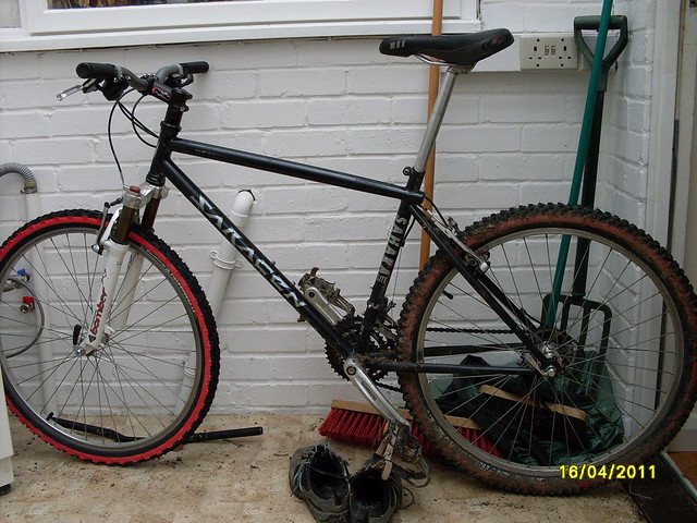

Like I say guys, I wasn't that bothered until I found the deflated front tyre -- but the flatter top-tube and the steeper fork angle made me say "Wow! That's the retro look that my bike didn't seem to have any more!".

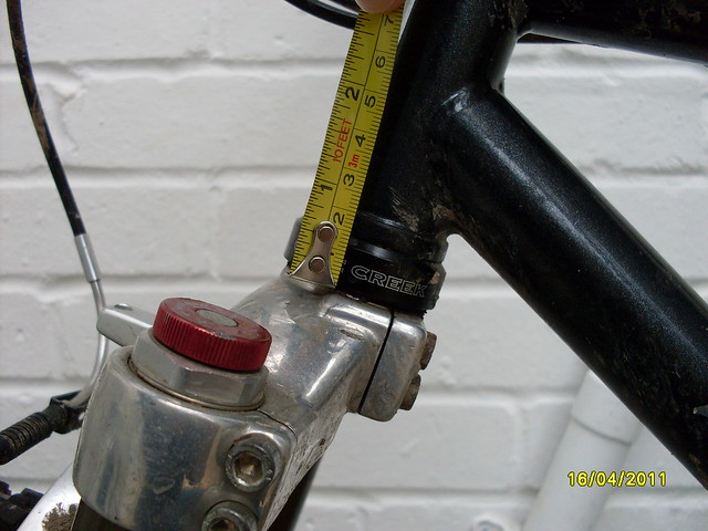

The bottom cup of my headset measures about 14mm in depth, so swapping that for something skinnier might be an option (although the adjusters on my forks would be much more likely to clang my frame)...
And looking again at the photo of my bike in Eartham Woods, those Panaracers look like tractor tyres on my retro steel frame...

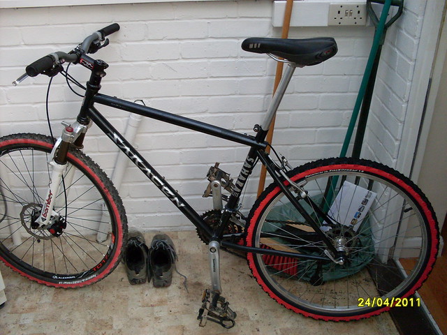

And then I remembered that the Panaracer Fire XC Pros are available in a 1.8 size as well as a 2.1. Here's a picture of a bike with the 1.8 on the front and the 2.1 on the back...
And here's the 1.8 on both the front and the back...
...which I think might suit my narrow Bontrager BCX3 rims much better anyway, regardless of how it looks.
So I'm gonna dash out to my LBS and see if they've got any 1.8s in stock and stick one on my front wheel to see how it looks. I'll post photos and you can all tell me what a pillock I am for worrying about such things... ;) :lol:
See if you can guess which is the 1.8 and which is the 2.1... :lol:
I'm pleased with the new rubber and I'm kicking myself for having a "chunky tyre obsession" for so long. The 1.8 is going to make the bike lighter, faster and look a lot better.
Right, I'm just plucking up the courage to spend another £29 on one for the back wheel... :roll: ;)
Well, whatever was bugging me about the way the bike looked has been mostly cured by replacing those Fire XC Pro 2.1s with 1.8s...
I'll keep the forks as they are... :lol:
