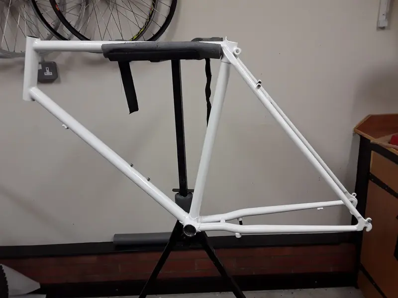

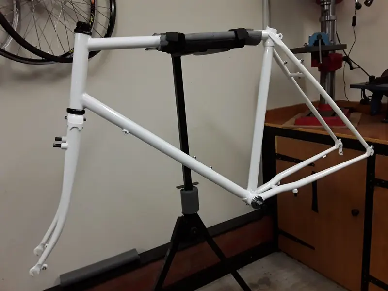

Well that was several months ago and now to bring the build up to date "ish".....
The bikes been stripped and most of it chucked, the rims ive saved to rebuild onto some xt hubs for the bike, buts thats later when the weathers really cold.
The frame needed some work as it had mounts for a drum rear as well as a set of u brake mounts. I decided to go with the u brake option, so went to my old works and borrowed some space, a brazing torch and the pipe sander. It also gave me a chance to assess the rust on the top tine from the unwanted, unused, crud filled cable guides. Bad......but double power and clear top will cover it.....i think.
So, frame and forks went off to be powdercoated, i went with a suitably subtle 80s white with a light, frost sparkle. Bit like the guys in the " Get yourself seen" adverts of the time ( except no brush required).
Decals ive desiged from some images found on retrobike and an old mate of mine is cutting them for me.
Todays job was to tap all the holes, face the bb and the headstock. Thats all done and the forks are in with the m732 bb fitted.
I decided that as very little of the original bike was left and as there is no catalogue to go to, i would go full on xt m732. I thought about period correct m730, but decided i wanted the 7 speed, plus ive got all the bits.
The only annoyance was that when i came to fit the headset i discovered 2 things.
1. The frame is 26.4 iso. Bugger.
2. The xt 732 headset i had put aside for it was 27mm jis and that i had forgotten that when i removed it from another frame, it had split........explained the notchyness!
Luckily i had a ritchey logic one, so thats been fitted.
I cant go too much further till i get the decals as it makes the frame hard to handle and to set up a straight line on.
