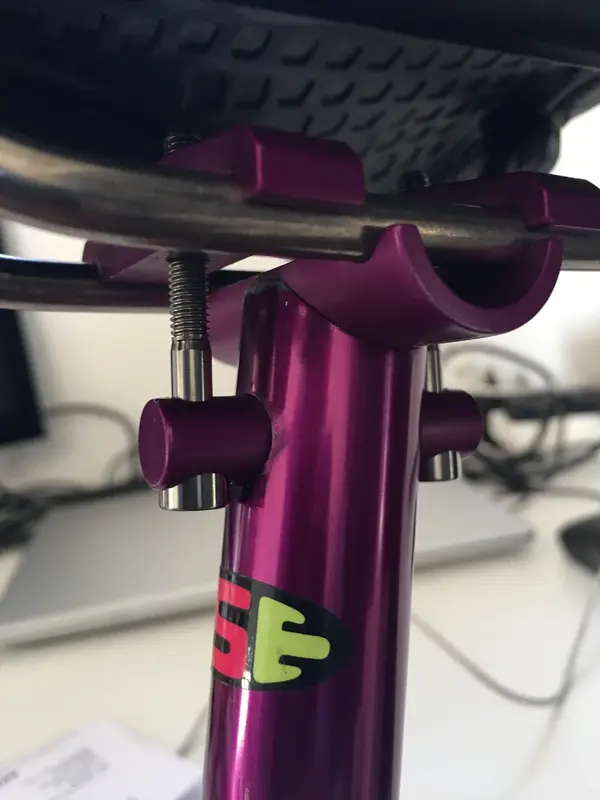

Replaced the tatty seat clamp bolts with some Ti items.

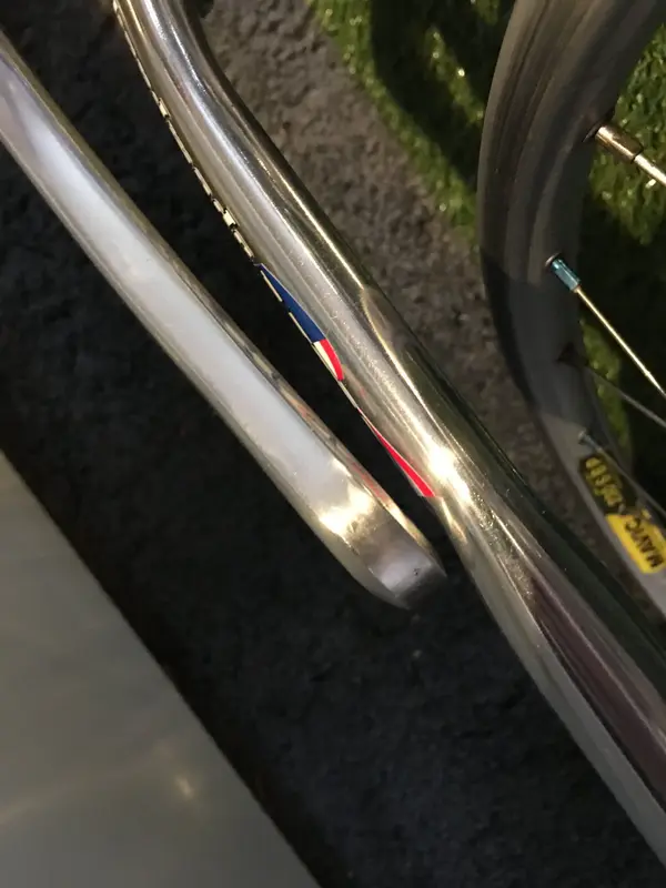

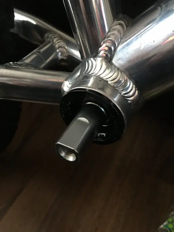

One issue I had was using the recommended 122mm bottom bracket axle width for the M730 XT chainset. The non drive side crank only had a 3 - 4 mm gap between the chainstay.

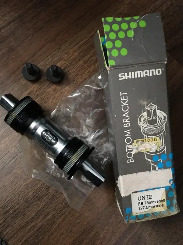

After a bit of research and advice from fellow RB members I opted for a new old stock 127mm axle version. This has sorted the issue nicely.

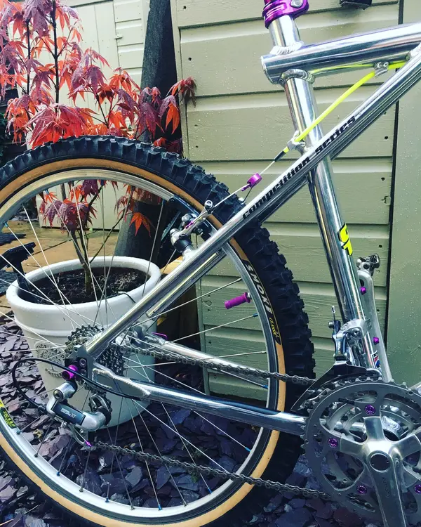

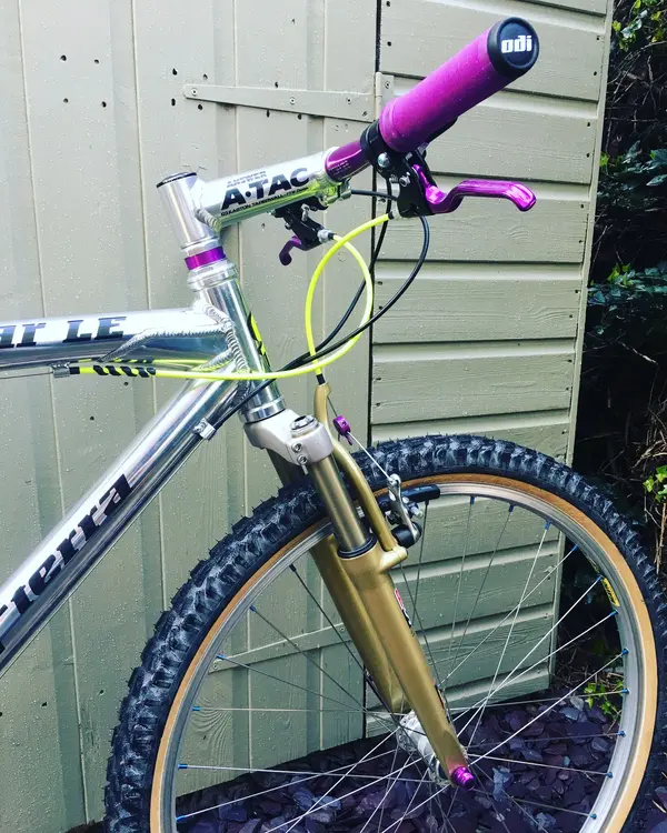

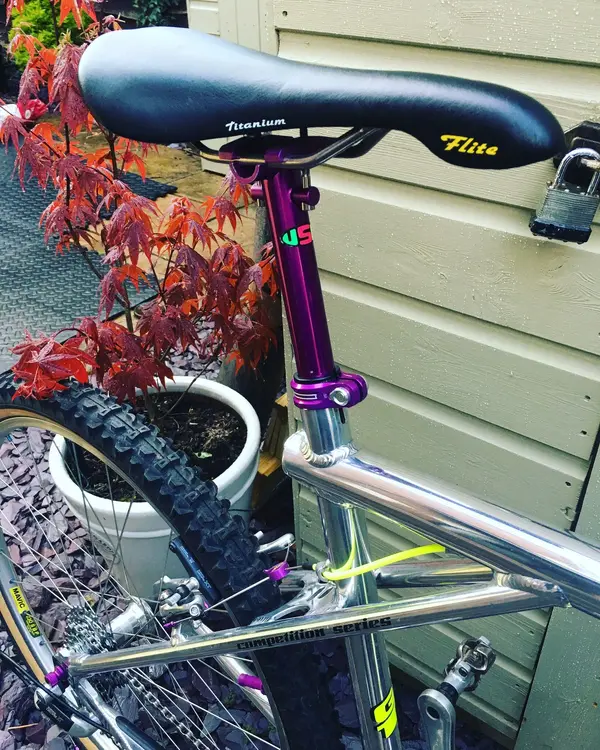

So, she’s finished! Very happy with the shiny, purple and neon finish. Not for everyone, but she’s a real eye catcher. I’ve built this from a frame upwards and have sourced parts from all over to get the build finished.

The close up shot of the cockpit with purple bars, grips and levers HURTS MY EYES! :eek: Not sure if it's a good hurt or a bad hurt!!! 🤣🤣🤣
Lovely build with nice little touches vs. catalogue spec builds. Had x2 Zaskars back in the 90s and loved them.
I love it... I think the purple bars are bold but I think that it’s nothing we wouldn’t have done bitd so it works for me 😎
I don’t mind the bling look so long as I have the standard bits to revert back to should I get nauseous of it...
great job 👍
