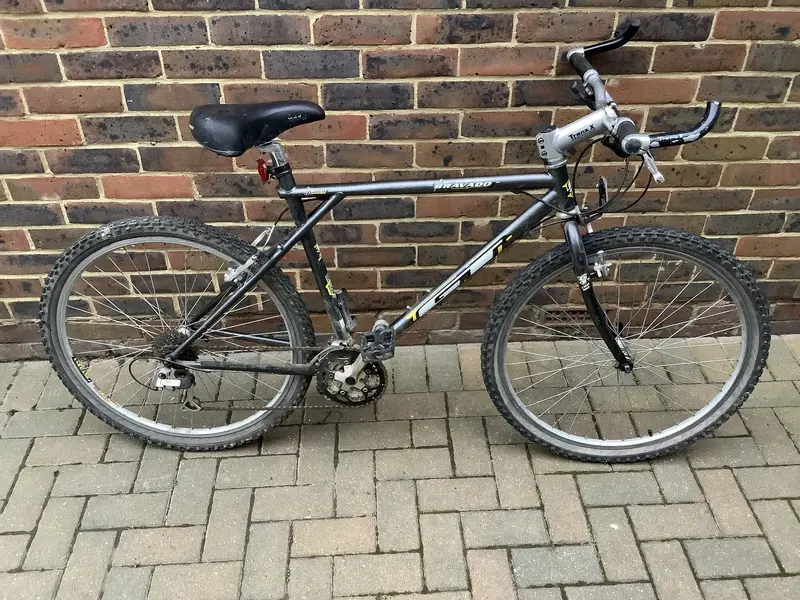

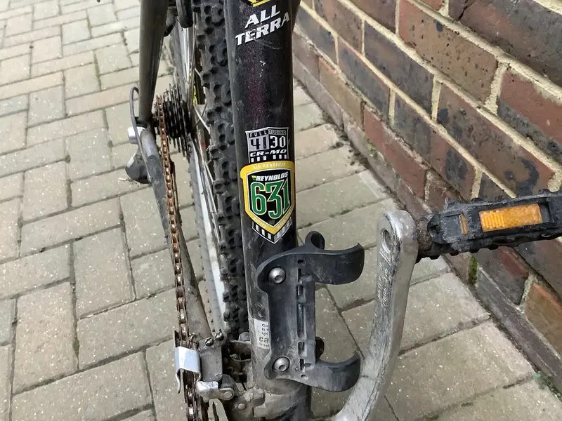

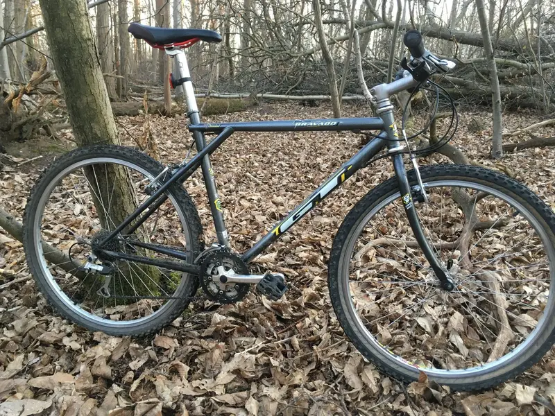

I don’t know anything about this, I can’t find this paint scheme in any catalogue. 1997 maybe? Any GT experts able to provide more info?
It was cheap so I bought it as a project, I’ve not had a retro bike purchase in a long time. It appears reasonably well spec’d.
All the bearings will need doing, cables, chain etc. but the seat post is free. 😁
SP

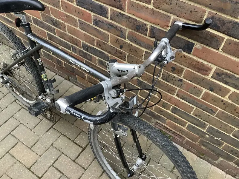

So, a quick rummage gives me the following fork choices:
Shitty RST with coil springs and no damping (very long)
Box fresh Project Twos with a nice long steerer
Fox F100 RLC I could drop the travel to 60mm on
Or….
A stem extender and keep the original fork 😯
My back / neck won’t like the current set up. My tightness prevents me from buying another fork 🤣.
Nice purchase 👍. If it was mine? I’d keep the original forks. Maybe swap the stem for one with more rise and rotate the bars slightly to improve the position. Would that be enough?

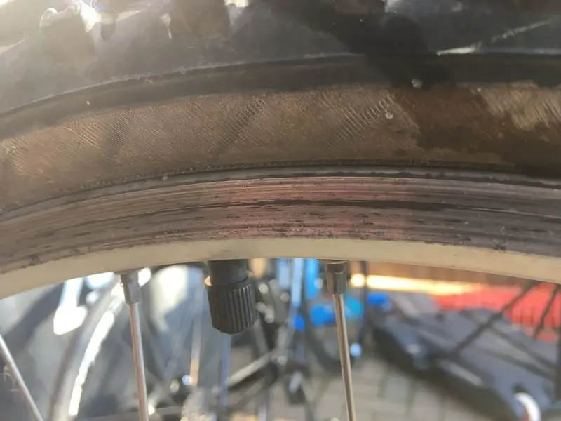

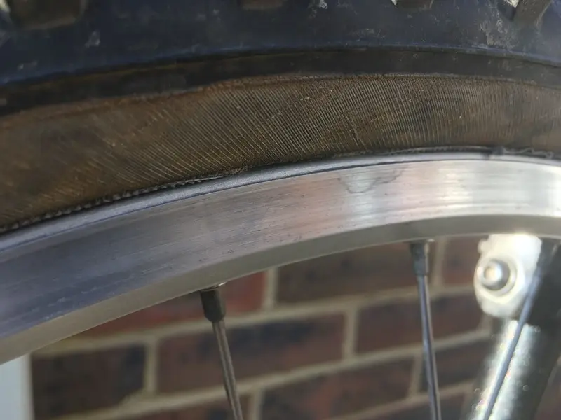

Rims de-glazed.

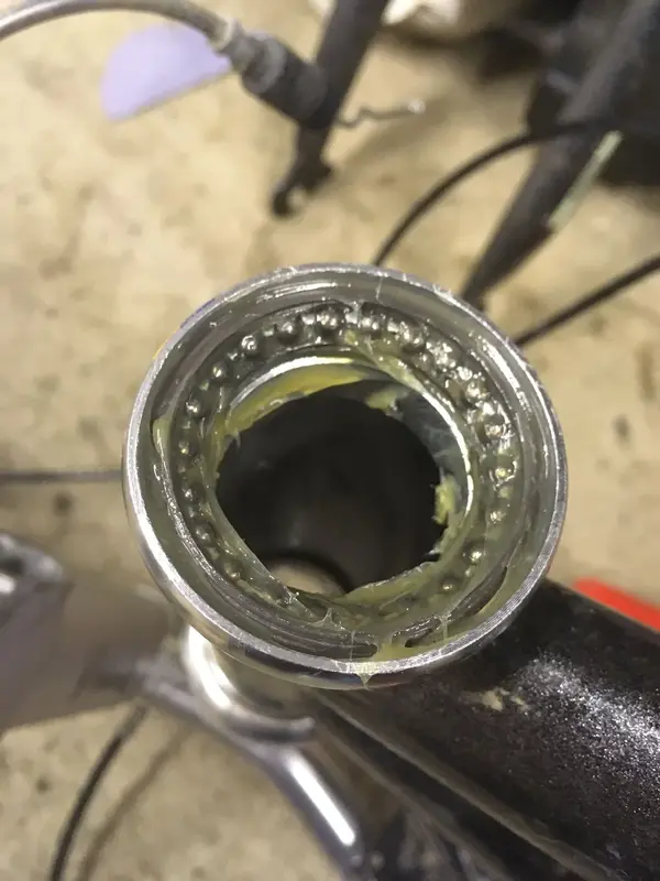

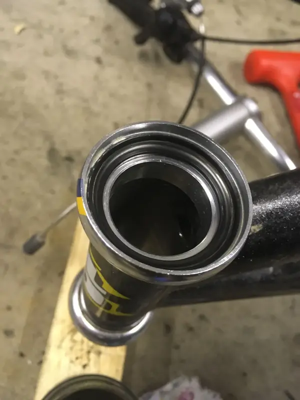

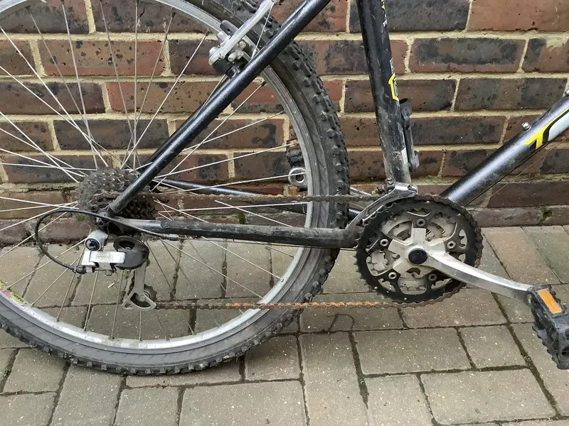

So, I debated what to do with this, as I have a suspicion that despite being a 20” frame it’ll be too low at the front end. Therefore I did the bare minimum to make it rideable and ensuring no damage will occur. I.e. if I rode it further with notchy bearings it could make things worse. Last night’s ‘service’:
Fixed the front puncture
Re-greased the rough headset (much better now)
Re-greased the front hub with new balls on one side
Re-greased the rear hub (well slapped more grease over the old grease 😳)
Replaced the seized gear cable inners with decent used stainless items.
Replaced the snapped ferules with decent used items.
Replaced the totally shot and rusty chain with a less shot (but 11 speed 🤦‍♂️) second hand chain
De-glazed the rims
Fitted new brake pads
Adjusted the brakes
Bike is undersized for you judging from seatpost height but you can make it work w/ a riser bar. Bravado had a good steel frame.
