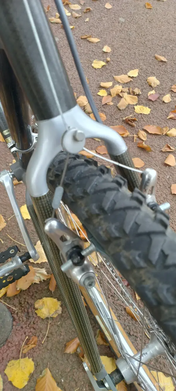

Very nice and thanks for the scan. I see mention of the 1 1/4 size in the review. The headset of my '92 CFM-1 frame is 1 1/8.
