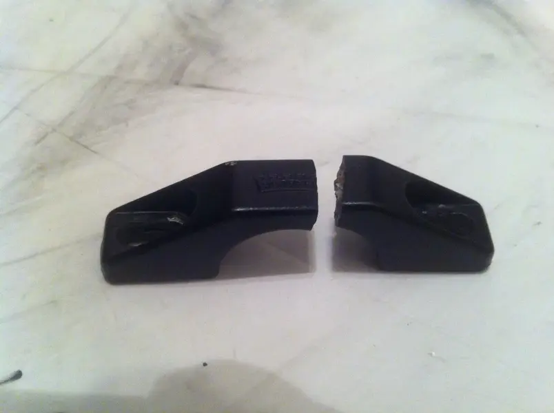

However, iPost Parcels still managed to break something :evil:
Anyone have one of these Magura brakets to spare?

Yummy frame feller shame about the damaged bit,,

Also anyone selling the hubs I am after, or got a spare of the above bracket which the postie broke?

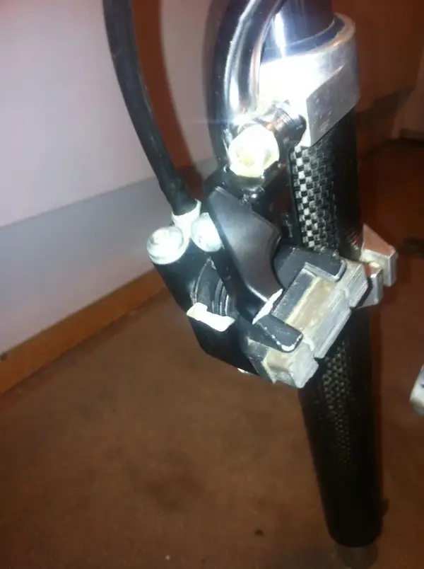

Update - a few parts arrived, XT rear mech from RB member raidan73 and Easton Monkey bars from Fleabay, and new Magura clamps from Tarty Bikes, to replace the one the postie broke. Will mount all 4 new clamps when final clean-up and build is done.
and mounted - ignore the short brake line, that's due to the old bar width and they'll be gettin' replaced anyway (if I stick with the riser bars)
