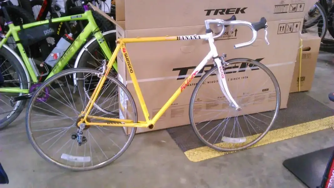

I was talking to a customer the other day and he asked if I was interested in old bikes.
Today he came back to drop off a Falcon Team Banana that he said he would never get around to doing and wanted it to go to a good home.

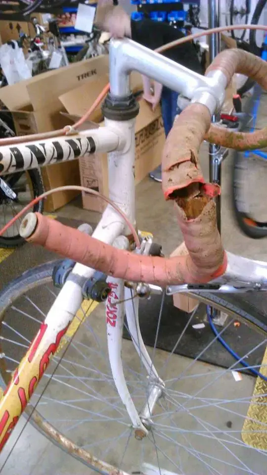

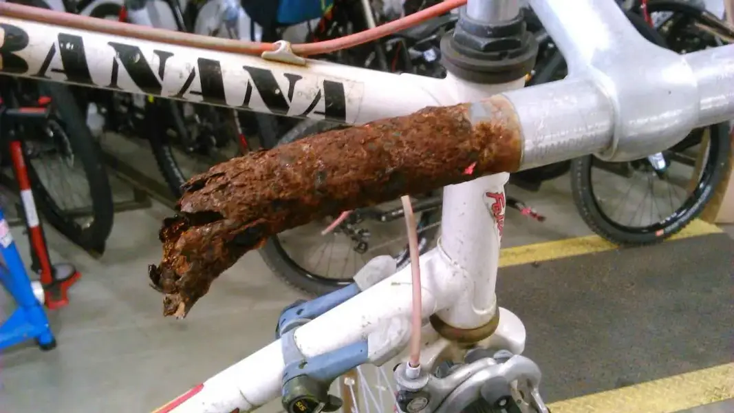

Frame is in reasonable condition, seat post not seized, I'm guessing the b/b will be. Most of the bits will probably end up not usable, the handlebars have actually rotted through under the tape on one side.
I'm not going for originality, I will clean it up and make it usable with some reasonable bits.

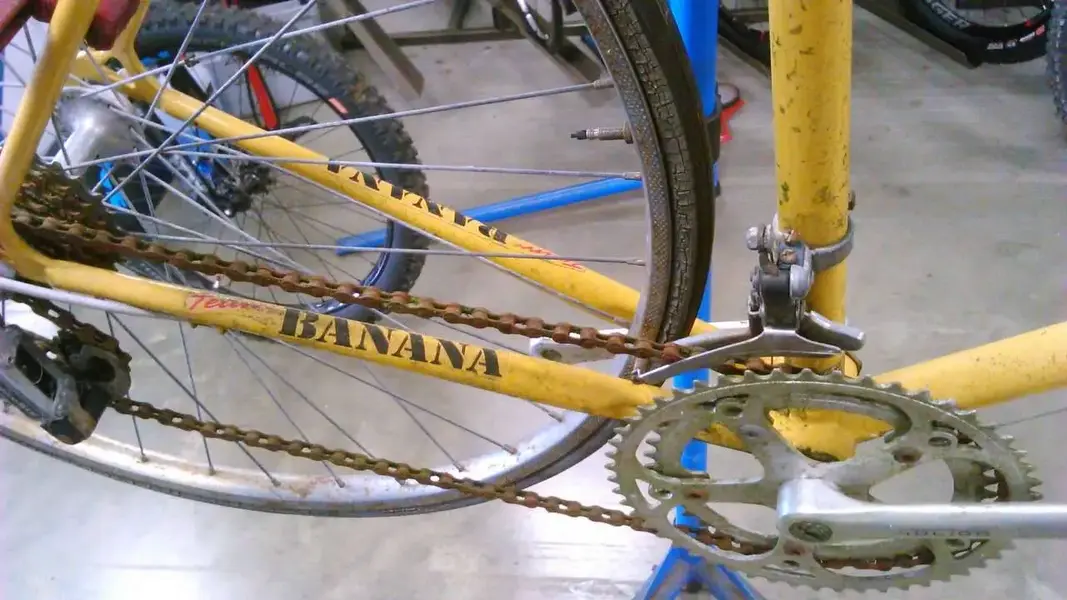

I don't know how many decades it sat outside, but its not pretty.
All moving parts are knackered.

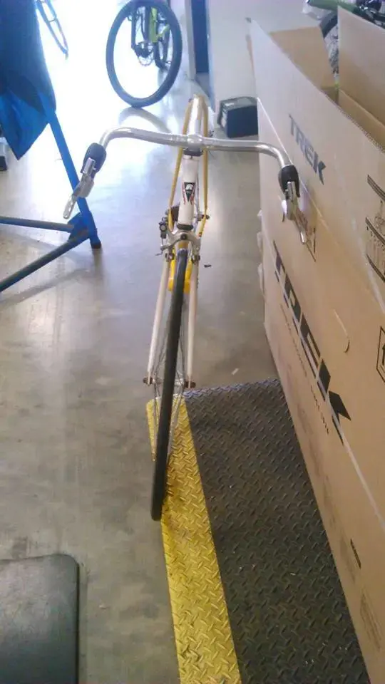

I've been accumulating parts.
Amazingly the b/b came out with no resistance at all.
Done some cleaning and fitted some new Nitto Randonneur bars and some newer brake levers.

That's the rottiest set of bars I've seen, was it stored with that side in a pond?
What are you going to do with it? just get it back working? Or a bit more of a restoration?

Never seen a pair of 'bars rot like that! Hope the rest of it is OK under the paint!

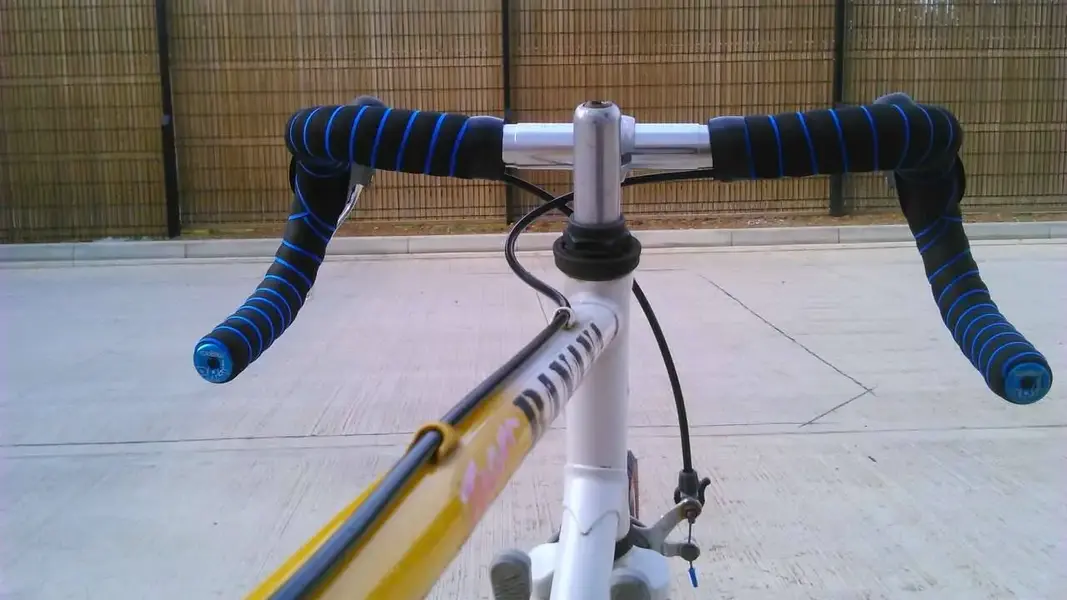

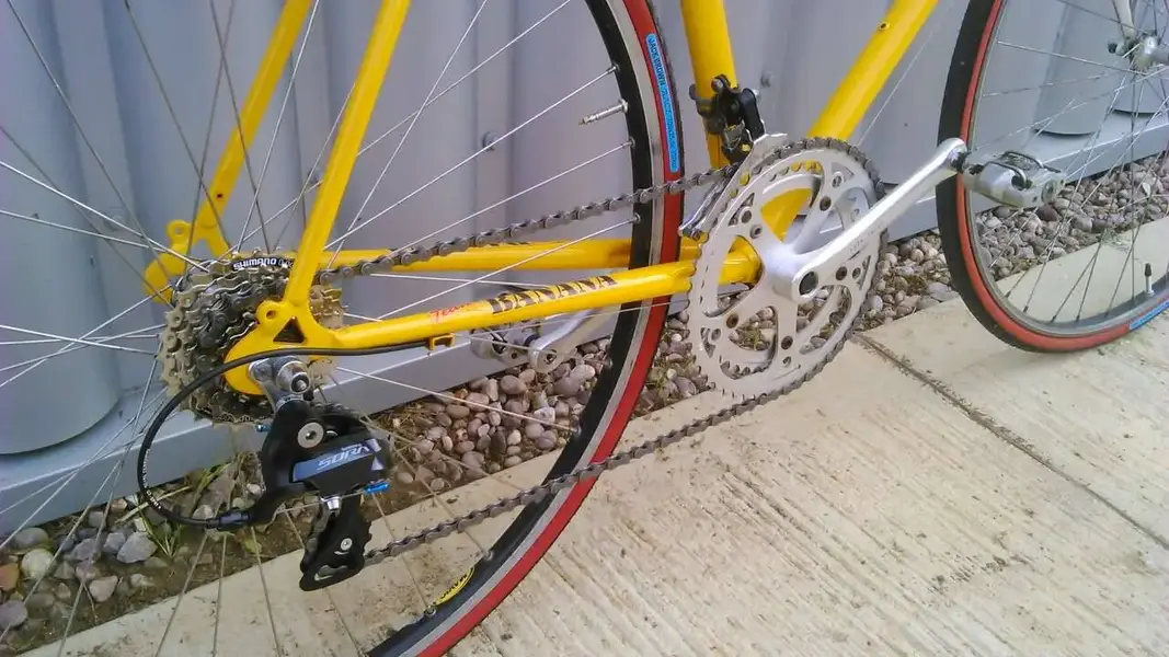

That's it. All done, probably the quickest I have ever got through a project.
In the end, I have used parts from the 105 brakes to sort the original brakes, and I have re used the original front derailleur for now.
Hopefully I will get to ride it over Easter.

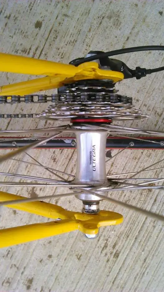

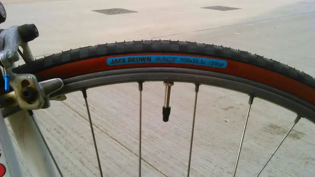

I don't know what the odds where, and I cant remember who it was that I bought it from.
At Mountain Mayhem, a single front wheel was for sale, Ultegra hub and Open Pro rim.
Now I have a matching set, the bike is looking pretty smart, rolls nice and its a pleasure to spend time on. I don't ride it that often, but try and get out on it at least once a week. Next time its clean I will try some better photos
