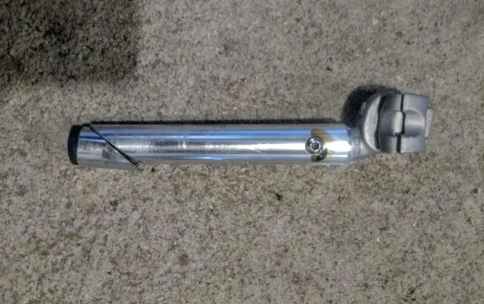

I have a "quill" post for my late 80s Moser Leader "SC". It's not the OE Moser post and only cost me about 10 quid at the time (about 3 years ago. you do not need a special wrench; it has an allen head bolt exposed on the side. I cannot remember the name, but I will check it and post it here. It is 27.2mm and is not a BMX post as it has some offset to it.

I know I got it used at my local shop; a good place to look since not many folks are using that type of post. I got lucky with the size being correct though. I keep thinking it was an Avocet branded post; that bike is in my storage unit so I'll verify this weekend. I know a lot of Moser owners who ended up cutting a slot in the seat tube and using a collar style clamp; but that "uglies up" a really nice looking fillet brazed conjunction.

Hi Pete,
I checked out my Moser, and it has a Sun Tour 27.2mm quill post . As I said it has the tightening bolt accessible on the side of the post so no special tool required to reach it; no removal of saddle required either. I do not know it you can find one or what the price would be. It has worked fine for me but I am fairly light at 140 pounds so I cannot vouch for how it would be for someone another 25 to 50 pounds heavier than myself.

Thats a really interesting seatpost Jesper. I've never seen one with the bolt to the side like that, it means there is some clever bit of magic going on inside to convert transverse axial motion to linear motion in the other plane. I'd love to see what's inside but I won't ask you to show me. :)
