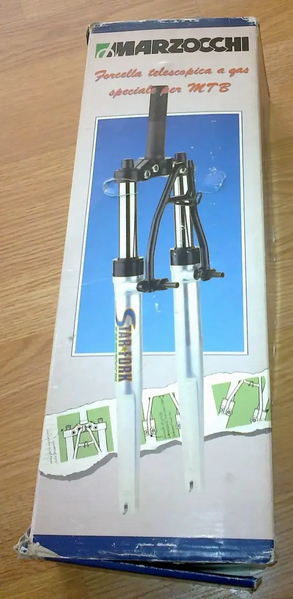

just adding some more material from a brochure and the box
I had one a while ago, with silver lowers but also the variant with the more ugly brake arch.
It had 1 1/4 steerer, and especially all upper parts like arch, crown and steerer had been really massive.
