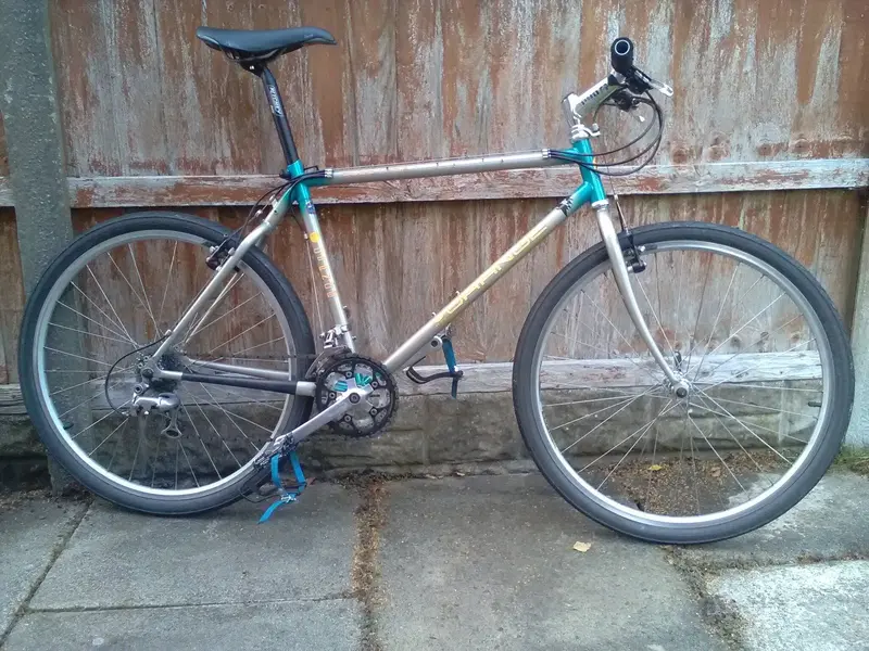

I did exactly what you're thinking about doing with a 95 Pine Mountain and it weighs around 9.7 kg. I took off the granny ring and run it as a 2x8. The gearing of course will depend on you and the terrain you will be riding in. I live in a flat area and use only the large ring (42) and the smaller cogs on the rear. It's certainly fast, only a minute or so slower over 20 miles than my steel road bikes of similar age.
Thanks Fourbikes that pretty much what I was looking to build, I may be picking your brain in the coming weeks
One question what tyres are you using ?
9.7 kgs is much lighter than the hybrids I was looking at too!

They're Vredstein Slicks 1.3. I don't know whether you can still get them but you can get something similar. They weigh about 400 grams each and you can pump them up to 90 psi.
I've also got an Orange in similar guise using the City Jet tyres which weighs around 10.5 kg. It's almost as fast I'd say and more comfortable on the fatter tyres.
