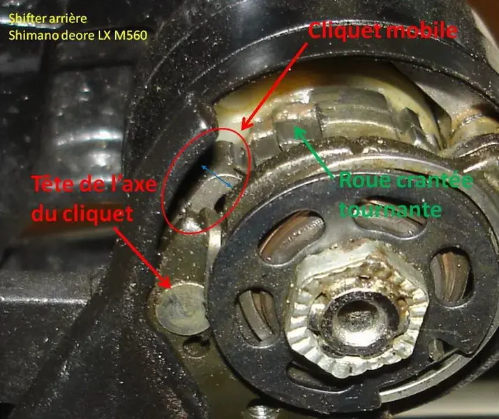

I've had a few of these, aswell as the stx's, alivio , DX etc that have similar internals. They all tend to have issues with the springs that have lost tension or grease that has hardened. For the springs, it's either the 2 small ones that do the shifting or a larger ones in the centre of the mecanism that need to be retensioned by undoing the locknut inside and bending them in the opposite direction. Sometimes for the grease, you need to undo everything to really get to the parts and clean them. Putting it back together can be a bit fiddly.
...Infact someone's currently posting a rebuild of a xt shifter, it's fairly similar, although the lx is more plastic
you have to move the pawl with a small screwdriver (blue arrow)
