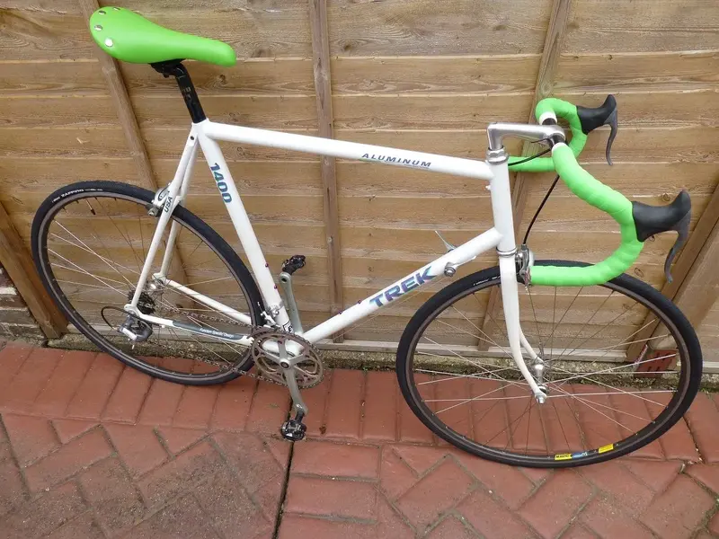

I used some on the Trek I built ages ago, sprayed the bars with hairspray, wrapped it proper tight tucked the ends in the bars & secured with plugs & it was okay.

The same, you have to wrap it tightly from the top of the bars downwards and then secure at the ends with the plugs and then it stays put just fine.
It is a case of you get what you pay for and I've only used it to get the colour I want but its actually quite comfortable if you get it on right. When I've used it I over wrap once when I start to trap the end at the stating point at the top of the bars and then keep it reasonably taut as I work down to the bar ends, I also make sure a fair amount goes in the bar end so the plug has to go in with the help of a mallet so it locks it good and tight.
