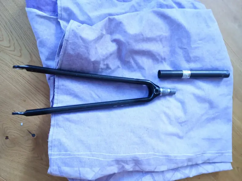

Anyhow I'm after some advice that is probably better served here. I have a modernish bike that I needed to get forks with a longer steering tube for, it has a 1" steerer so not as common as the normal 1 1/8". I found a set on ebay, bought them and went about fitting them on Saturday.
All went well until I put the bike back on the floor and turned the bars because although the bars moved the wheel didn't. I thought I did tighten the stem didn't I? I had so had another look and the steerer itself and it was moving independently of the forks, after taking them back out I tried to move the steerer by hand and after a bit of effort it did indeed move and with a bit more turning it parted company with the forks, having had a pair of steel forks fail on me at the same point I was a tad concerned.

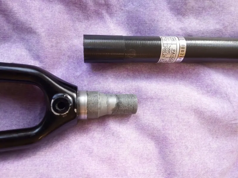

The two parts are a very snug fit and there looks to have been very little adhesive keeping the two together in the first place as you can see what's left of it. I have contacted the seller but and these may be silly questions, as finding another set of suitable forks will be a pain is this something I should look at getting re bonded? Could I do it myself with the right adhesive? or should I just send them back and carry on searching? All suggestions welcome.

2 things. 1: the amount of adhesive is right, there should only be a little bit of adhesive in the bond, if there was a lot, the joint would be to big and considerable weaker.
2. that failure mode would suggest a very hard life as the only way to remove that bond is with cyclic fatigue.

Ok Thanks for that. I did expect that would be the case but finding a suitable set has been a mission so I didn't want to give up on them if they could be saved.
