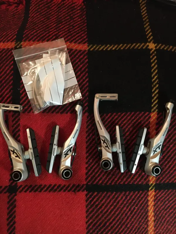

One last parcel received for the build before I head off for a bit - XT NOS.
