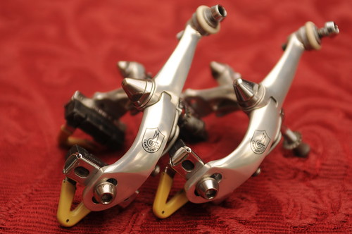

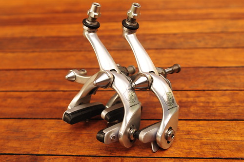

I was trying to work this very same thing out the other day & have drawn the following conclusions....
You are correct in that the later Monoplaners had the naked guides. They also have a completely different arm casting around the blocks. I personally favour the Gen 1 versions.
Gen 1
Gen 2
Athena - Interestingly the Athena groupset inherited the monoplaner when the Chorus adopted the dual-pivot design. These use a lot of compromised components
With the levers things get a bit more vague, the gen 1 Chorus levers were the same levers as the Record version and they had an adjustable tab which could be reversed to increase the pull enough to operate the Record Delta calipers, these always had the white hoods. The gen 2 Chorus units were the same as the then Athena units and they nearly all had black hoods.[/img]
Thanks AO.
I had noticed that Athena and lower groups had different shaped ends to the arms, but hadn't noticed it on the 2nd gen. Chorus, which will help sort the wheat from the chaff!
