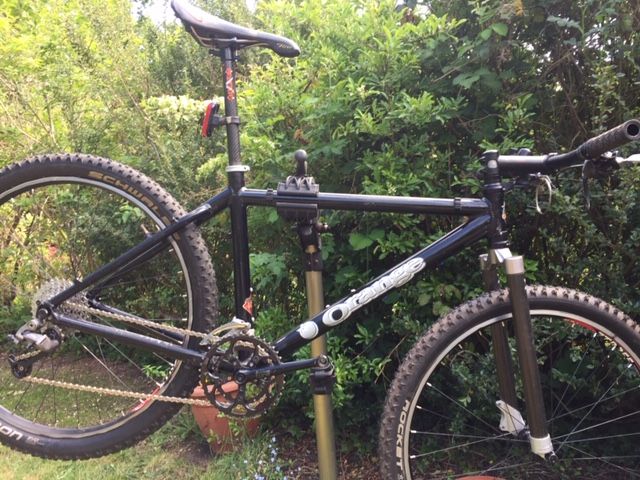

So the O2 now looks a bit like this......

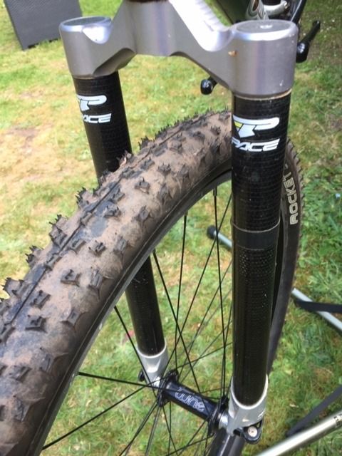

Pace RC30 - Tune Hubs and Crest Rims.

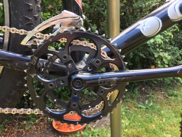

Tune Bigfoot and Tune rings on an XTR BB

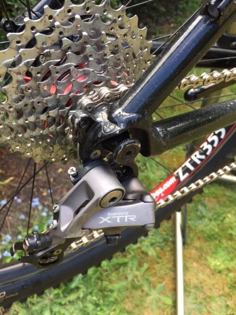

Found the RD-M950 I knew I had somewhere from the Sub 3

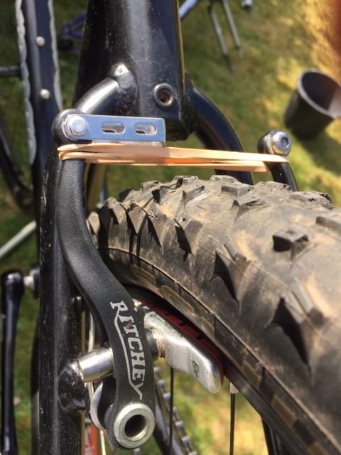

Also found the Ritchey V-brakes I was after.....
I have some RC30 V-Brake adapters somewhere - but haven't found them yet - so if anybody has some......

The O2 is pretty much complete and with Wadsy for a fettle. Just waiting on some Syntace bars to arrive and it will be complete.
Pics etc once it's done.
