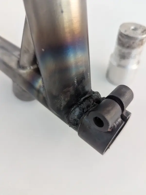

Picking up where I left off last year. I'd have loved to have finished this and put my end of year tally at a record (for me) 4 builds, but it proved to be a bit beyond me. I did close the year out by completing the 'other' Serotta off-road Pro-flex though. Very pleased with the outcome of that one and the quality of the @gil_m decals really finishes it off nicely.

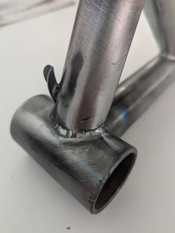

Just this one to go now. Repairing the rust hole and seat clamp crack.

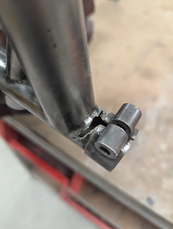

Starting off. The ends of the crack are drilled then the edges of the crack were cleaned back with a Dremel. Some of the metal was brittle so I probably cleaned it back further than I needed to. Now I've got a bigger 'hole' to contend with. 🤦🏻
Thinking I could probably repair this myself, I get some brass rod and a blow torch and give it a go. I quickly realized that even if I get it red hot, it's still not enough heat to allow the brass melt to fill the void. The heat just dispersed too quickly.
Best ask someone who has the skills and the proper kit.
A welder at work tells me it can be brazed but won't look pretty. I'd need to clean it up. He did make a really nice aluminum 'bung' to limit the amount of braze on the inside of the seat tube and effect the seatpost diameter.
Two bags of Haribo as payment and I'm ready to start cleaning up.
Not the prettiest, but determined to make this look good.

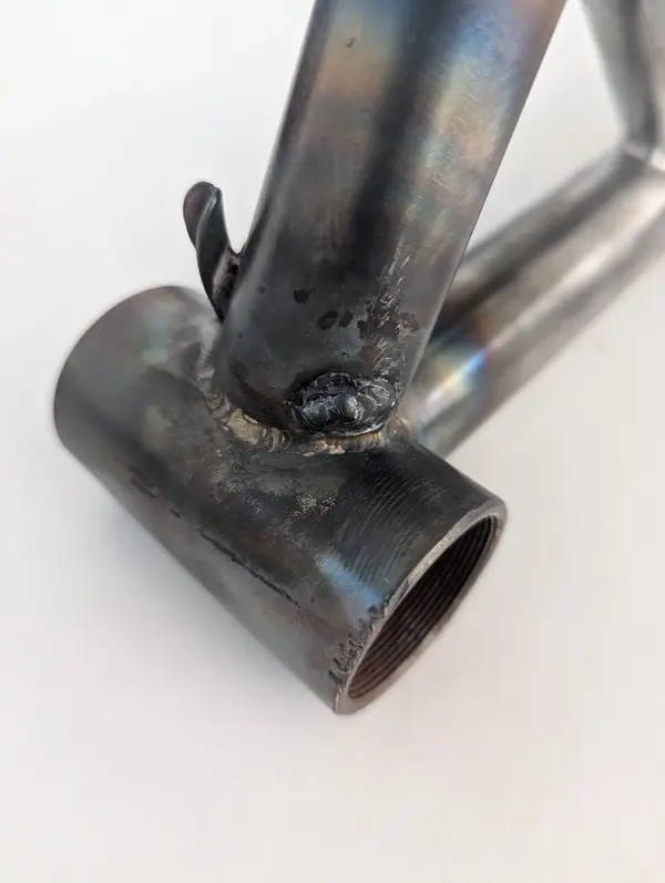

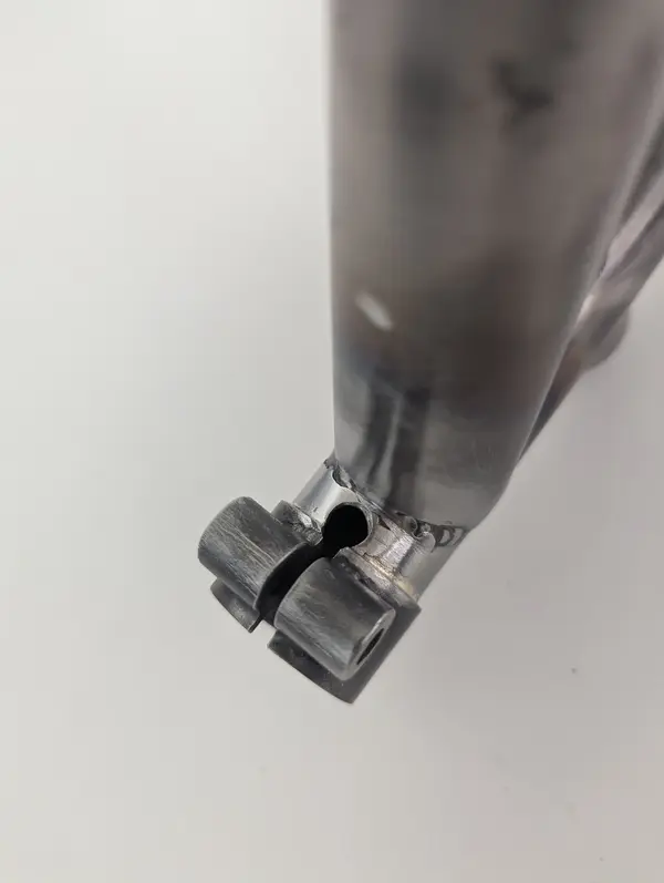

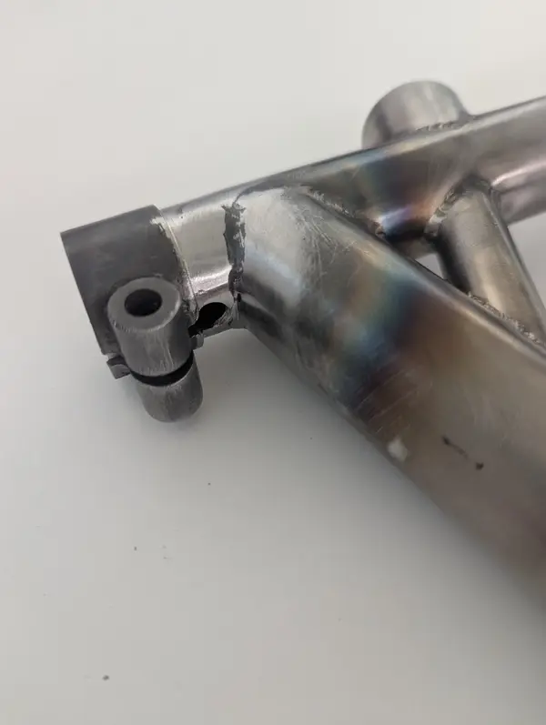

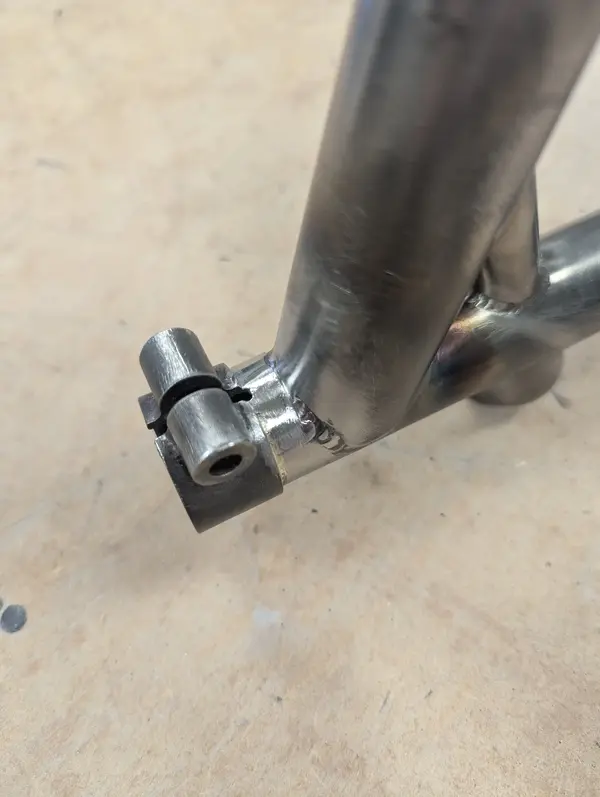

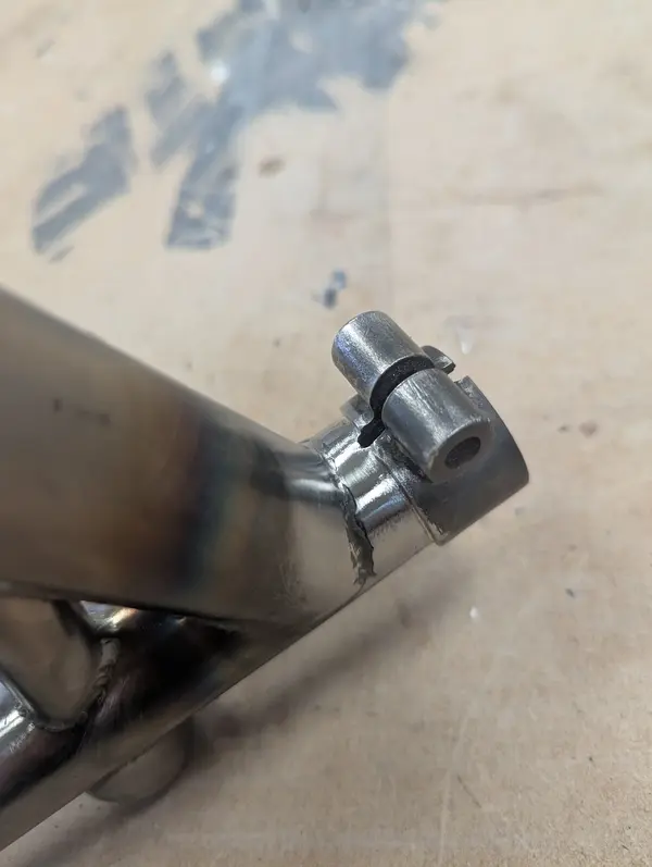

So. Some free time. Time to clean up the repairs.
Next to add the circular slot end.
and clean the filled hole.
There's still a tiny pin hole🤦🏻....but the bit that looks like a crack is a slight difference in height that I didn't want to file anymore through fear of causing the repair to cave in.
Looks like another bag of Haribo and a revisit to add a little bit more. 🤦🏻
