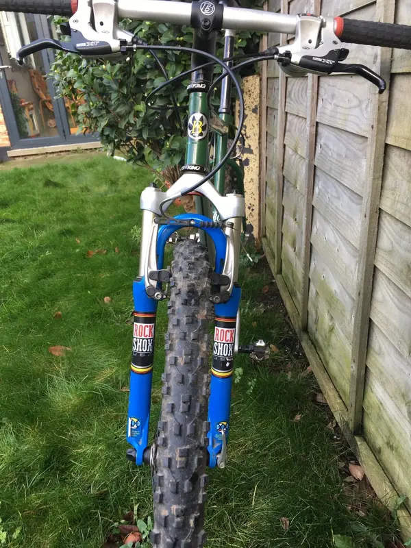

952 is from a totally different era where I thought bontrager geo
I thought we'd been around this and dated the bike to 94/95 ish based on the position of the front mech mount which was moved to take advantage of newer top pull front mechs around that time.
Either way, bar the removal of the two piece stays the race lite frame stayed in production pretty much unchanged until 1998 ish so I think that running M952 is absolutely in line with this frames era and a spot on match for the SID's which were introduced at the tail end of the '90s.
That's one of things I like about Bontragers - they didn't change significantly with the rest of the '90s fashions. Just a tweak to accommodate suspension forks, another to remove the heath robinson work-around for front mechs and nairly a sight of a 1 1/8 steerer tube.
Although I do curse that latter decision whenever I'm looking for a new fork for mine :)
Was this bike's dating conversation from a different thread? Reading this thread I thought this was 92/93 and the sids were a much later addition.
Sure bontrager didn't change much but I thought they were obsolete for much of those later years.
My mistake, saw the front mech mount and got confused.
Either way, given they didn't change substantially, I think it will wear the m950 well.
M900 or m737 would work well too, but m900 is getting too precious for a rider in my view.
