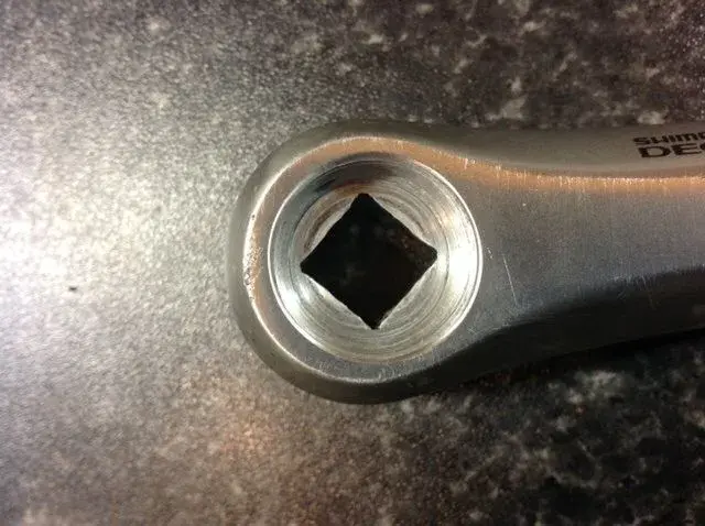

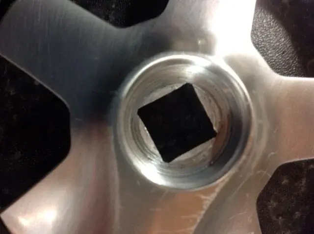

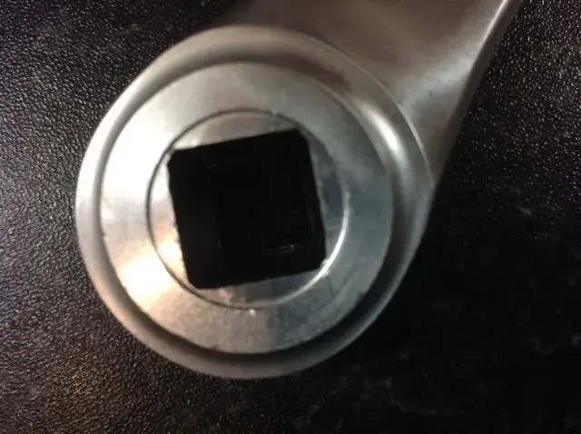

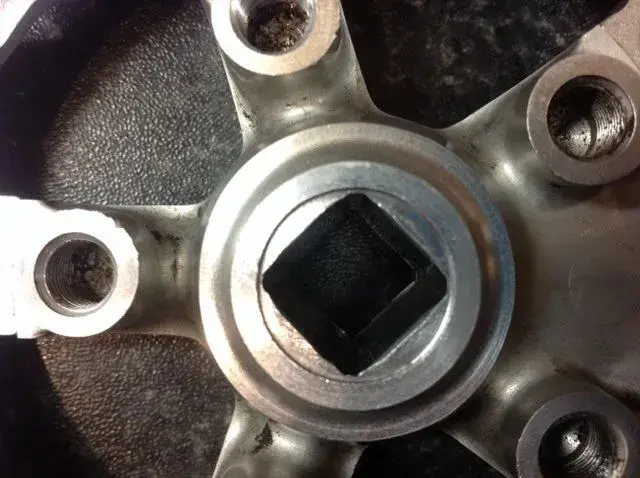

Pics attached. Are we sure they're knackered. Have even used them once after buying them !

I can see scratches that seem to indicate they are used, so it is irrelevant that you have not used them as it seems someone else has.
Have you tried it on other bbs? Tis most strange.
There second hand all right. I meant to say that I haven't used them since I bought them used from ebay.
I've tried them on my old bb spindle and a very old and very well used BB UN-51 spindle. is there any chance that they might fit any tighter on a new spindle ?? Or a non-shimano spindle ??
Axles dont wear out like that, they're all tool grade steel - your soft aluminium chainset tapers are knackered
