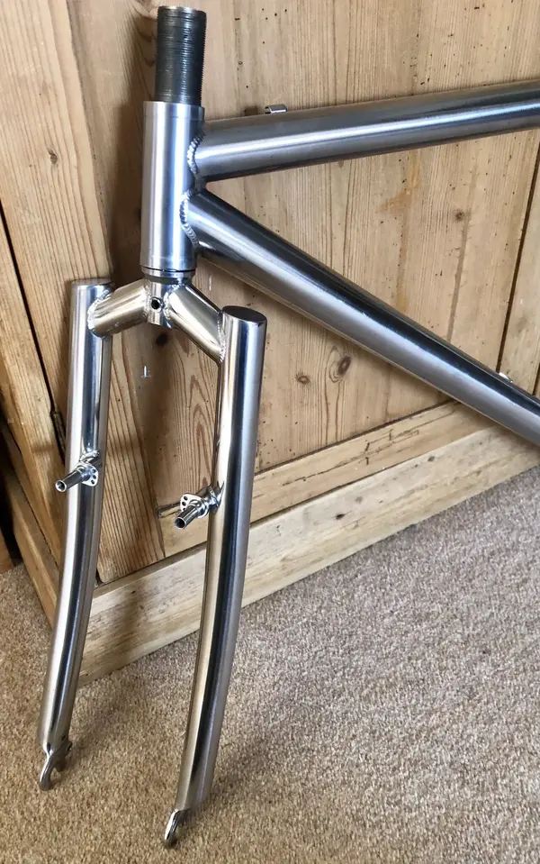

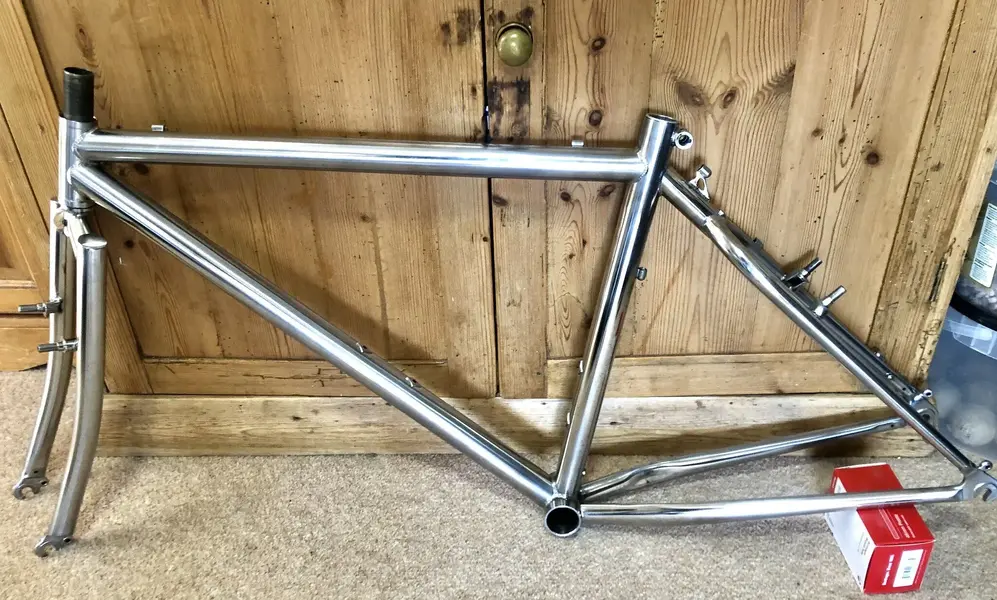

Having put my C16R on the back burner for the time being (still waiting for a nice set of Pace MXCD's to turn up somewhere) it was time get cracking with a frame I've had knocking about for a while. Actually I have two the same, a pair of Orange P7 frames, 94 and '95 versions and both 17". I've puzzled over for sometime where to go with them as I like the nickel finish but both had suffered from the usual rust spots all over and around the welds and bottom bracket area. I decided to polish up the '95 frame to a raw finish using the gt85 and spontex pad method then metal polished it to a high finish but my ocd kicked in and pondered on whether it would and rust and develop rust spot scabs again over time........ I decided to have the frame clear coated by a local sprayer who took it on and had a specific clear coat for it but to cut along story short was disappointed in the results..... its now waiting to be fully stripped back again and re-polished but have given up on it in the meantime.

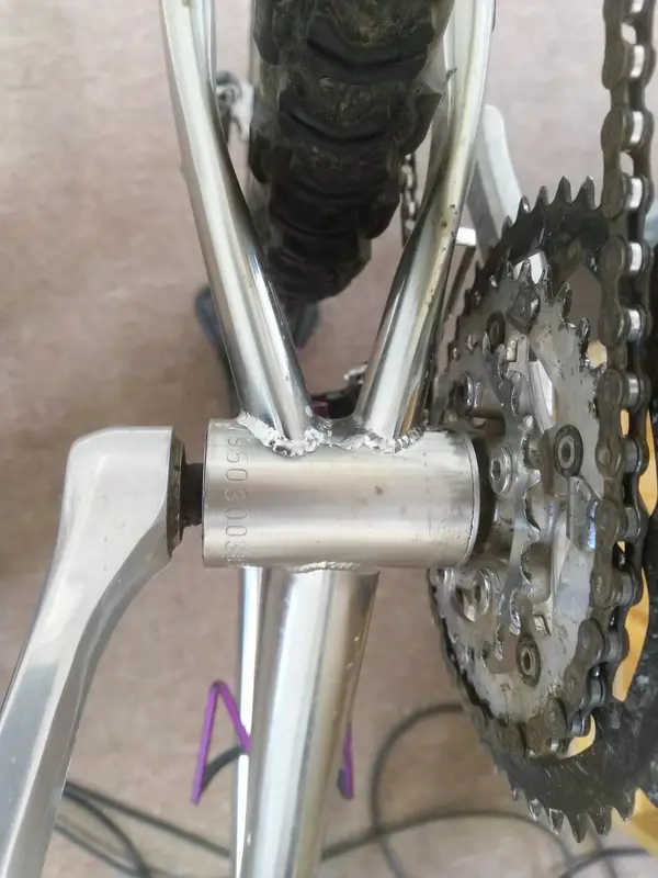

I now turned my attentions to my '94 frame ( A4040028 ) which wasn't too bad but was a bit tatty, scabby rust spots all over and the decals missing in places.
I'd polished and got rid of the rust spots in and around the forks and was going to do the same on the frame again but the old dilemma of it staying rust free and polished with the intended riding I had in mind started me thinking..... I wasn't keen on having to re-polish/wax it after every ride so decided to have it powder coated for piece of mind and longevity and not have the worry of it rusting in the future........ So of it went to a sand blasting and powder coating firm I'd found online who where doing bike frames. They have seen a big intake of bike frame requests and as their reputation had grown immensely popular in the two wheel world and looking at reviews over the last 12 months, my decision was made.......

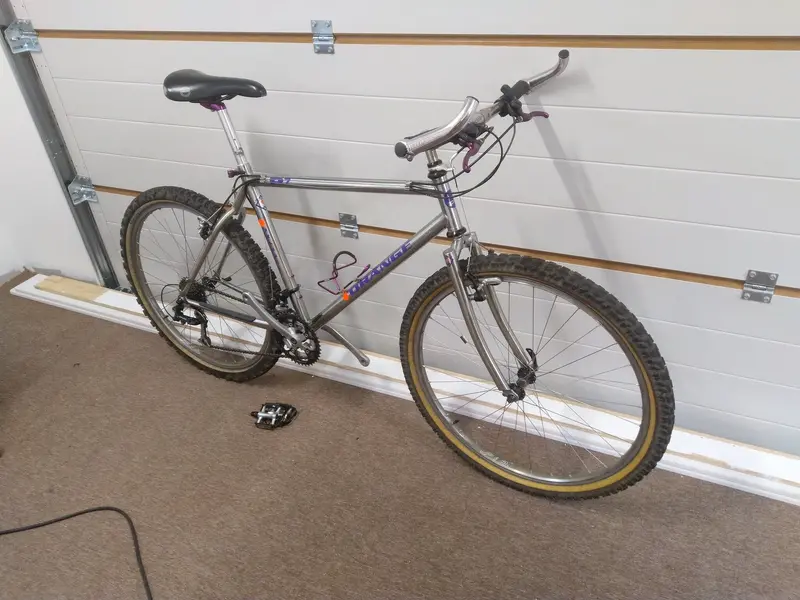

It’s a lovely finish but I want to ride mine without the potential rust issues in the future but that’s a nice build 👍. Here’s my ‘95 prior top coating it. A lot of time went into it but sadly it’s not looking as good now until I strip it all back….😩
