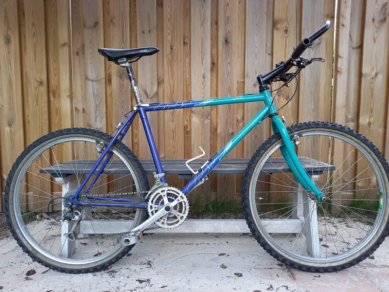

Picked this up today.
Apparently, it's Tange Cr-Mo and looks to be in relatively good shape.
It has a mishmash of parts hung onto it: stx-rc 3x7 shifters, deore dx front mech, deore xt rear and some very decent platform pedals :).
Deore dx wheels on Araya RM-20 rims and a pair of crackin' (literally) Tioga Psycho's..
Have to check the head tube dia to see if I can equip it with a set of Mag21's or Manitou M3's.
Gonna pimp it up for my gf for some gentle rides together, as it seems a tad too small for me.
There's not much info to be found about these bikes on the web: only some pics on a Czech site from a while ago of a similar frame with some different parts (lx).
Well, made a start closer inspecting and disassembling, but not much luck: lots of bolts are stuck..
The stem wedge bolt and the headset lock nut: stuck. The cassette lock ring and platform pedals: stuck. So, I left them soaking in good ol' WD40..
I did get the cranks off relatively easy, so I can start cleaning those. And luckily, the seat post also moves freely!
Count your blessings, I say!

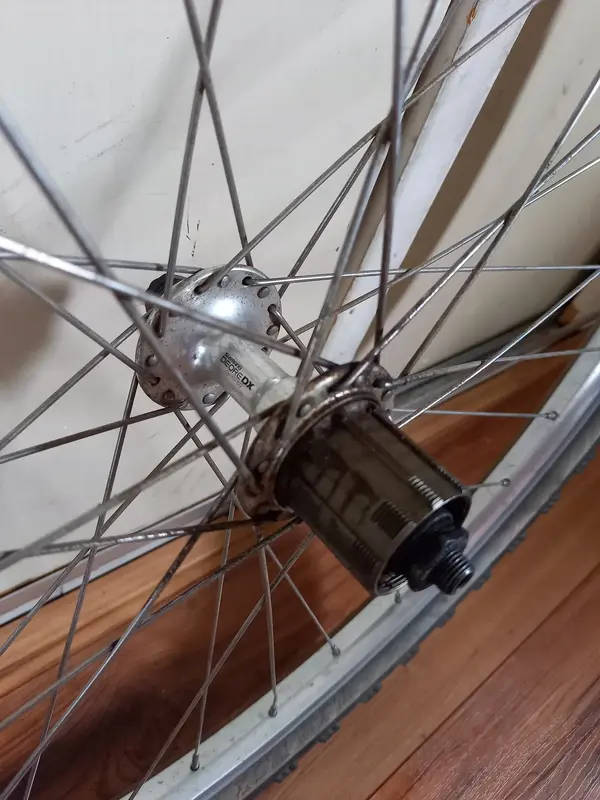

Well, the cassette lock nut gave in..
No movement in the stem bolt though, so I've poured is some additional WD40 from the lower end, when the bike was upside down; let's see if that helps..

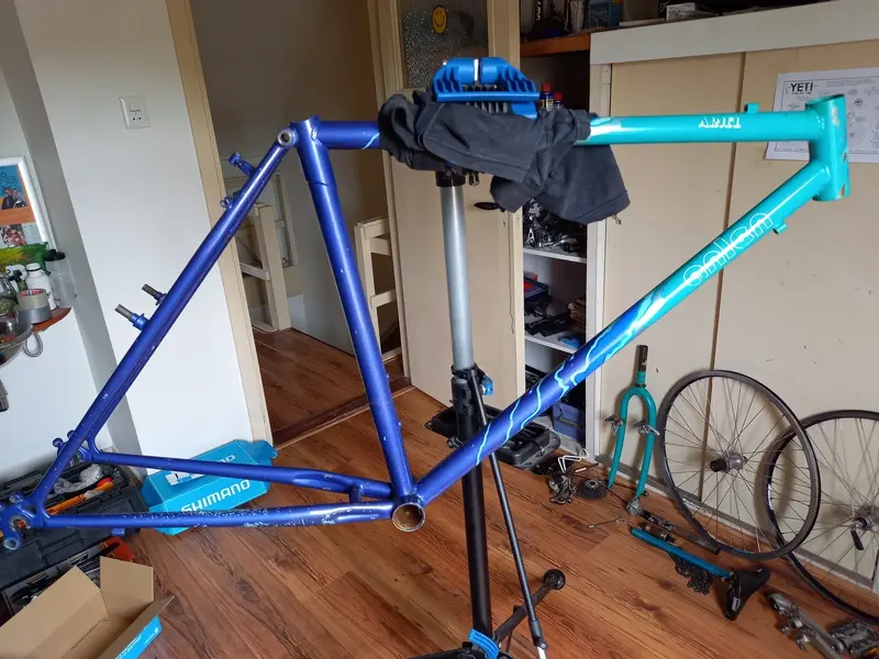

Stripped and cleaned:
Weighs a clean 2.3 kgs, ready to build :).
Decided to abandon the 8sp XTR m900 route, due to the wheels sizing, so it is going to be 7sp Shimano mishmash, XT m735, DX, STX (mostly like it was when I got it..). Still planning to use some turquoise bits though and to get the front suspended.
