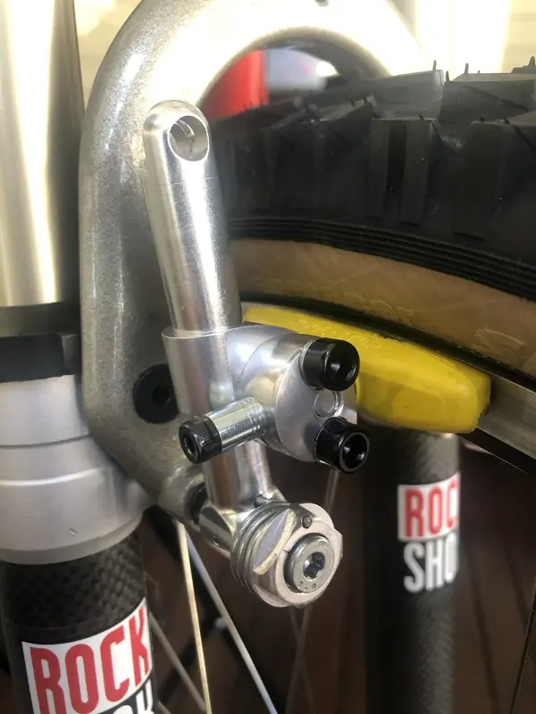

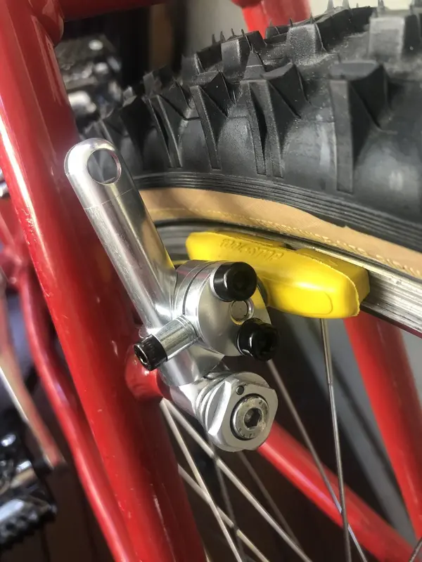

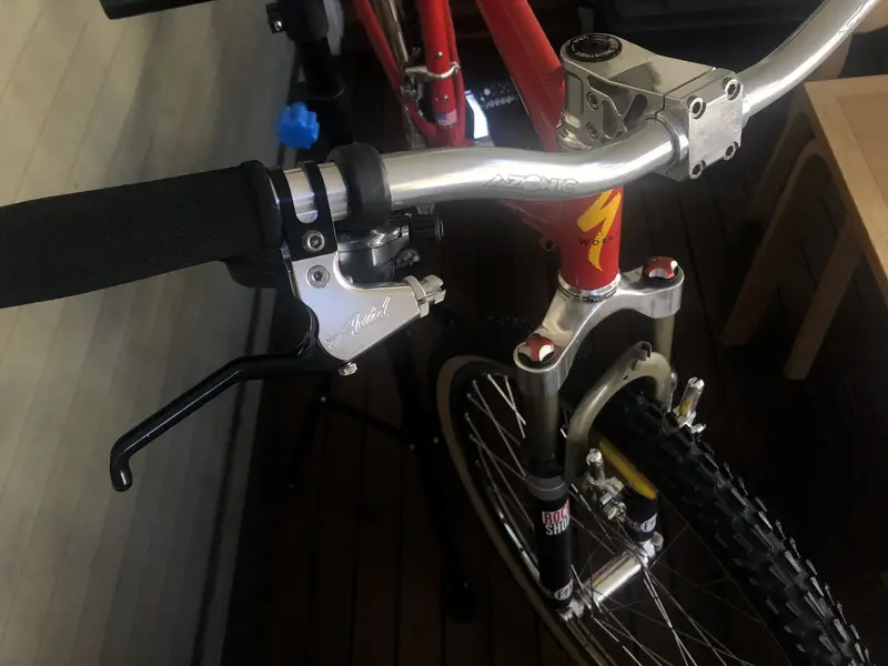

It's been fun noodling with stuff; making little changes and adjustments to things here and there. One I mentioned earlier was a little tweak to the Tri-Aligns. Mainly because I'd been wanting an excuse to use @danson67's excellent Pro Bolt recommendation, but also so they'd match with the levers just a little better:
A small touch maybe, but a nice one I think.
