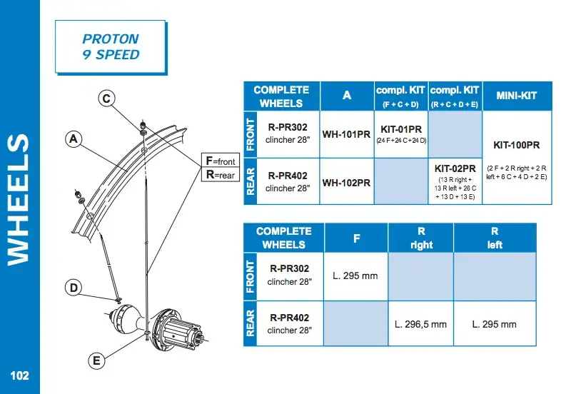

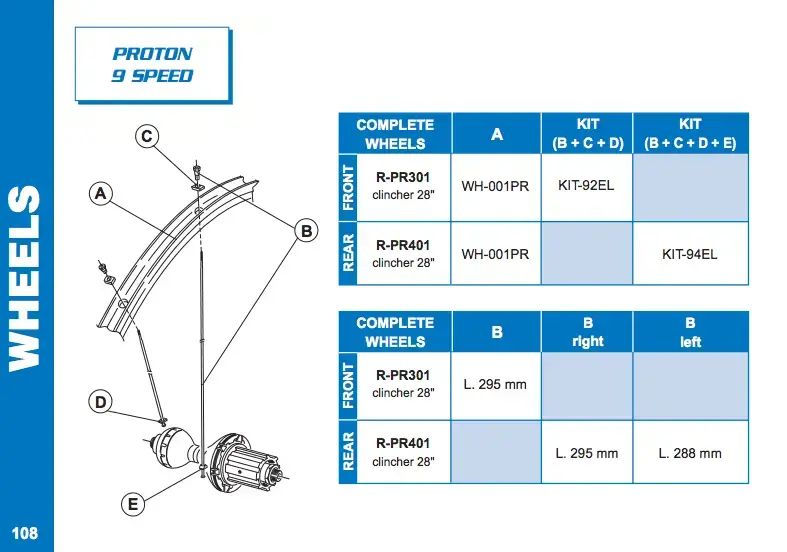

There's nothing obviously that flat middle section,but it looks like KIT-94EL or KIT-100PR is your one...only difference seems to be the length.
And with only 1.5mm difference, either would probably work OK:
