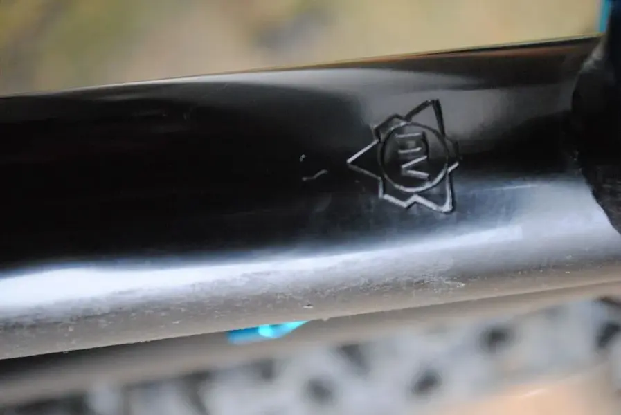

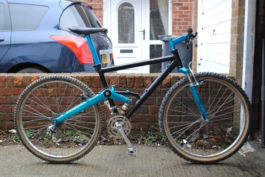

This looks like it was hung up in a garage some time ago and simply forgotten about, frame would have been unmarked too if hadnt been for a packaging howler of laying the bars against the frame... Its only a scratch and not too deep - no dents.

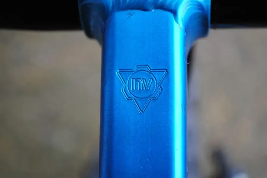

I was more than a bit surprised to find the frame is anodised - the bike not seeing the summer for many years has kept both the blue and black dyes in very good original colours.

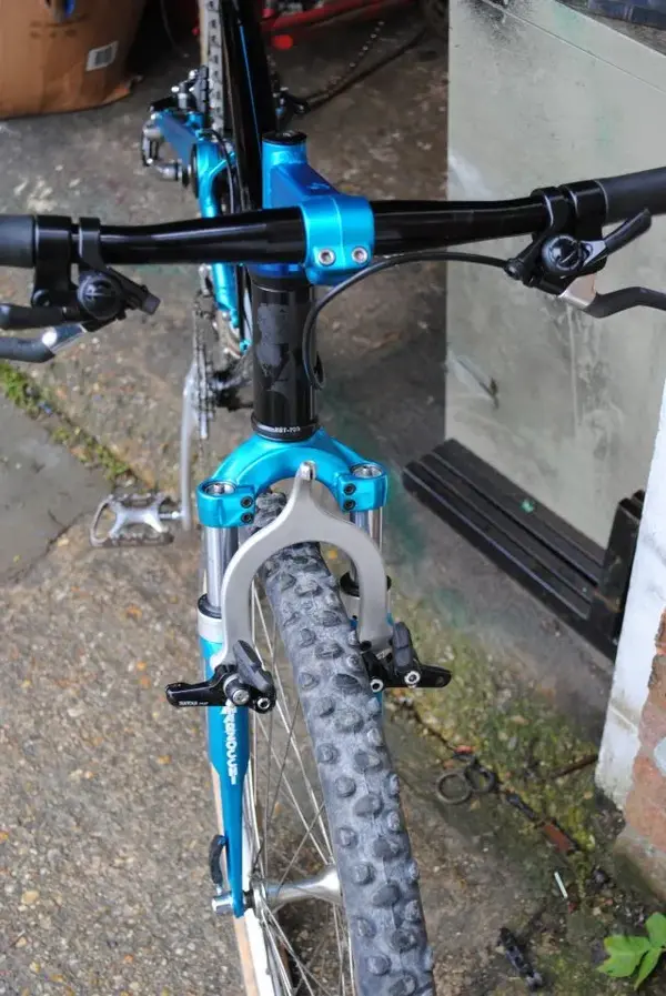

Forks still had air and could be pumped up with a Zefal, the rear shock, I dont think a tyre pump will do the correct PSI - any assistance greatly appreciated here.

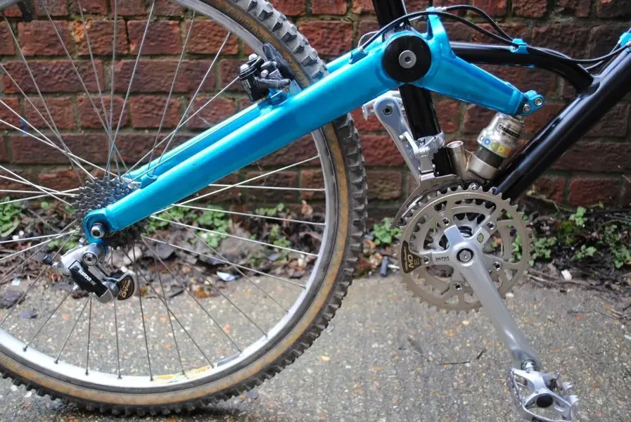

Drive train is and almost complete Suntour XC Pro microdrive. I havent seen this in the flesh for nearly two decades. Suntours' last stand before Shimano took it all. Sadly missing the front mech but the STX supplied looks the part for now. Rear mech is a great find with its labels still on.
The grease guard BB is dead as unfortunately its been ridden loose and has badly groove on ecup - however, it can be saved. So for now there is a UN52 in its place.

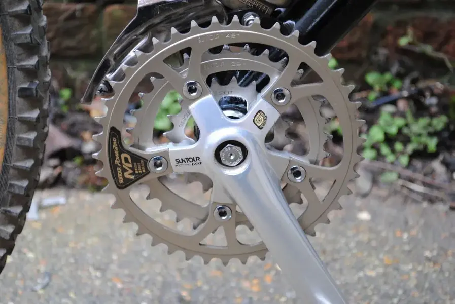

Chainset looks great from the drive side and has the usual chainsuck marks on the inside but I doubt the whole bike has covered more than a few hundred miles at the most.

Looks the part!
There's some details on the Verlicchi/Iron Horse bikes here: http://forums.mtbr.com/showthread.php?t=81309
It includes the later Kona models as well. I have a vague memory of going to a petrol station with an Iron Horse and an early LTS (with an Alps shock) to pump them up. Might've been to get some choccy milk and a packet of Hob Nobs though...
Ice blue cool. Suntour groupset is nice isn't it? Works surprisingly well, just give it a try. Shame about BB.
Nice :)
You'll need a proper shock pump for the rear shock, it probably needs about 200psi in it.
