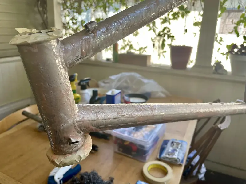

Good job, you might want to have a go all over with MAAS especially in the welds (with a toothbrush) just to help hold back any tiny spots of rust from blooming, they will eventually but will just take longer with the corrosion inhibitors in the polish.
One effective way to really delay this would be to soak paper kitchen towels/tissue with evaporust and wrap around the welds covering them in cling film, before cleaning off with white spirit/petrol then apply the MAAS. In California it should never rust again.
Already got the last of the previous tube of Maas on hand Peach! And another on the way!
That said, the toothbrush into the welds, and the evoporust-soaked towels, are both brilliant bits of advice.

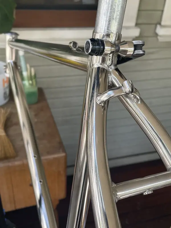

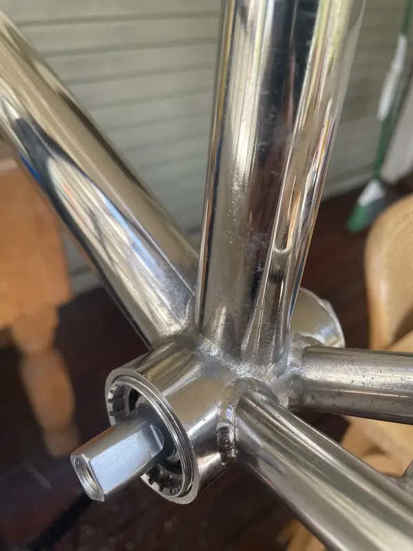

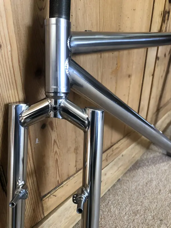

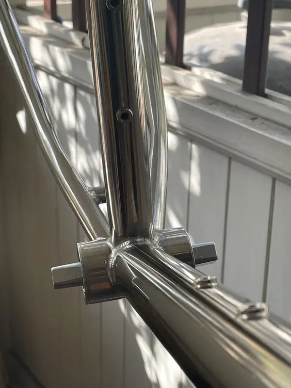

Time for a soak in some Citristrip, dabbing a brush over the stripper every few hours, and then left overnight to do its thing.
Well, that escalated quickly:

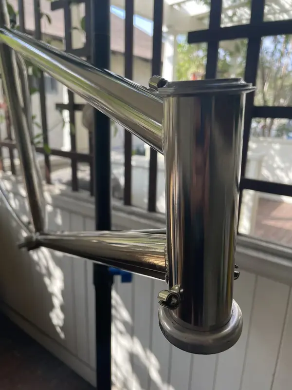

Very pleased, and I still haven't touched the Maas!
o_O
Just a wipe over with paint stripper after wash:
tempImageKpU4Ja.jpg tempImagesXlXCA.jpg tempImageNxWal5.jpg tempImagecUt6M1.jpg
I'll give the nooks and crannies another going over with the stainless steel wool and WD40, followed by some of Peachy's trick's. Then its polish and buff time!
Hopefully the mix and condition of parts combined with those little imperfections dotted about the frame will keep the finished bike from looking too pristine...
I'm sure the trail dirt and LA smog when it's built-up will take care of the rest!

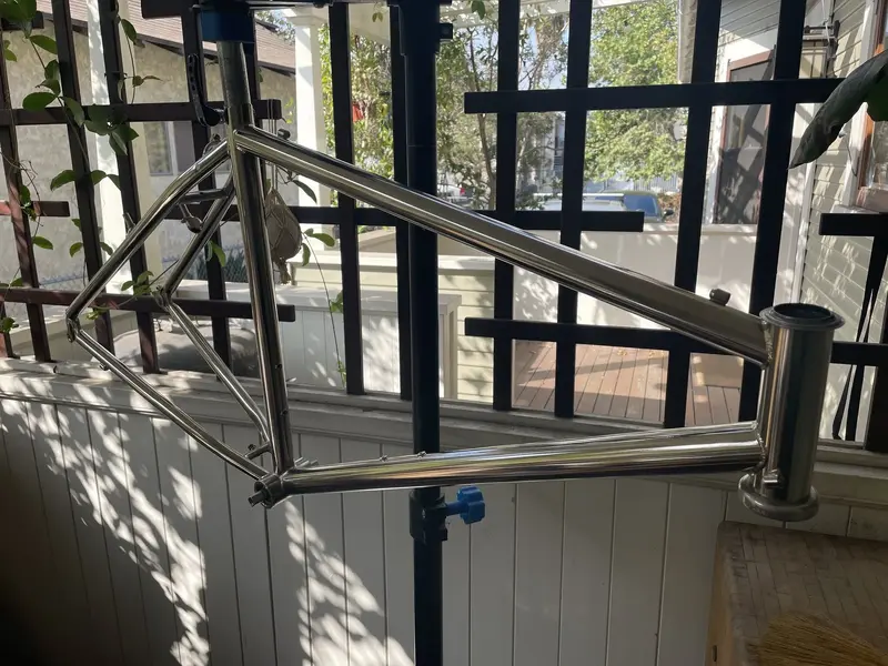

So these have clear lacquer over the polished surface? Asking for a friend who has a ´94 Team Issue and difficulties removing rusty freckles.
Wow! That's looking brilliant mate
They do, as do a lot of the nickel plated frames, apparently. Lots of people on here have posted threads detailing what's involved in getting it off, and I just followed the advice in those. The GT85 and Spontex route is so simple, and worked so well.
Even subbing in WD40, because you can't get GT85!
(Side note: I was browsing my 1996 Mountain Bikers Almanac the other night, lol, and noticed they featured a can of the stuff in their buyers guide. So what gives? Where did it go? Who removed it from the US market?!)
That said, I know some people have had a harder go of it than me. And maybe that's because the damage was worse, or they wanted to do a more thorough job? Or maybe I just got lucky? Because there really wasn't much of anything left to remove after the initial rub down. I probably could have even skipped the Citristrip step, but I'm glad I didn't. It definitely did a nice job cleaning up whatever was left and adding some extra shine in the process too. Using the after wash was really the key to that part tho.
Anyway, it's definitely a very rewarding process. Just zone out for a few hours with some tunes on, or the football in the background, and make peace with steadily attacking the pitted parts little by little. I find moving onto another spot nearby when an area is particularly stubborn and coming back to it later does wonders for the will power and general mood!
A lot of frames really don't need a lot of work to turn around. This one looked like weeks of work out of the box, whereas In reality, a couple of very pleasant weekend afternoons was all it took to get it looking decent.
Tell your friend to get rid of that lacquer and stick with it!
