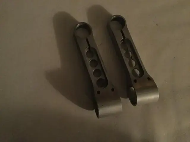

Does anyone know if it’s possible to 3D print from aluminium ?
I have a couple of items I need replacing on my bike which will be impossible to source now.
The only other option would be to Have the parts cnc’d which might prove very costly.
If anyone has any experience with 3D printing with aluminium of cnc machining please left me know.

Thanks for the reply. This is what I need making.
Aluminum is rather unusual for metal laser sintering. I guess the machines exist but the most common metals are: stainless steel, titanium, Inconel. It is waay more expensive than CNC machining. I got a quote once for a head-tube badge (Nuke Proof cockroach) to be printed in Stainless (cheapest) and it was over 150$ for a small flatish head-tube badge. Since the original parts are CNC machined I think that CNC machining would be the best option. Besides the surface finish of the CNC parts would be way better. Either way you will need a 3-D model of your parts.

Send me a drawing of the stem.
