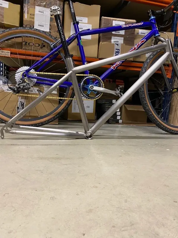

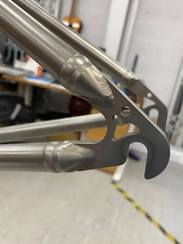

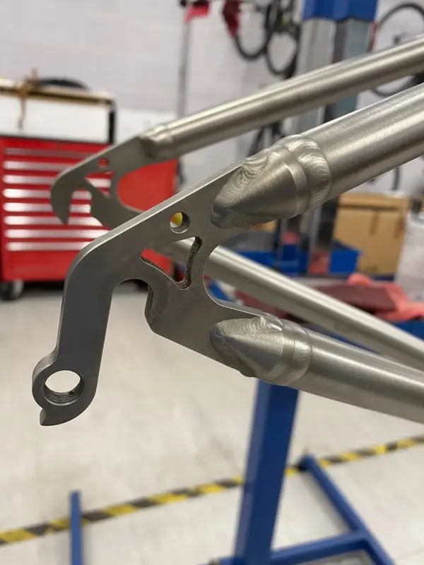

The frame was overall in great condition straight with no dents, chain suck or heavy scratch's... main offenders being oxidation on the bottle cage boss', residue and marking from where the head tube was originally painted and the original decals, some marking on the chain stays but otherwise in excellent shape, not a minter but with a little effort would clean up lovely.

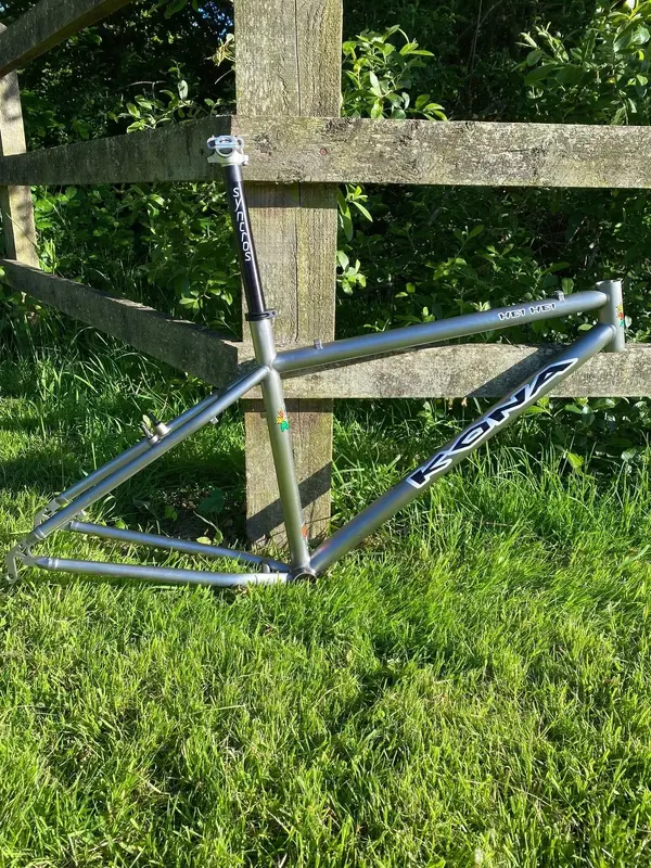

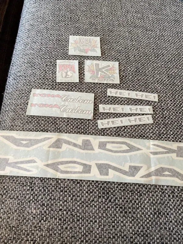

My favourite Kona decals are 96,97,98 so in my mind the plan was to run 98 decals to keep it as close to 'period correct', turns out Steven (original owner) had a similar vision and had previously bought the decals from Gil and never fitted them so this was a bonus I wasn't expecting when I collected the frame. i'm hoping the decals have survived in their original packaging over the years but if not I will replace with a fresh set from Gil.

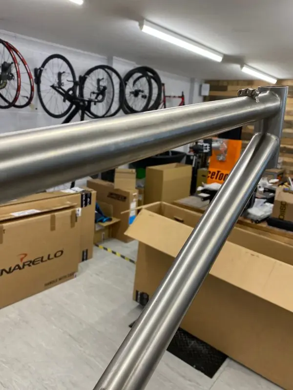

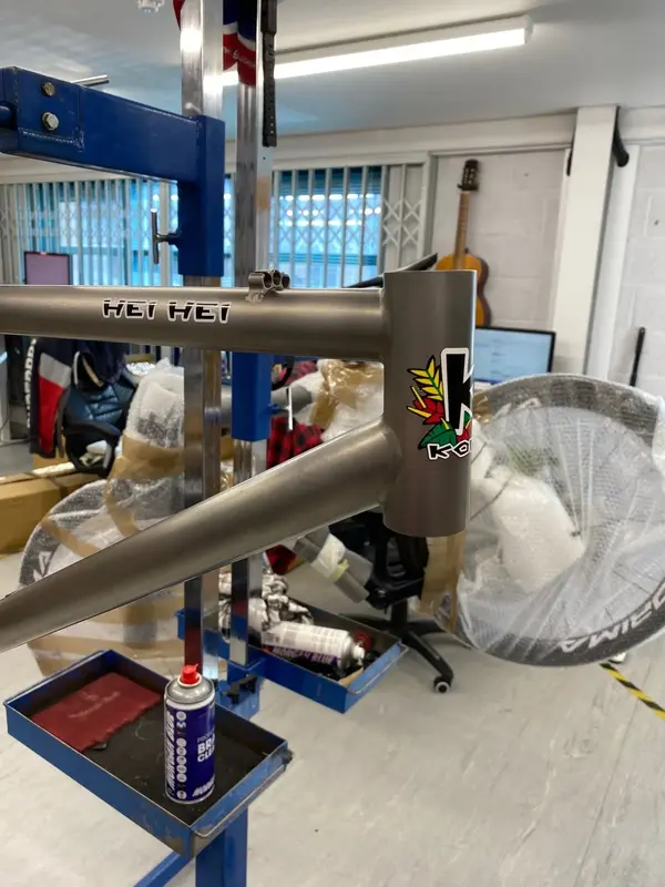

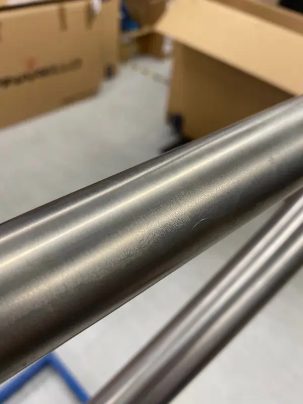

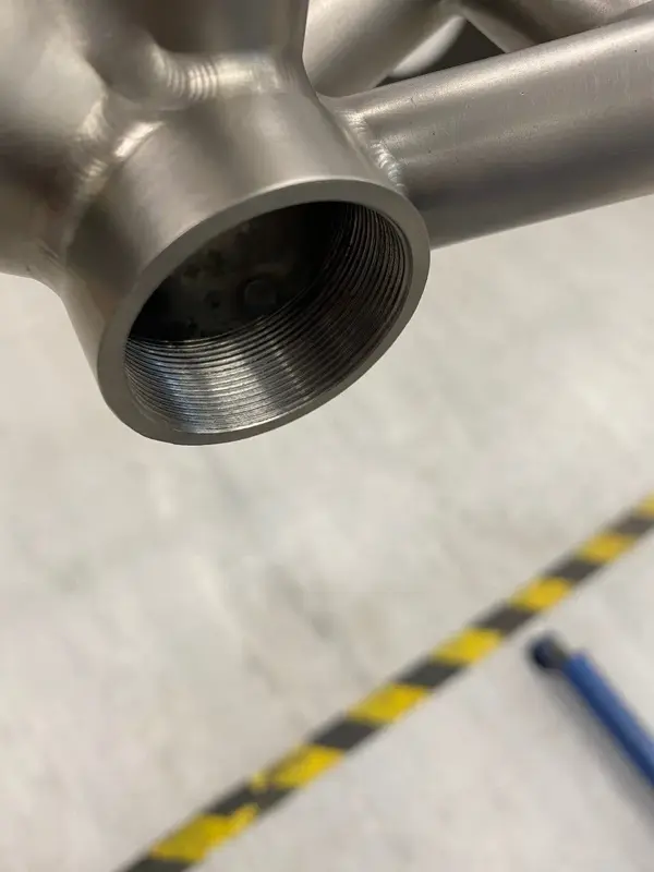

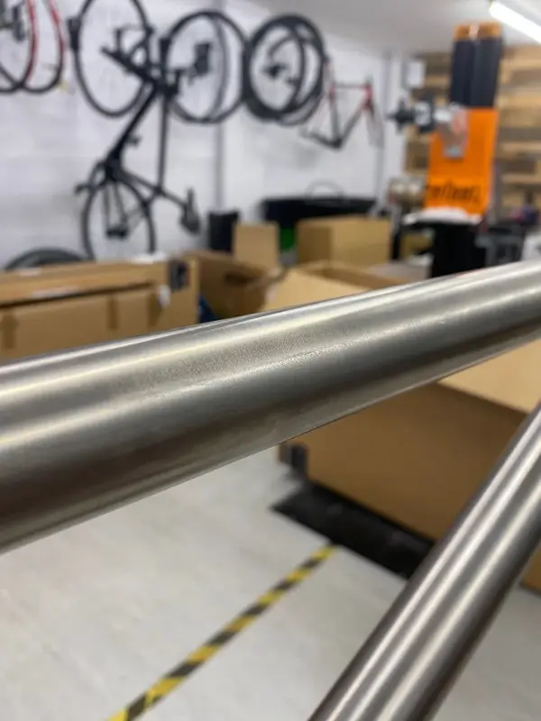

I like the brushed finish on Litespeed's current frames and given the finish was in good shape but needing a light tickle to clean it up I decided on gently brushing the frame by hand using 3m scotch brite pads, again Pip's advice pointing me in the right direction by brushing along the length of each tube as opposed to around the circumference of the tube. The residue & marking left on the top tube was quickly remedied as with the bottle cage boss's and overall finish on the frame. To the naked eye the frame is slightly lighter in appearance now but overall im happy enough with the finish to start fitting the decals, looking at other 99 Hei Hei'si think they had a brighter finish but will stand corrected if that's not the case. I will build the frame as is for now and if im still not 100% with the finish will address this at a later date. I have chased the bb threads and bottle cage boss so can fire into the build once the decals are on.

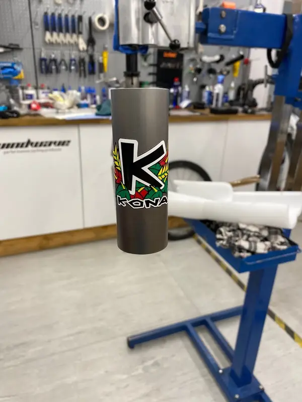

small update as have fired into getting the decals fitted and am almost finished.. Its looking better for the decals 100%. Testament to how good the decals are that Gil produces as these were a good few years old and have gone on perfectly...
just the downtube decals to go.. the ones m least looking forward to!

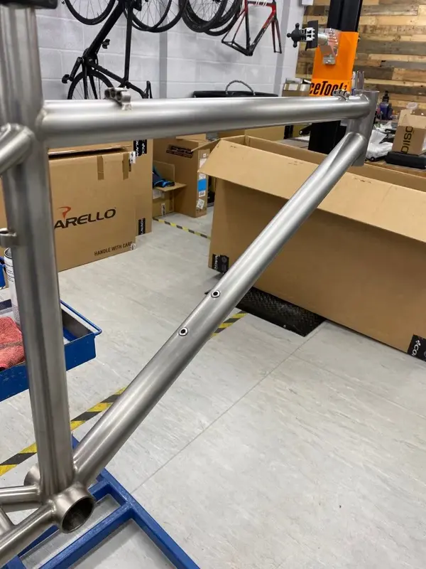

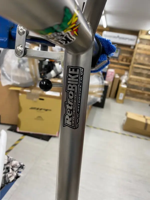

dt decals are on as is a homage to RB...
not completely happy with my placement of the 'Kona' decals as they are sitting to high on the DT however it will do for now...
that's enough for today, off for a spin on the Explosif..
