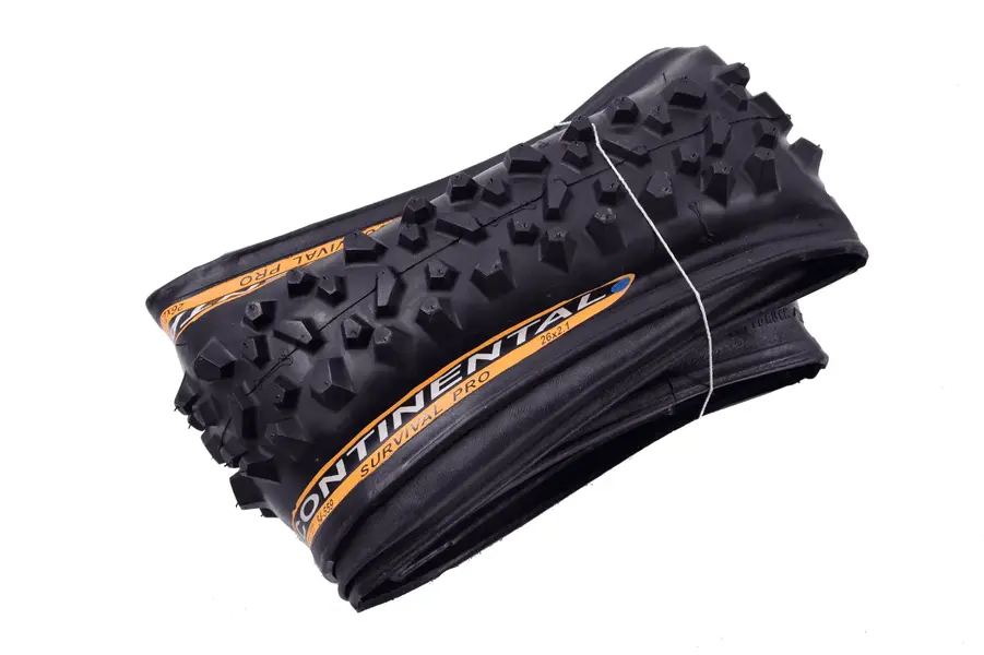

Oy....I'm working on it. It is down from the garage hanger at the moment , just have reached an impass with tyre choice. Would like some non tanwall grey or white tyres but the only thing avaliable are 1.95 Kenda's and need 2.1's really...any idea's?

I have to agree this is probably the first bike ever that looks far better wearing black walled tyres, so much so amber / skin walls would be plain wrong

Yeah, I agree with you spud on all counts. It will be my first retro without amber walls, I have been looking at Schwalbe Rapid Robs with the white stripe.
