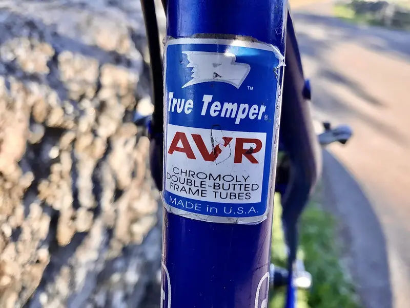

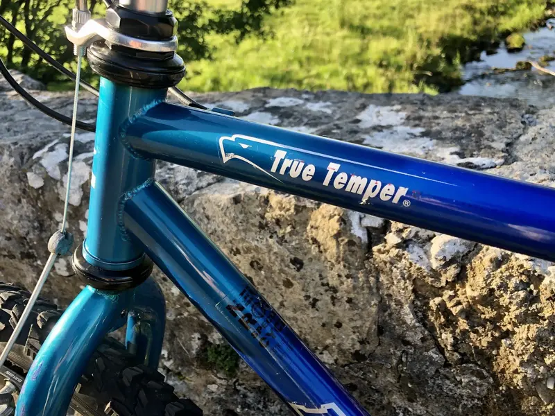

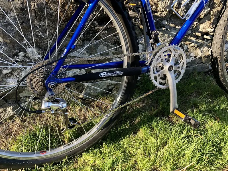

So having had it stripped down and cleaned , the list of what was needed began….. headset shot, bottom bracket rough with play, brakes seized on canti bosses, cables all needing replacing, chain shot, cassette in a bad way but on the plus side, frame and forks where good, welds all fine, original paint and decals though it had been touched up in places but ok, original bike shop label, original bars and stem, SDG saddle and some mis matched wheels but running smooth and true👍
I apologise as I’ve no progress images whilst things moved on other than the final build and first outing on it…..

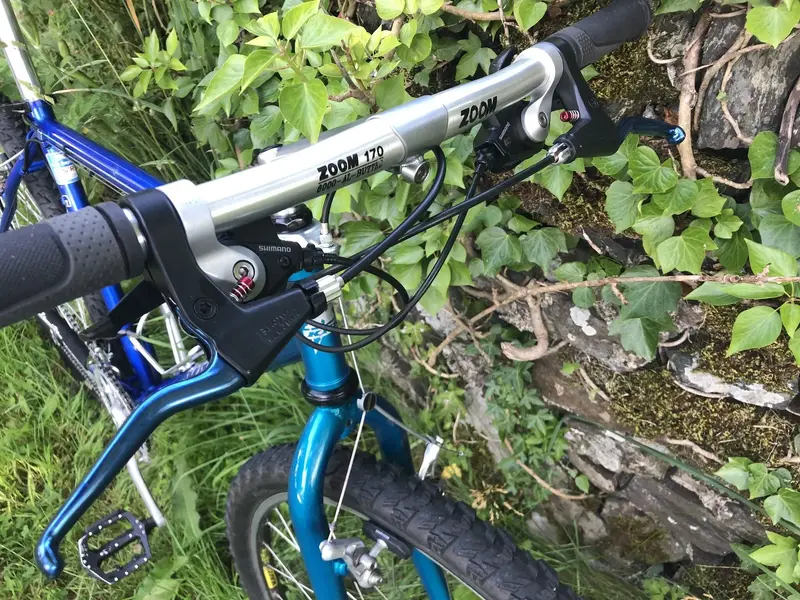

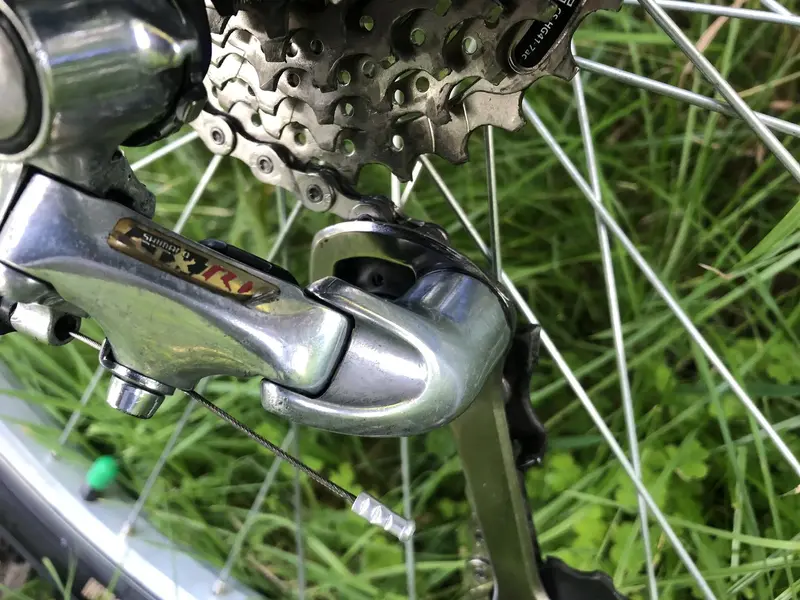

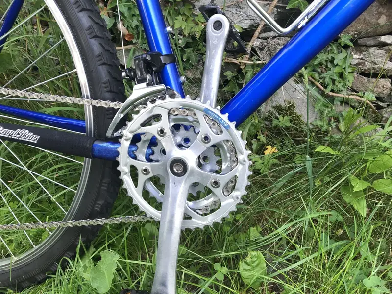

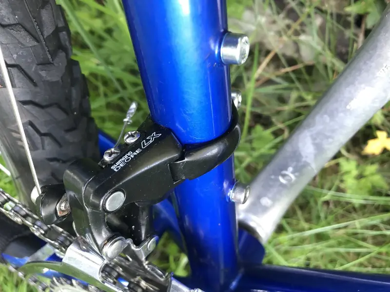

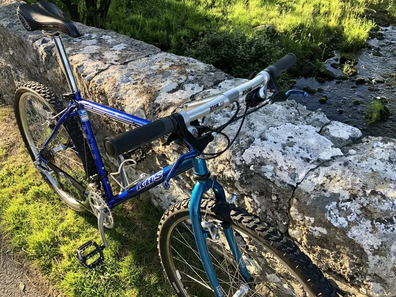

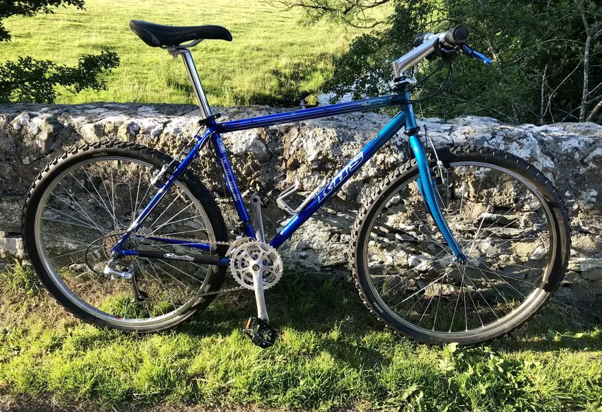

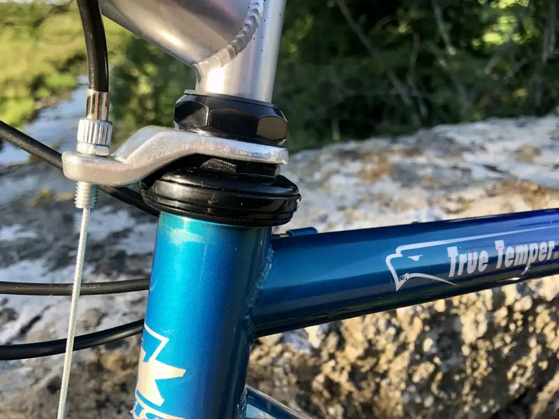

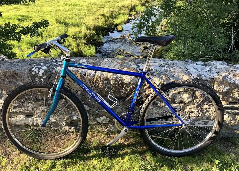

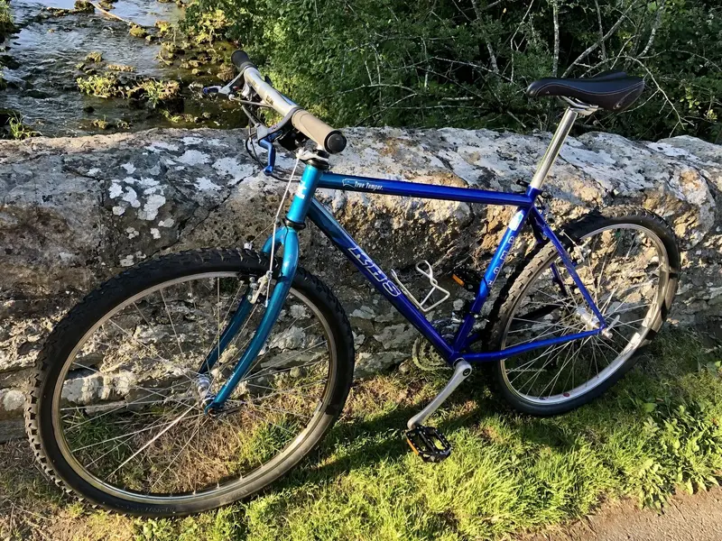

So after a good overhaul, full strip down, clean, new Tioga headset, swapped out the bottom bracket for a smooth with no play shimano un52 bottom bracket, fully re-cabled it, fitted a new chain and cassette, replaced the cantis and added some funky blue Dia-comp brake levers it’s turned out I think. Rides so well too, pretty impressed by its True Temper tube set.
