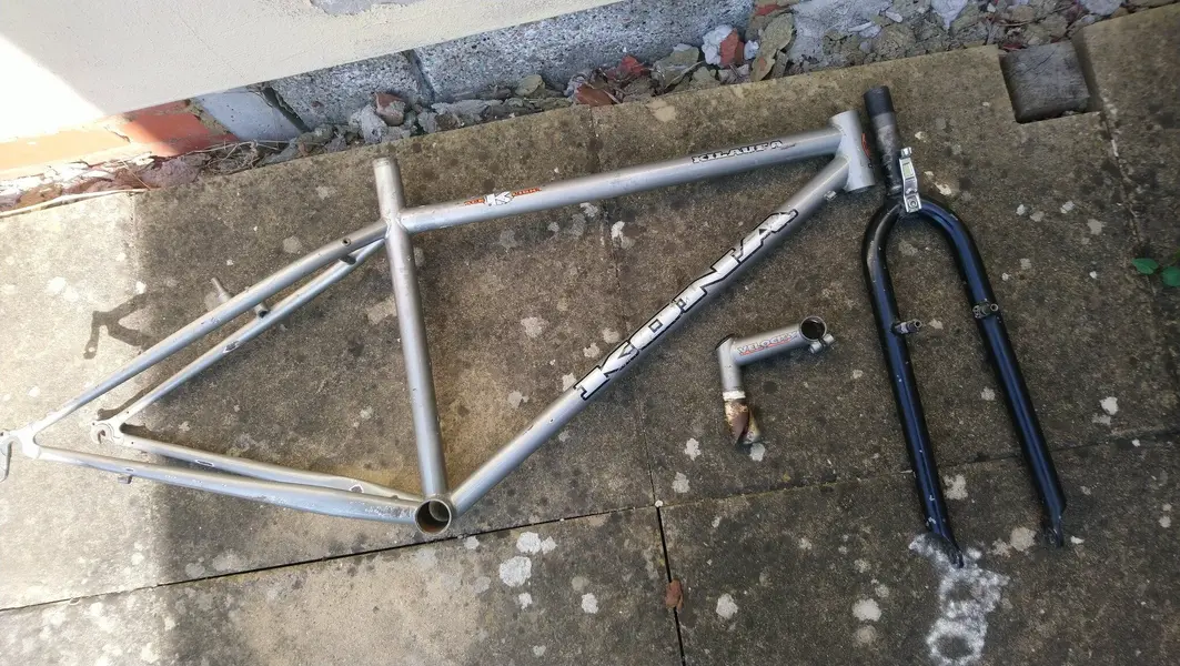

I picked this up the other day from @Neilios on here, he very kindly threw in the stem and a few other bits, thanks Neil. 👍 😁
This is going to need a repaint and I'm not 100% sure on colour or build direction yet.

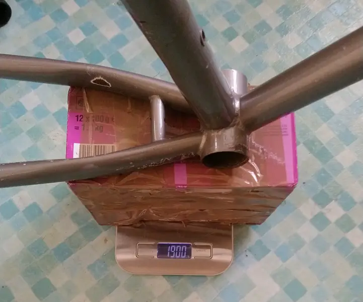

The frame seems to be exactly the same as my Explosif? That's a later 94 one without the Ultrastrong down tube. From what I can tell the Explosif was a full Tange frame where the Kilauea had a more generic 4130 rear triangle. If anyone can confirm this it would be appreciated.
It's pretty light at 1900g, I might have to strip and weigh the Explosif to see if there's any difference.
My builds usually go together quickly, this will be a slow burner, so I'll try to document it a bit better than usual! 😂 _20220430_105211.JPG
I'm looking forward to seeing this get some love. Glad you had a fork, it came to me with some RC35s on it that I needed for a build for my wife.

I dismantled the Explosif this morning because I was intrigued and wanted to know. _20220501_101300.JPG _20220501_101324.JPG
The Kilauea is 4g lighter, I think that pretty much confirms they are the same frame. The tubing diameters and flaring etc look identical.
