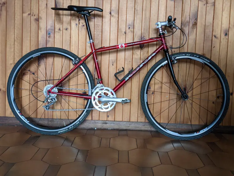

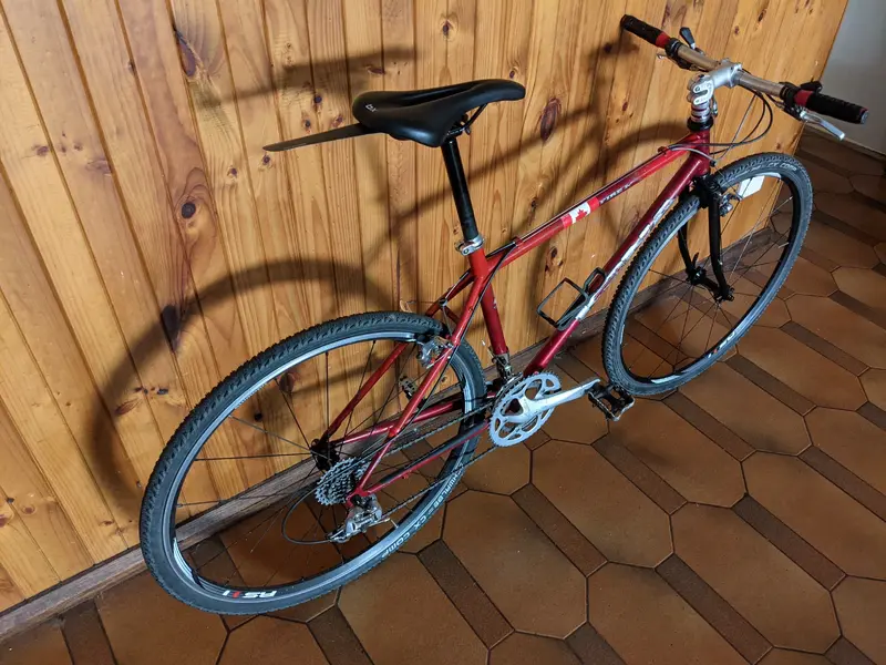

my approximation of the geometry was actually not far off my own 2009 masi speciale cx, though a much shorter seat stay and the top bar runs lower to that, and with a bunch of previously retired parts sitting in my parts bin at home, i just needed the brake bosses moved out an inch, and a new fork (surly long haul trucker, $35 from ebay).

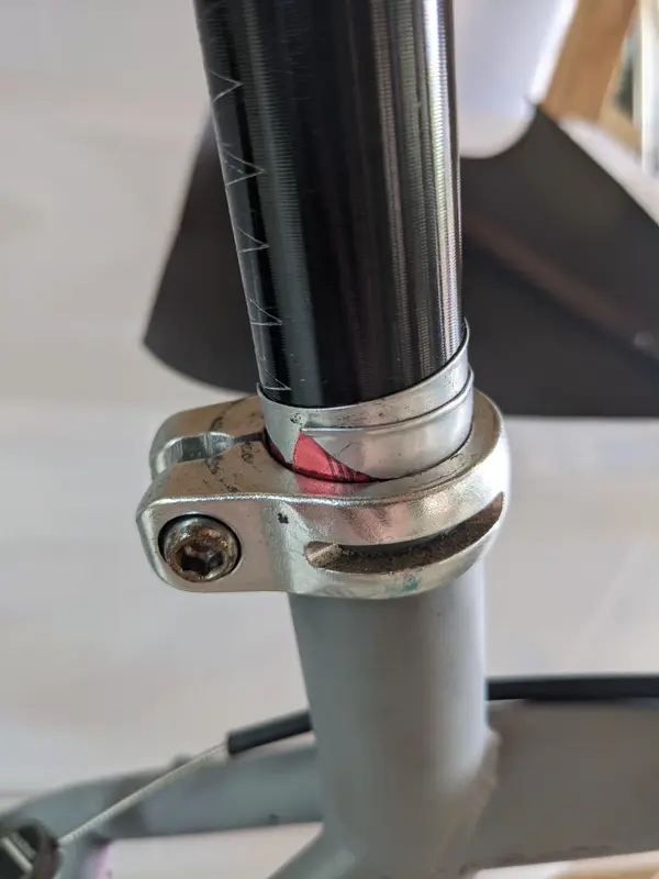

the 26.6 seatpost was an oversight, of course and was my sticking excuse for not finishing it _much_ sooner.

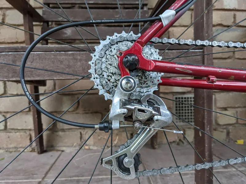

still to come is pulling the hubs out of the old 26" wheelset ( theres an alivio parralax rear hub in pretty good shape, and the 7 speed freehub will be reunited with its stx/deore derailleur and shifters too), but for now it's got some hand me down shimano wheels and 35mm schwalbe cx comps on it

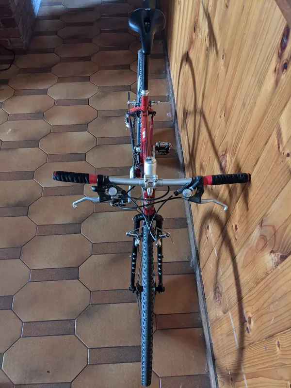

i did put some drop bars and a long stem on it for a quick look and it would make a menacing cx/single track machine too.
so this is what you get from a 16" Fire Mountan with a bit of brazing, a lot of elbow grease, acces to my old parts bin, a few bits off ebay, and a set of shims cut from a beer can. still to come is a suggestion to send it away for a powder coat and new decals, but for now its back in the original owners hands fully functioning and riding like a modern gravel bike.

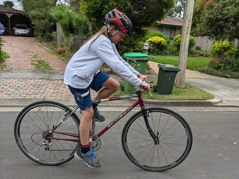

the sizes of modern bikes is pretty apparent here - my son is 11 and a handy mtb rider himself, fits this bike like a glove. my mate is still as 6'2" as he was in 94, and i suspect his 13 year old daughter might have just got a new/old bike...
what do you think? have i given an old bike a new working life or have i butchered a classic?

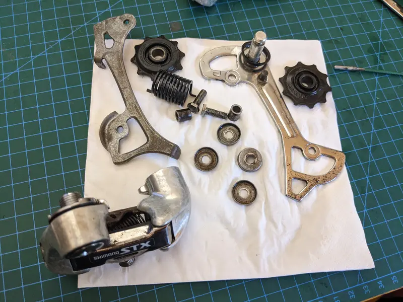

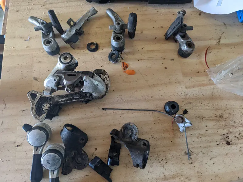

tried to use as many original parts as practical - elbow grease mostly, but that beercan shim took much longer to think of than i care to admit.
the original fork - a project two with velocity stem - are now oficially retired to the trophy wall (well, the wall of mates workshed at home)

as for the drop bars, they did make a good look IMO, even if they had the boy at full stretch
