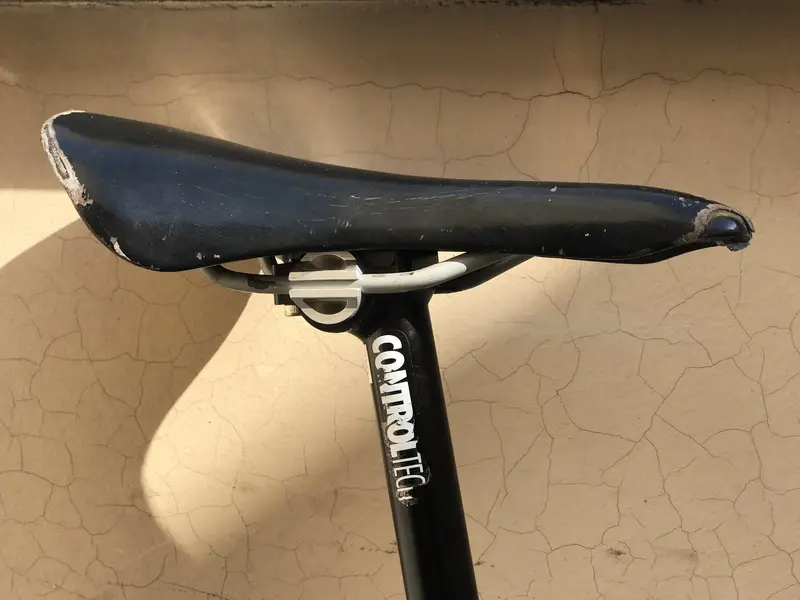

-It’s got a controltech seat post and Vetta SL saddle which I remember being very excited about as a kid!

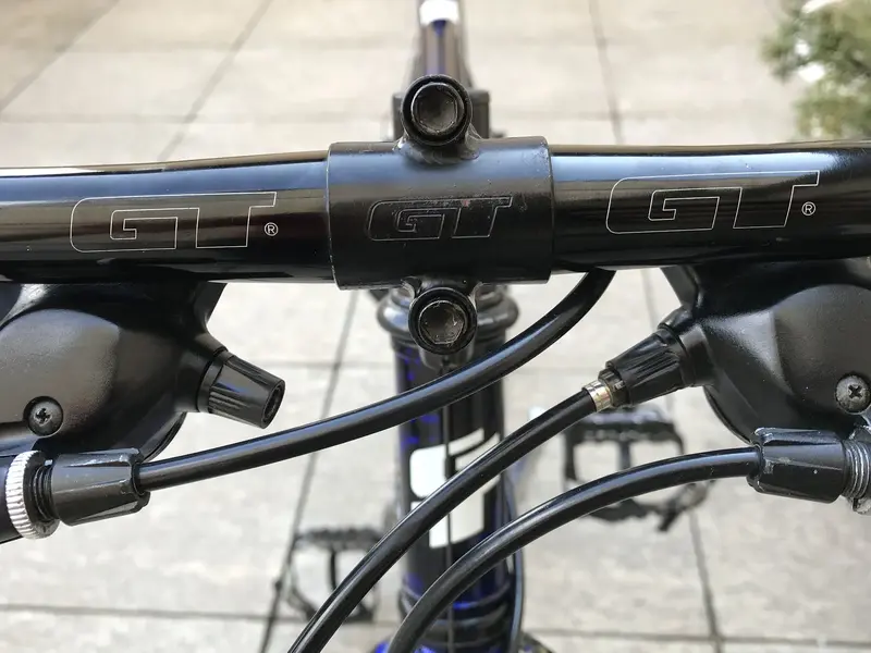

-It still has the original one piece brahma bars and grips, though one of the grips seems to be melting.

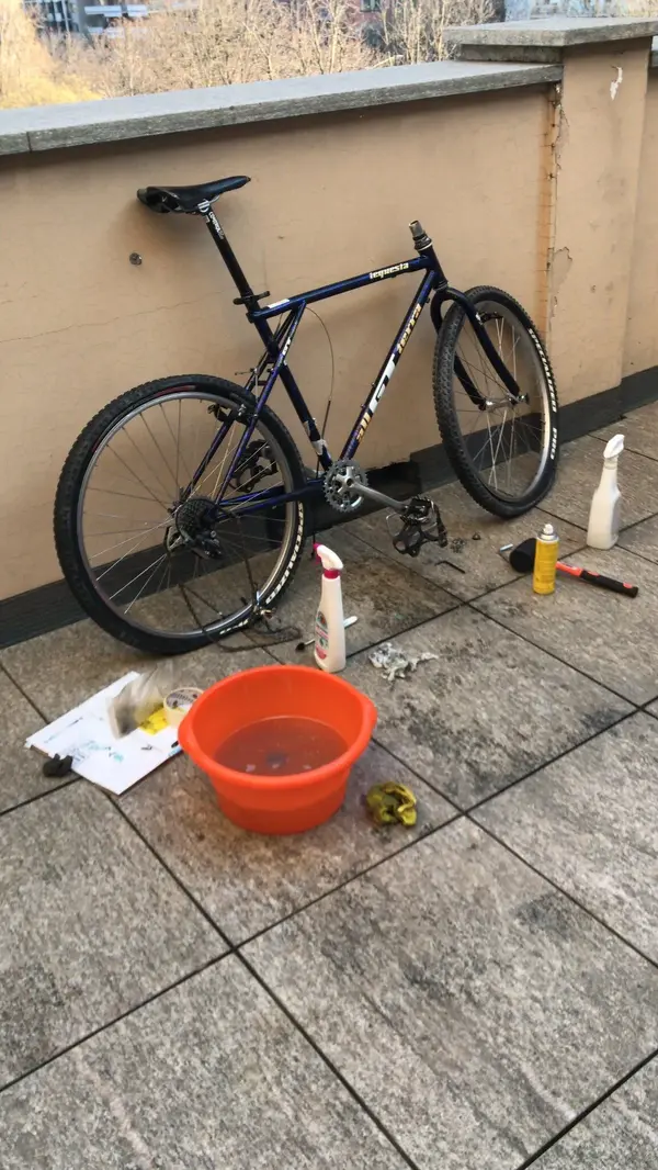

Heres how it was during a quick wipe down

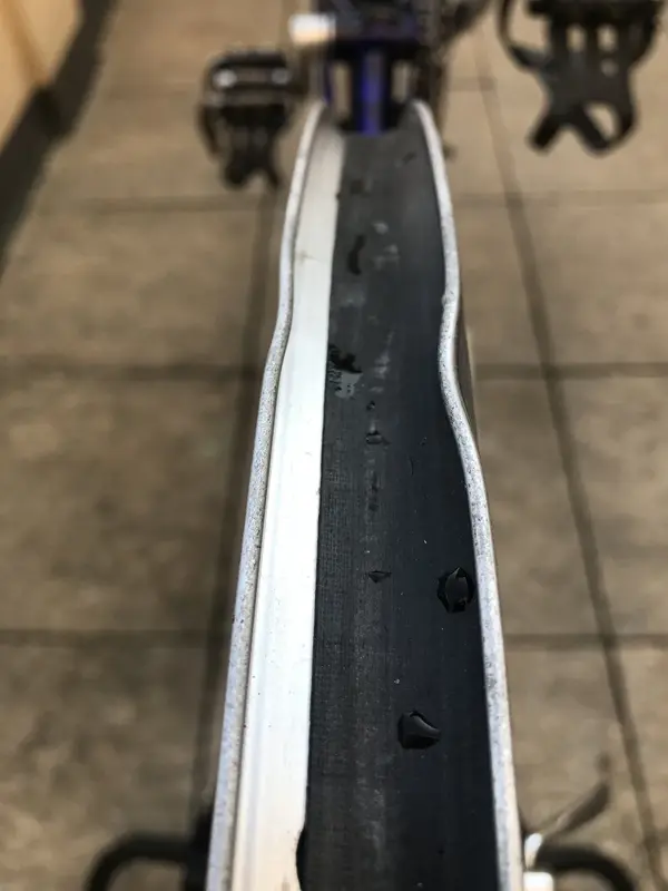

The wheels really didn’t take kindly to some of the downhill sections in the alps!
There were multiple dents like this all over both wheels but incredibly, no cracks.

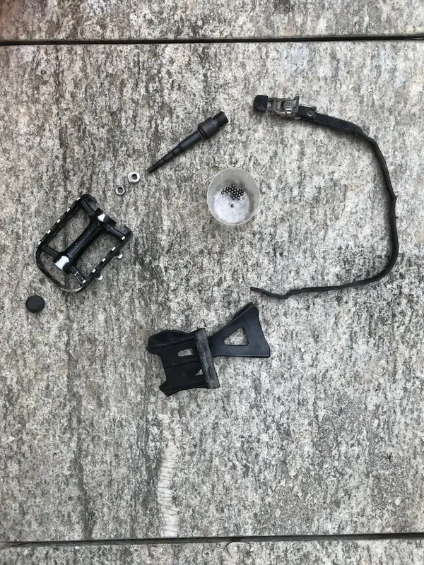

Pedals stripped down and regreased. One isn‘t quite perfect but it’s hugely improved.

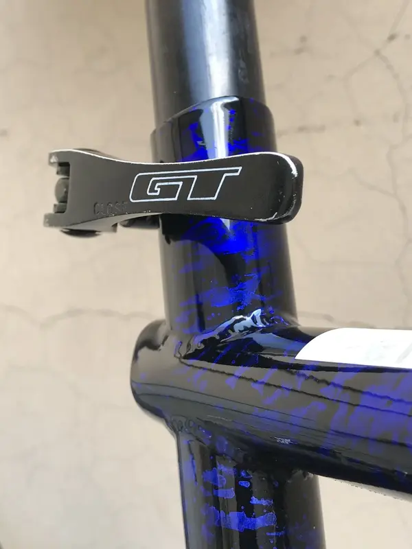

And some of the details

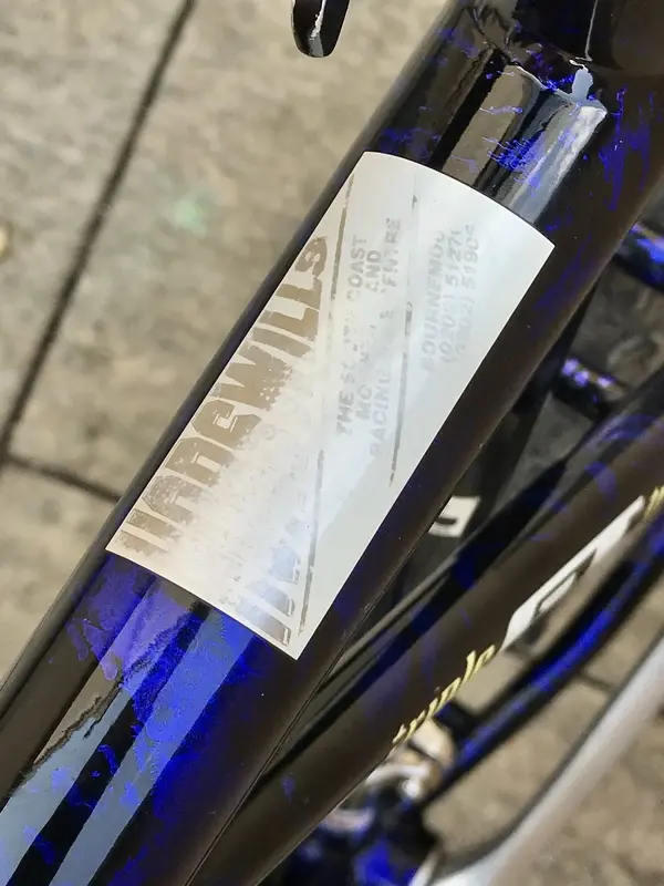

The original bike shop sticker from 1994. A bit faded but a nice little reminder. Sadly they closed some years ago but I loved going there to see all the Klein’s, proflex and top end parts.

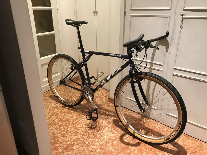

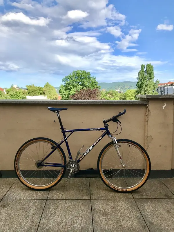

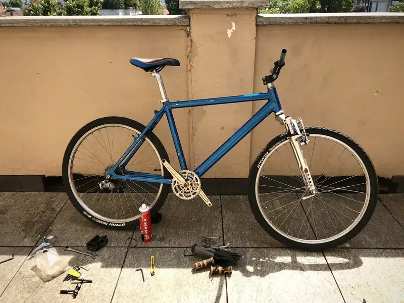

And here it is all reassembled and partially refreshed. The plan is to fix it up as I come across the right parts and where possible, improve on it.
The rims have been straightened reasonably well but the front axle cone is scrap so that’ll need sorting.
Shifters have been stripped and cleaned and are now functioning well but the gears still skip so a new chain and cassette are on the list as well as a thorough strip and clean of the freehub to see if it helps.
It desperately needs some skinwall tyres but I refuse to pay stupid money for perished old things that can’t be used. I also need to sort the bar height out as I’m not as flexible as I used to be!

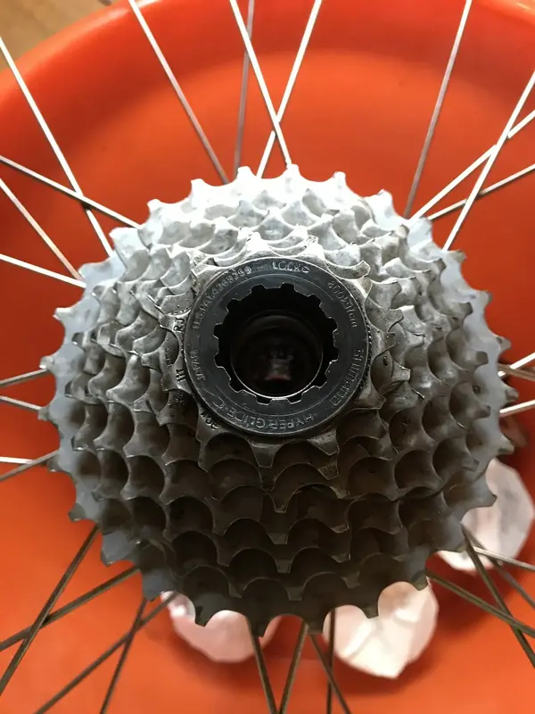

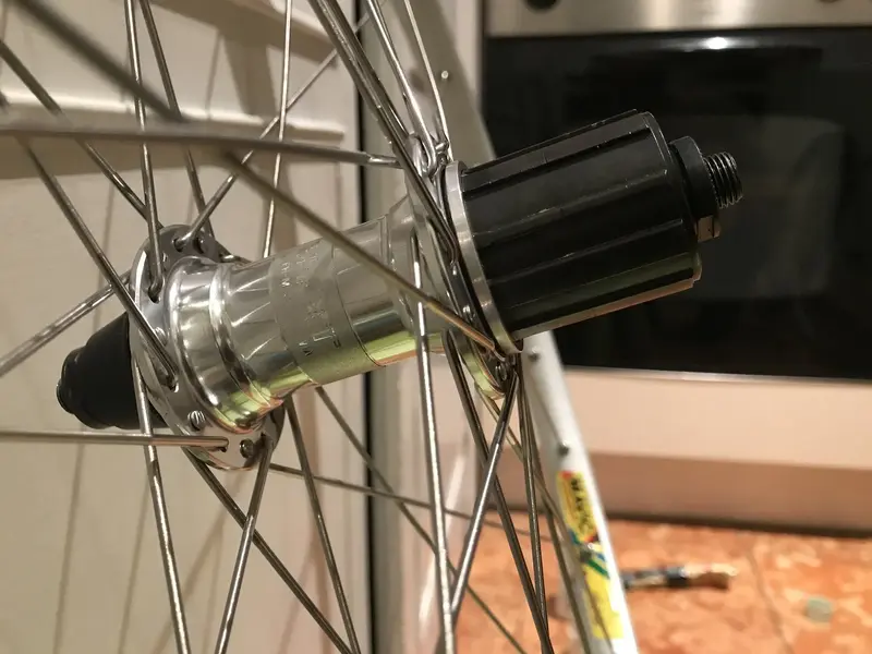

Next up, freehub. After reading up on the skipping gears it seemed likely that a sticky freehub could be the culprit. A trip to the bike shop saw me return with a chain whip and cassette tool. I wasn’t able to remove the internals from the FH but I flushed it through and through until it was clean. Some lube was liberally applied until the action softened and I was happy that it wasn’t dry! 😮
A useless picture but it breaks up the essay.

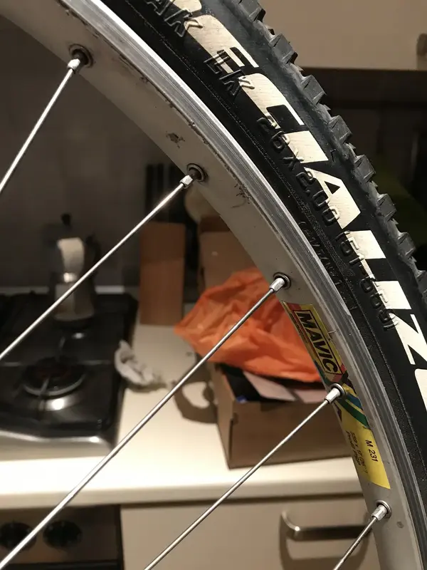

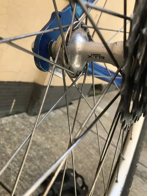

A day or so later, whilst idly checking Facebook marketplace, I stumbled on some newly listed wheels with XT hubs and Mavic rims. A frantic message or two later they were sat in the house.
They weren’t perfect and had plenty of what I assumed to be ground in brake pad around the rims. However, the bearings and freehub were like new compared to my STX originals and over all they were pretty tidy.
Chuffed that my childhood dream of 231 rims had been accomplished, I went and spent ages cleaning them up. Brake cleaner, Autosol and some layers of skin later and they were looking presentable.
Under the grime were what appeared to be some double butted spokes and the M738 ‘gold label’ front hub. Some subtle bling for an entry level bike!

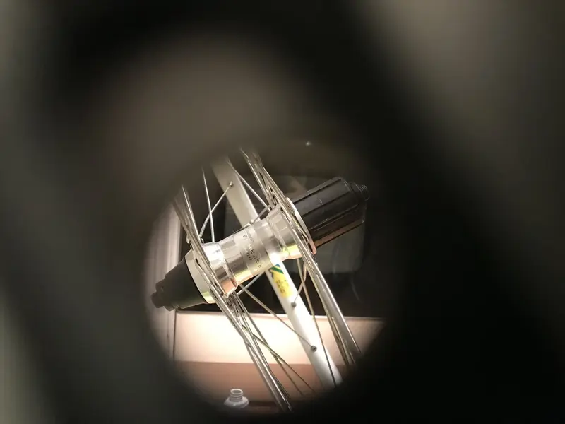

Obligatory through the valve hole shot.

The next part was a bit of a mixed bag. The parts all arrived without issue so I set about putting them on. The new cassette was noticeably lighter than the original which was a nice surprise but as the freehub was for an 8 speed cassette I will need to use a spacer. I’ve taken the one off the old wheels but it’s not the 4-5mm size that is recommended so I’m not sure that the lockring isn’t bottoming out on the hub before properly clamping the last cog. No biggie and an easy fix for the future.
Despite being a modern day, cheap part the drilling is a nice touch and reminiscent of better groupsets from the 90’s.

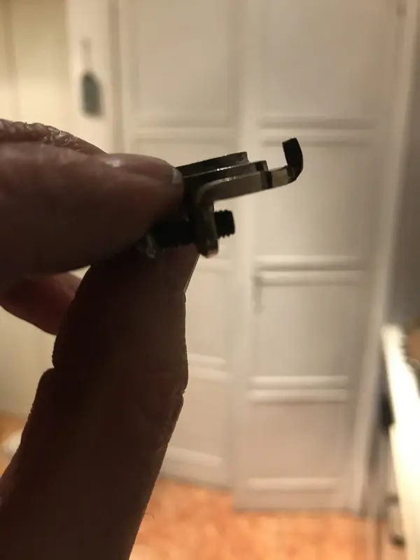

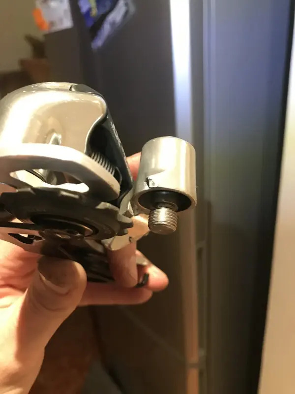

The rear mech was an XT M739 from eBay and looked to be in good shape. It was described as working and after a clean things looked good. However, what I hadn’t noticed in the listing was some damage to the protrusion that allows the main spring it’s tension.
There is a bit of a lip left but it’s minimal. I am also completely unable to wind the spring round enough as I need three hands to do it. I think a vice might be on the shopping list as I see no other way.
This really annoyed me but with nothing to lose I figured that if I could fold over the part that locates and holds the spring perhaps it would be good enough.
No idea what it’s called or if it will work but what the hell. I haven’t finished this tweak/bodge yet so if anyone has any ideas then I’m all ears. I will buy another mech if needs be but I’d rather not give in without a fight!

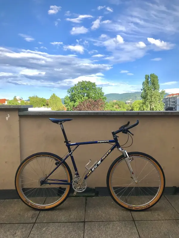

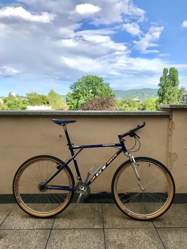

After the frustrations with the mech, I put on the new tyres. I decided to go for some Schwalbe Billy Bonkers as they were light, cheap and fitted well with the plan.
It was a drastic transformation and I couldn’t be happier with them-photos (and the poorly lit, old kitchen background) don’t do them or the look, justice. I’m sure the purity police will take issue with them for the big writing and lack of ‘knobblyness’ but I can live with that!

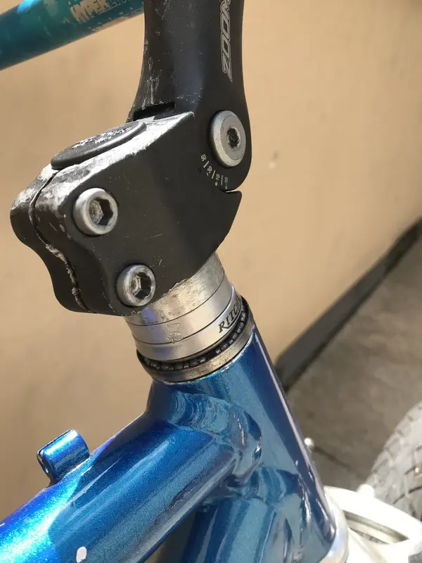

I’ve bought a slightly shorter stem to try and reduce the stretch on my old back and I’ve started to polish the crank arms for a bit more sparkle. Still got loads to do but it’s on the right path I think.

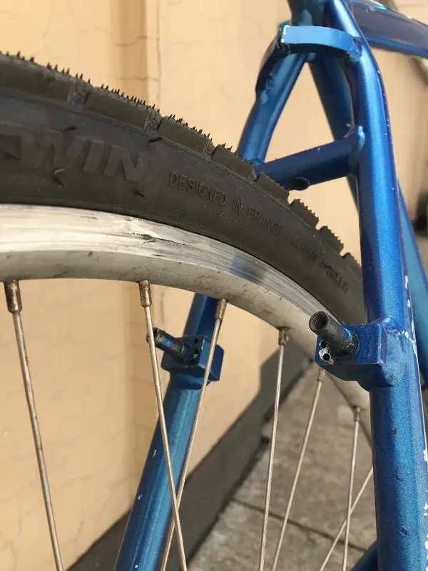

A split rim-shame as its a Ritchey OCR

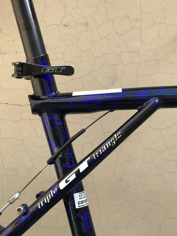

Apparently this is just a paint defect! 🤔

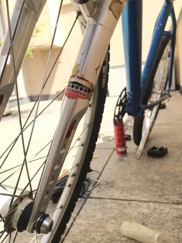

The forks are Knackered-In keeping with the general state of the bike. Unfortunately the previous owner had decided to drill and bolt through the legs and stanchions as a ghetto lockout solution 😅😢 The brace and steerer are in decent condition so at least that.

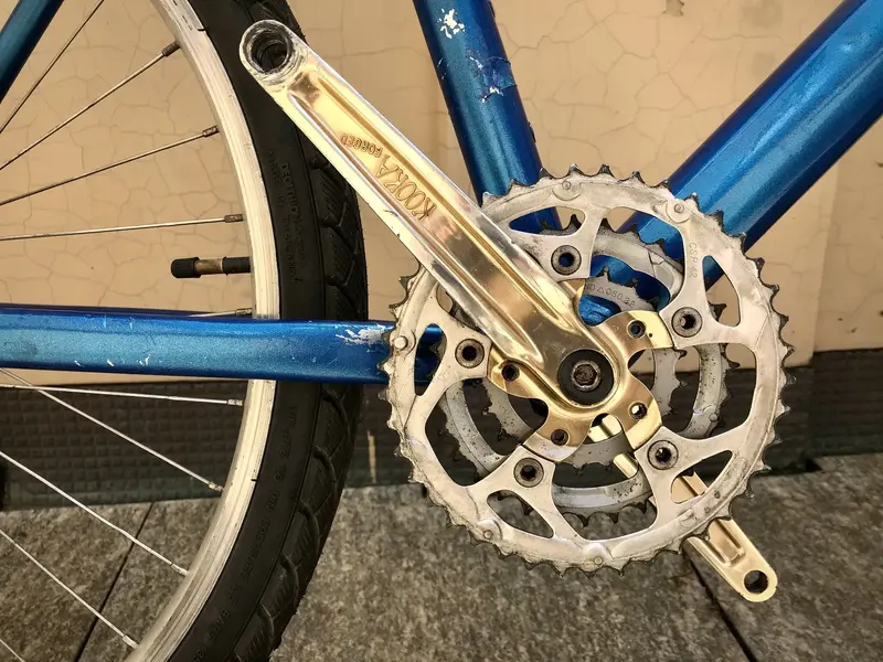

I don’t know a great deal about these if I’m honest and I’m not sure what I’ll do with them. I’ve cleaned them up so I will try them on the GT and see what I think. The middle chainring is very worn and the outer isn’t perfect.

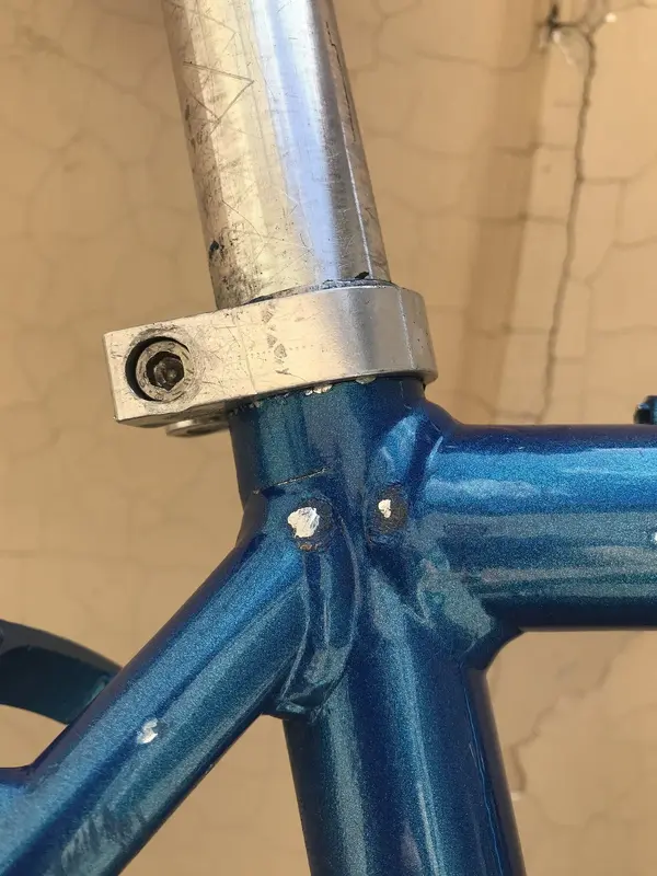

Beyond that, I’ve started stripping and polishing the frame. My brief research has told me this is probably a ’92 Indian Fire Trail and as it’s 7000 series, welding might be an option for the seat tube. If not then I’ll fiddle about with it and maybe turn it in to some garage ’art’ but as you can probably imagine, it needs some work!

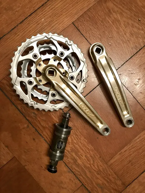

Getting back to the GT, I decided to test fit the cranks and forks to see if they looked any good.
If I do stick with the Kookas then they’ll need a couple of chainrings-the inner is fine but the middle is toast and the outer has seen better days.
The UN51 BB is ‘ok’ but not perfect. Won’t fit the GT so I’ll pass it on.
STX cranks and rings^
Kookas below
Surprisingly, I wasn’t blown away by the look. I’d expected to be so impressed that I’d be immediately on the hunt for some fresher Marzocchis. The forks seemed to detract from what made it ‘my old bike’ so I doubt the GT will see suspension in the future-never say never though!
With the cranks I’m undecided. I much prefer the original chromed chainrings and whilst the crank arms are nice enough, I feel the polished originals are a slightly better fit with the bike. If the kookas were mint then it might be a different story-perhaps I’ll strip and polish them?
